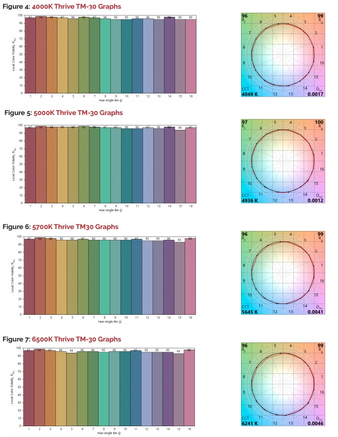

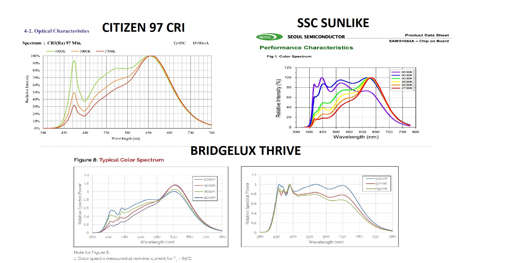

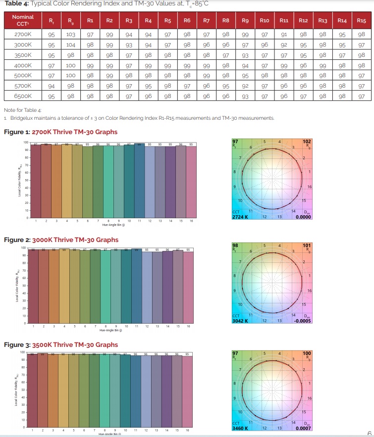

I think in about two weeks I will be offering LED sources (E27,E14,GU10 5-9W) based on Bridgelux THRIVE.
The light they emit seems very pleasant :+1: Below is a basic comparison of the spectrum emission compared to Citizen 97 CRI and Sunlike LEDs:

BTW, I notice that the Citizen chart mentions CRI97min. But I only see CRI97typ on their website. What do I miss?

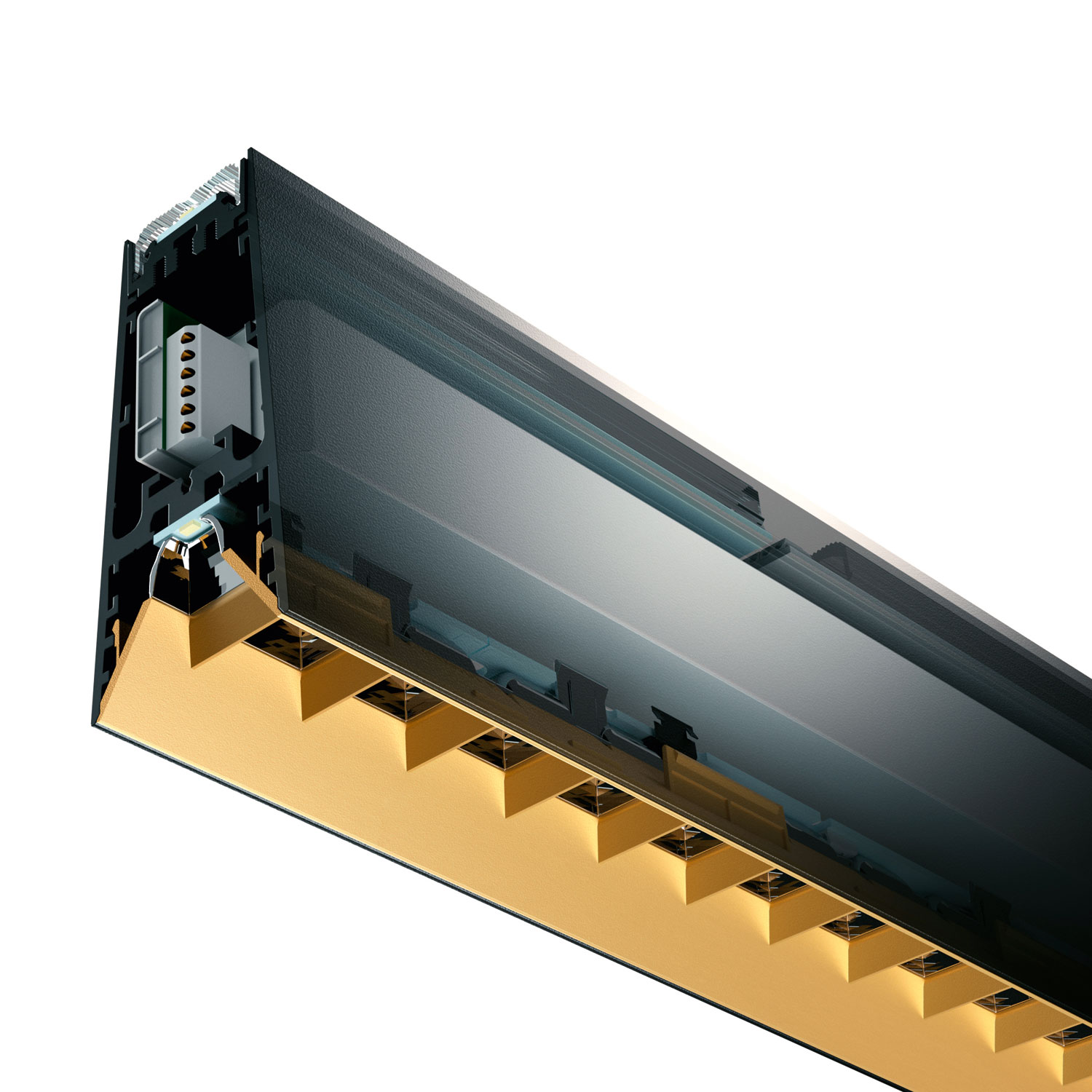

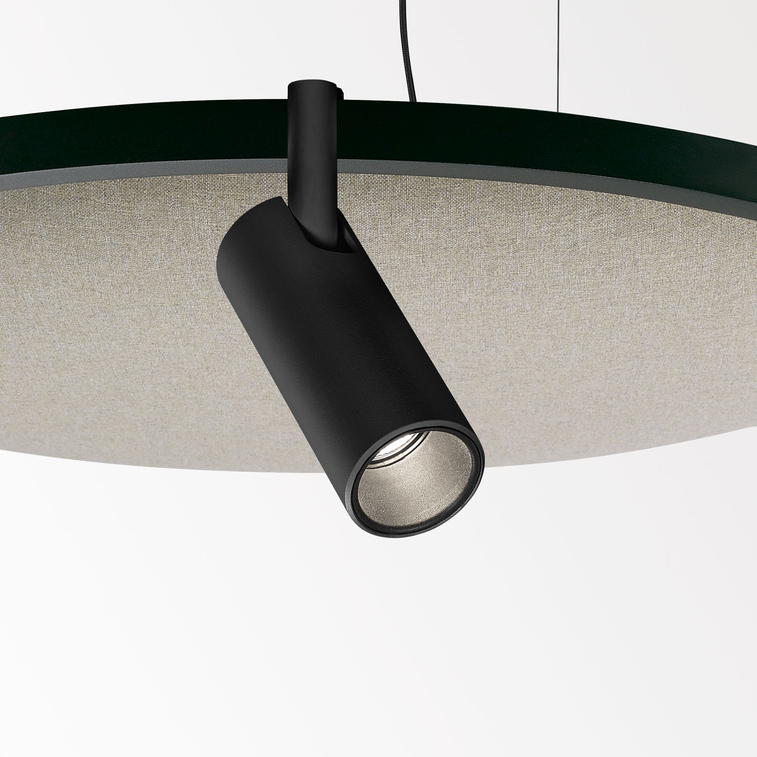

Some interesting findings from Delta Light, Belgium. The cons is that they are very expensive.
Soli 52 claiming CRI > 98
CONFORM P28 PDS DOWN-UP 954067 B-B - Delta Light claiming CRI > 95
https://www.deltalight.com/en/products/detail/imax-ii-round-adjustable-mp-93039-24211-9330 claiming CRI > 90
