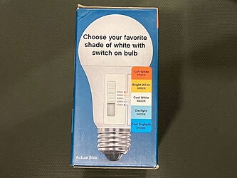

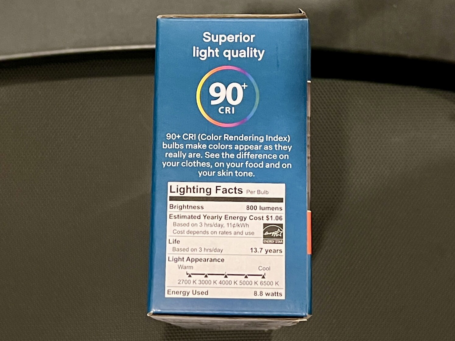

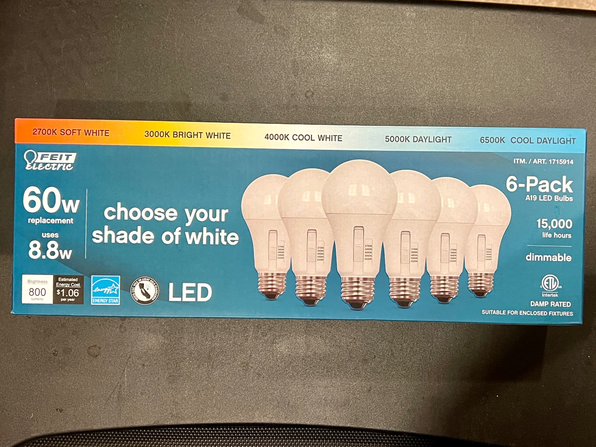

I bought a 6 pack of these switchable CCT LEDs from Costco a couple weeks ago for $10 for a bathroom light fixture.
I was having problems with the previous LEDs flickering with the dimmer switch. It’s a regular, non-LED specific, dimmer. So I put some 60W incandescent bulbs back in, but didn’t like the energy they were using.
So I tried these bulbs. Surprisingly they dim just as well as the incandescents and no flickering at all. I thought the switchable CCT was a gimmick at first, but it works very well. Usually I prefer 2700K throughout the house, but after a while I preferred 3000K.
I found it interesting that the plastic bulbs are so thin and pliable that they can press in while installing, but fortunately they bounce right back into shape.

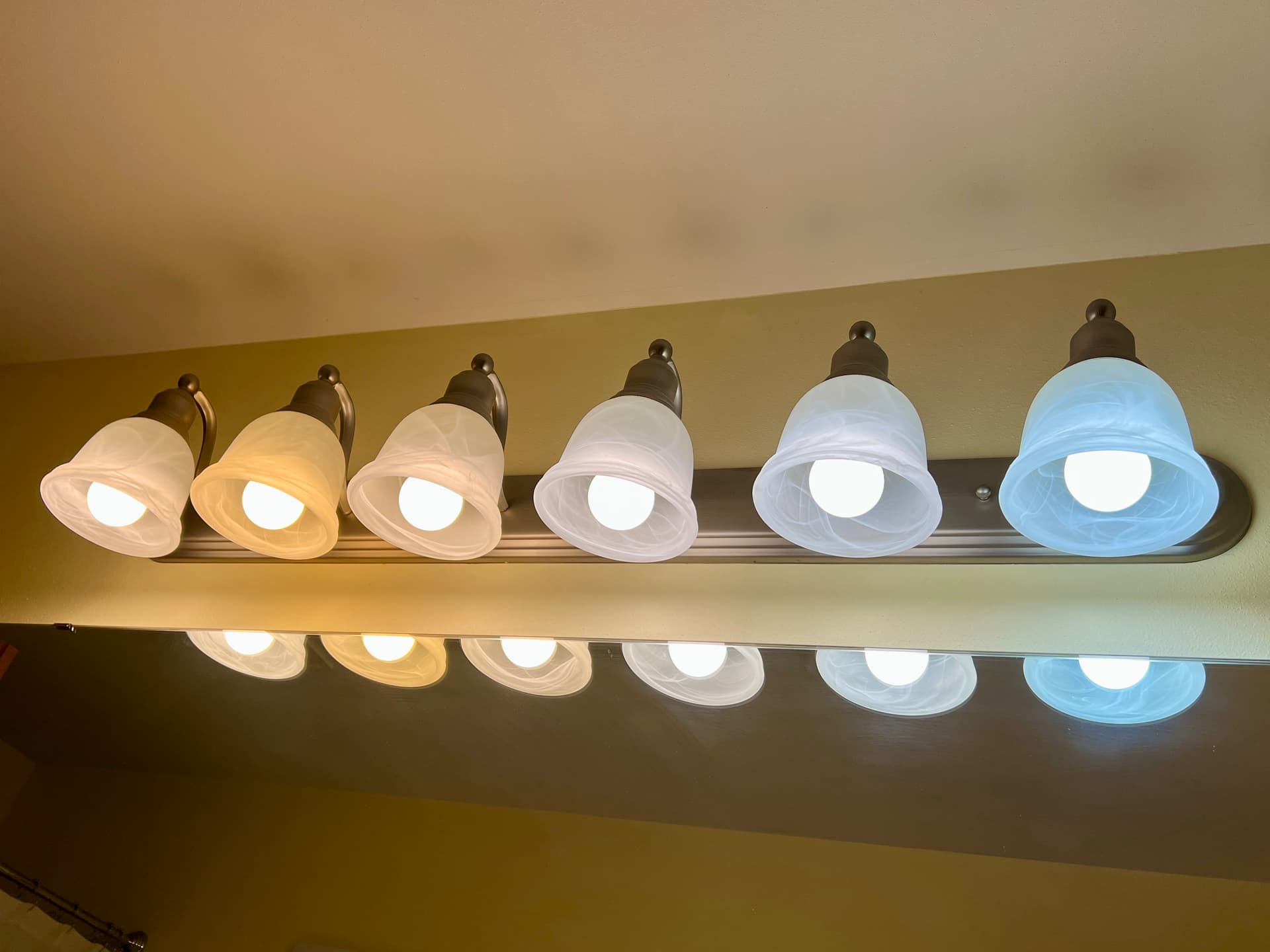

Right to left are the 5 different CCT settings with the very left again being the 3000K that I prefer.
I’ve gotten the same bulbs a few months ago, and didn’t find the plastic pliable. Maybe they somehow made a new design.
The 3000K setting is definitely cooler than 3000K, and the middle 3 CCTs are all very rosy.
The color rendering is not uniform across the CCTs, with 2700K being the worst and 6500K being the best. Whatever emitter they used for the 6500K, there is no blue spike or cyan dip, while the 2700K is noticeably lacking in deep red and has a very spiky spectrum in the orange-red region.
Agreed that they appear cooler than advertised. Here’s another pic with the very left now with an incandescent bulb that should be around 2700K. I should’ve done that initially.
