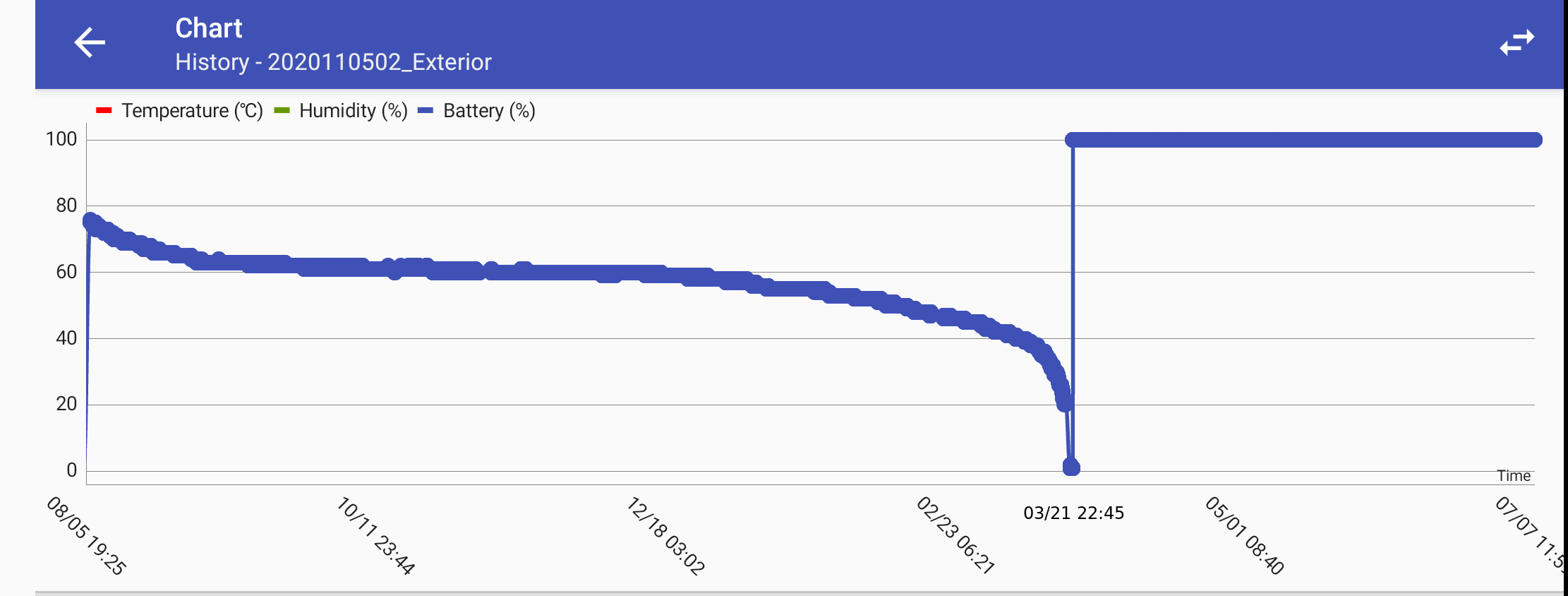

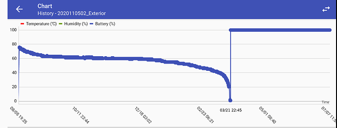

I use one of these as an external thermometer, inside a Ziploc as I’m not sure how water-resistant it is, and with a fully-charged AAA Eneloop it starts showing 60% battery and lasts about 6 months before turning off. Recently I replaced it with an AAA Ultimate Lithium and it started at 100%, and after 6 months it’s still at 100%, so I’m thinking it will probably outlast the thermometer itself :slight_smile:
EDIT: I just checked and the AAA Eneloop actually lasted about 7.5 months to go from a starting 80% (as shown by the thermometer battery sensor) to zero, while the Ultimate Lithium has been about 3.5 months at its starting 100%:
I’m really impressed with the Ultimate for this use case and I expect it to last at least double the Eneloop – which would be great as swapping batteries for this thermometer is a PITA due to its location.
