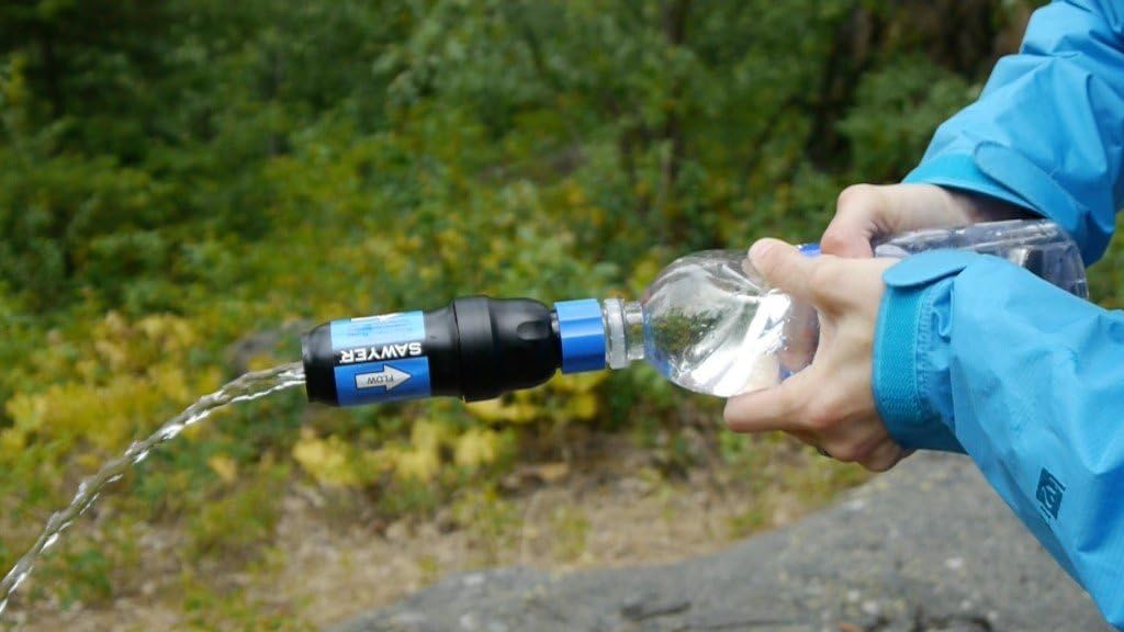

You can leave the syringe and bring the more robust coupler to use your bottle to backflush. It can stay on the filter so low chance of losing a separate piece. Lighter than the syringe too.
Yeah, the Sawyer brand bags are well-known to be garbage. Platypus bladders USED to use the standard 28mm threading, but the jerks changed to proprietary threading. CNOC bladders have standard 28mm threading and have a very good reputation, as does Evernew. You can also use many waterbottles with standard 28mm threading.
I did not know the Guardian will tolerate freezing (In fact I was assuming it would also fail). That is excellent. The size of that thing would be really annoying to have to keep with you in your sleeping bag to avoid freezing, lol! You can blow test the Sawyer if you suspect it has been compromised, but yeah there’s frequently no outward sign (occasionally the case may crack).
