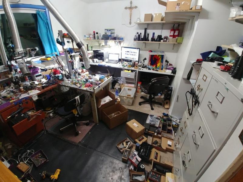

A picture of my lab just for kicks :wink:
