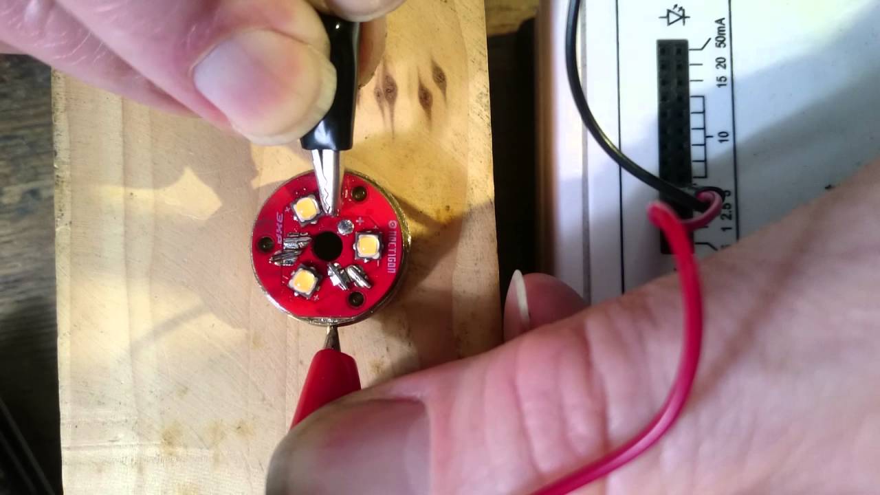

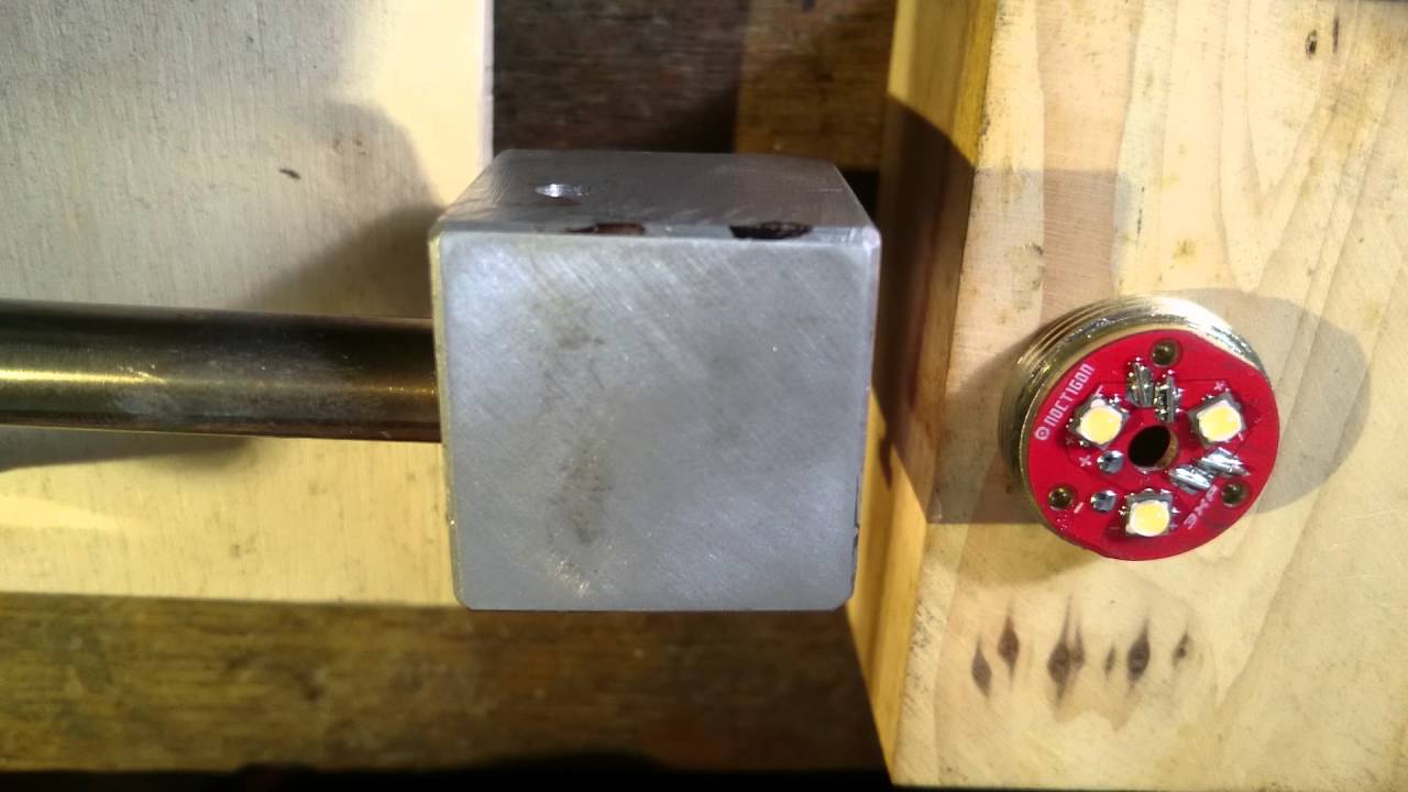

Then everything was reflowed on my heatblock: pill->copper disk->ledboard->leds. I chose Nichia 219C warm white (3000K) for this mod: nice low Vf and good output even at 3000K. I made a video of the reflow to show-off my reflow skills
, but unfortunately I had a more shaky day than usual, and further, despite several times soldering and unsoldering stuff, I got no light when testing, sofar for my skills
But after some more fiddling and failures outside the camera, I found that I had rotated one led 90degrees wrong
. It finally worked, and that is what counts
