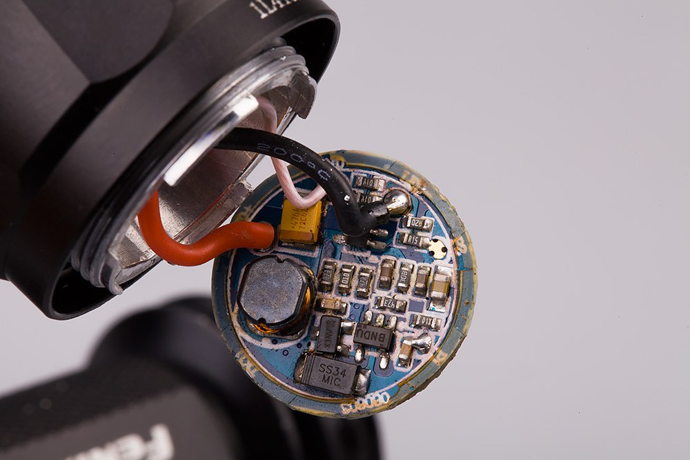

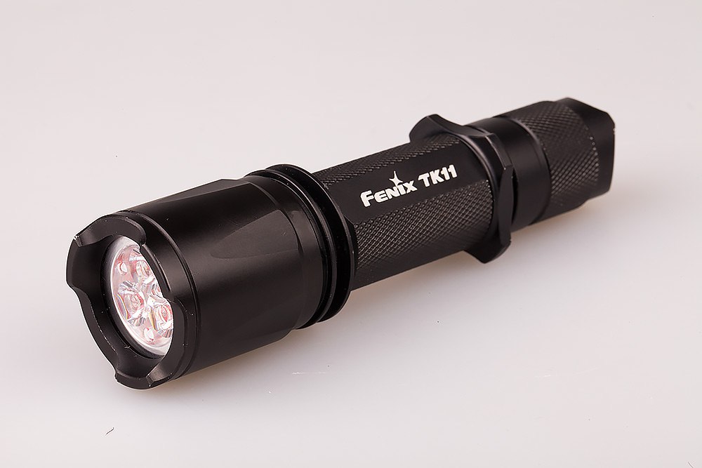

My Fenix TK11-x mod: 10507 carclo, Nichia219C with noctigon thermalpad and forced original driver (up to 800lm)
Nice mod, Hemionline! Looks very robust and balanced, with good output/runtimes.

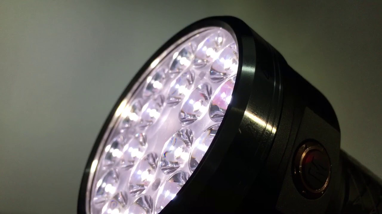

18x219C、XHP70.2、XPL Hi (L2)
