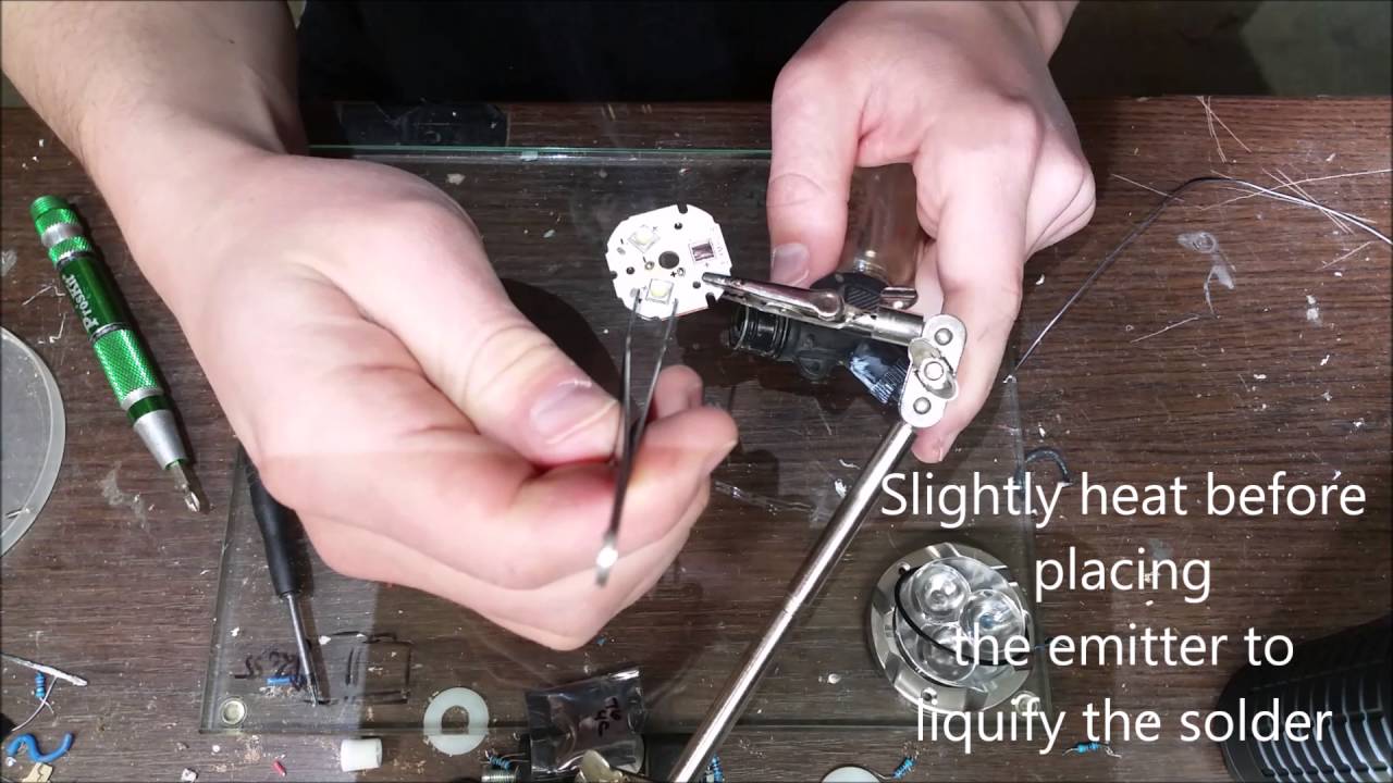

Spent a solid day doing some small stuff with the bulk focused on a D01 mod. Reinforced positive contact ring, bypassed springs and traces, mounted a FET driver onto the stock driver, sanded the copper heatsink and the maxtoch mcpcb to 1500. All that is left is to solder the leads to the mcpcb and the switch wires to the driver.
Speaking of switch wires… Is there a particular orientation to connect them to the sides of the OTC on the FET driver or does it not matter?
Great video, X3, I enjoyed that very much!
You could do with a simple led-tester, saves you some time :wink: I use this one, it even works with 3 leds in series because it is powered by a 9V alkaline. It comes with small alligator clips that are very handy, I just swapped the momentary switch for a small clicky switch to be able to use both hands.
Thank you for the kind word, I saw the tester in one of your videos and it seems prctical.
I was too confident in my skills so I waste some time but eh, that’s how you learn things !
The second time I checked them with my DMM, one by one and everything was ok.
I guess one solder joint was not good because orientation were the same before/after…
