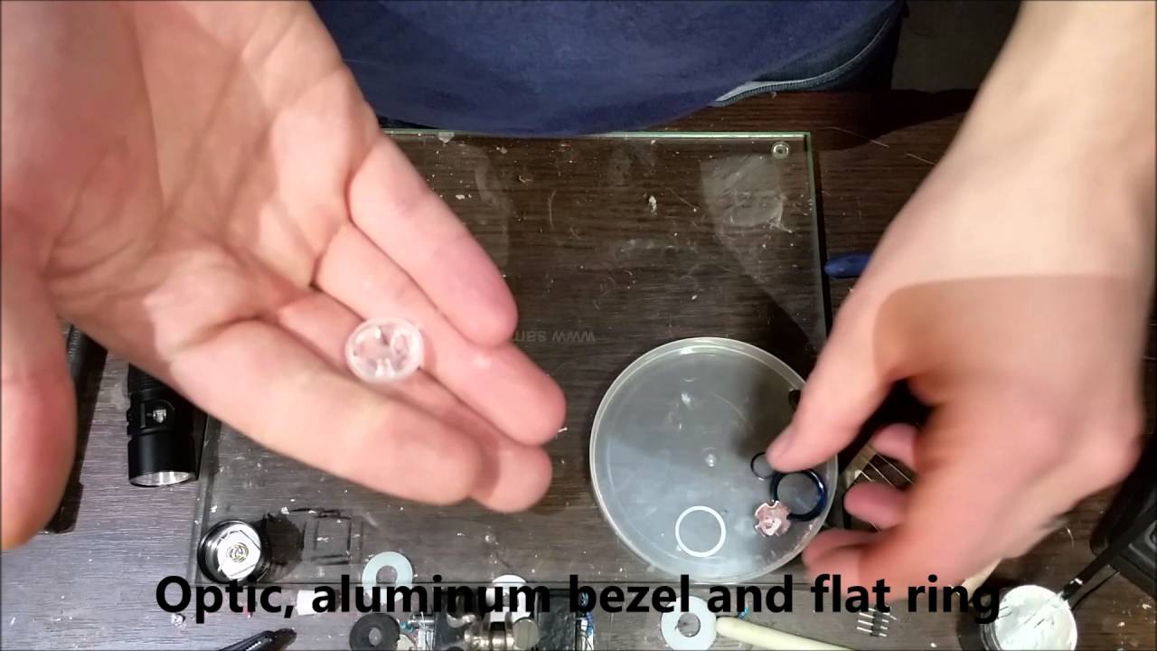

This
https://www.youtube.com/watch?v=Oel5XOvrWEA&feature=youtu.be
Here is the original thread but it doesn’t seem to interest many people ?
I’m always surprised at how few people respond to (what I think is) a nice post, but mind that there are many more readers than responders, and few responses does not mean that it is not appreciated.
Nice disassembly video! I never got the switch cover out of my Baton lights, and now I know how. ![]()

It was quite the buzz on r/flashlight but not so here, I was a little surprised.
Anyway, now everyone know how to swap an Olight S2 emitter, which is really new.
I spent some time to find the way to do it on Internet and nobody has ever showed how to do it yet.
I’ll make another better quality video when I’ll swap my clean S2, but I was too proud of myself to wait :-p
Of course, I could have kept it secret and charge anyone who wanted me to swap emitter on my bench
but it’s not CPF lol
I’ll make another better quality video when I’ll swap my clean S2, but I was too proud of myself to wait :-pOf course, I could have kept it secret and charge anyone who wanted me to swap emitter on my bench
