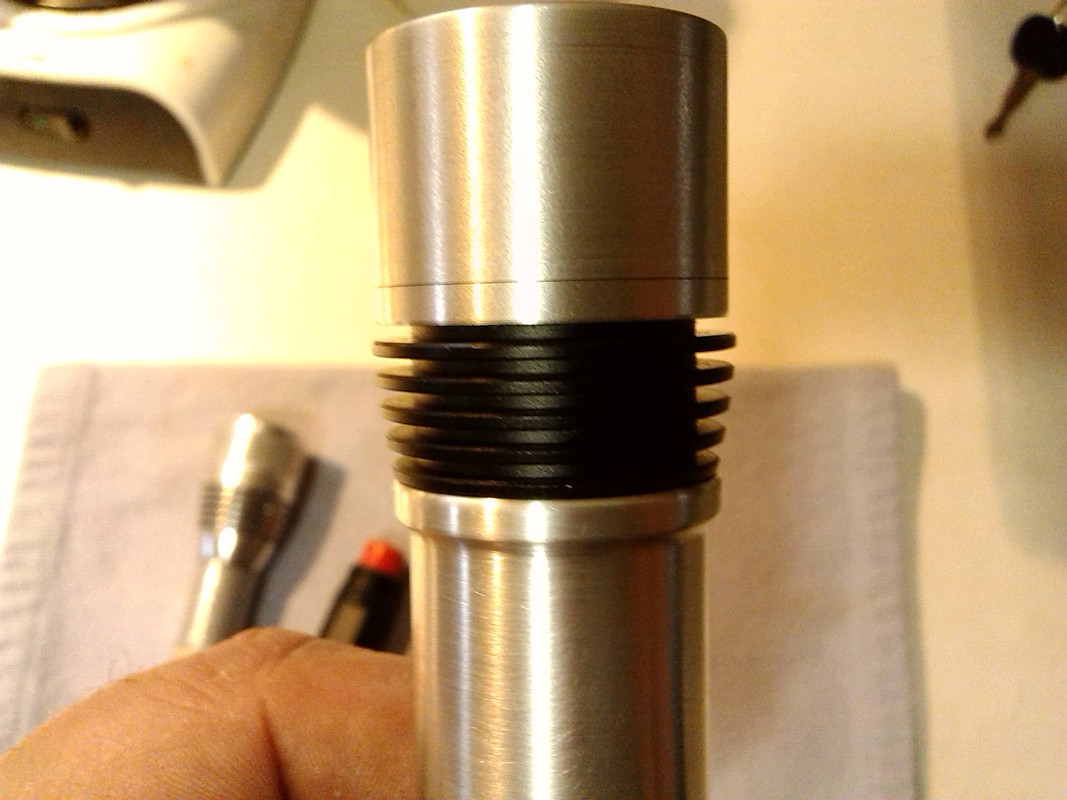

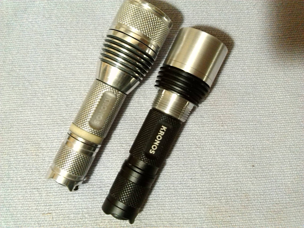

Machined/Modified the Copper (press fit pill) Quad 4xXP-L HI V3 5000k of a KRONOS X5 to do double duty…
With a 18650 tube running a VTC5A it makes 3890lms

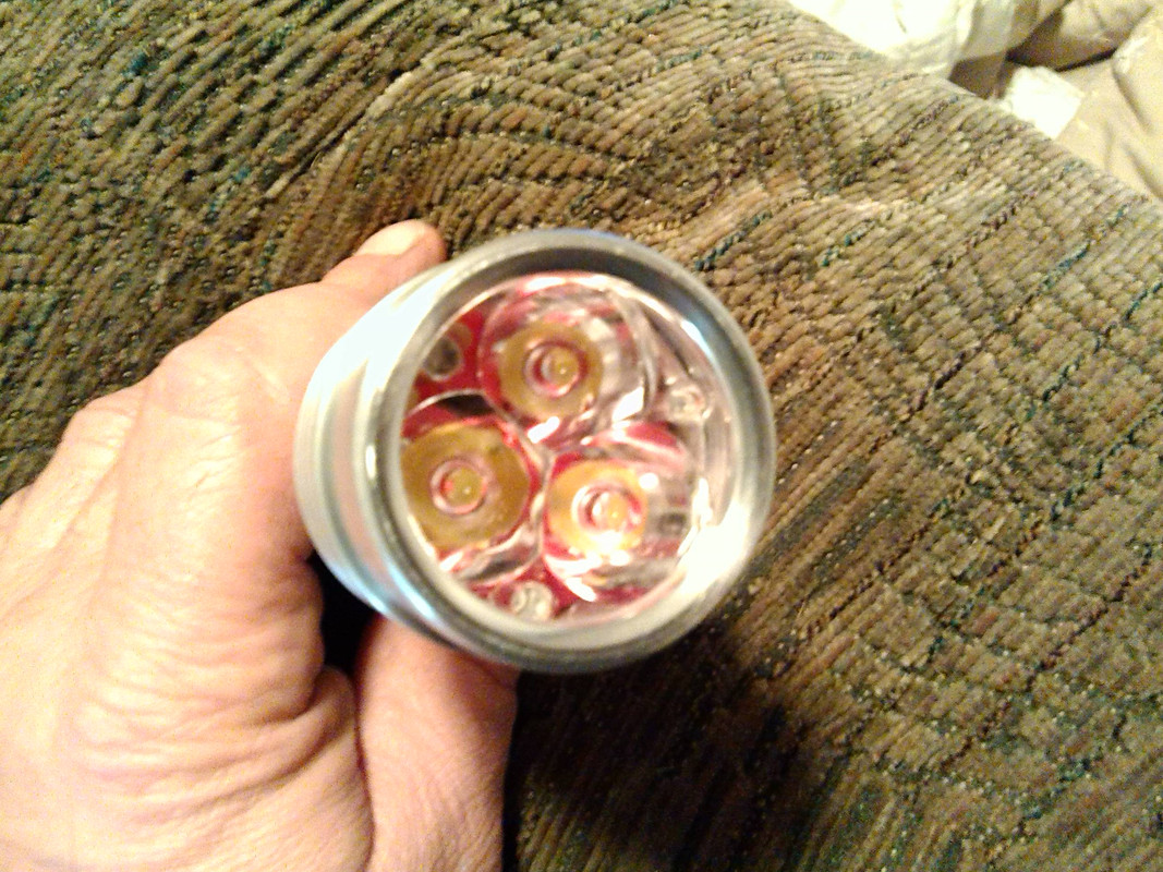

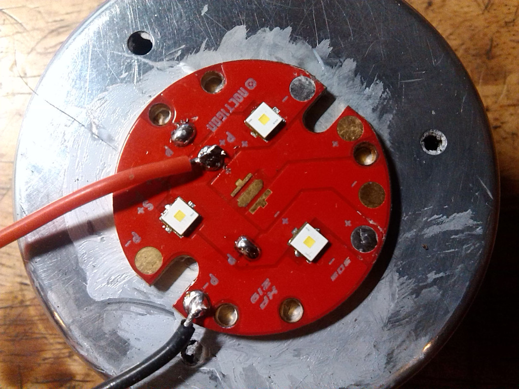

KW CSLNM1.TG Triple…
The head I made out of 2 different scrap pieces of Aluminum… 15amps/2240lm
