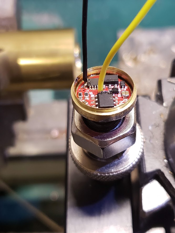

Pulled the driver from my Brass Pineapple. Installed a 15mm Lexel FET+4+1.
The original is 14,5mm, so the pill has had a little dremel surgery.
So now it has way more features and power.
I lost the AA-ability, and the ultra low moonlight level. But gained so much more. Huzzah

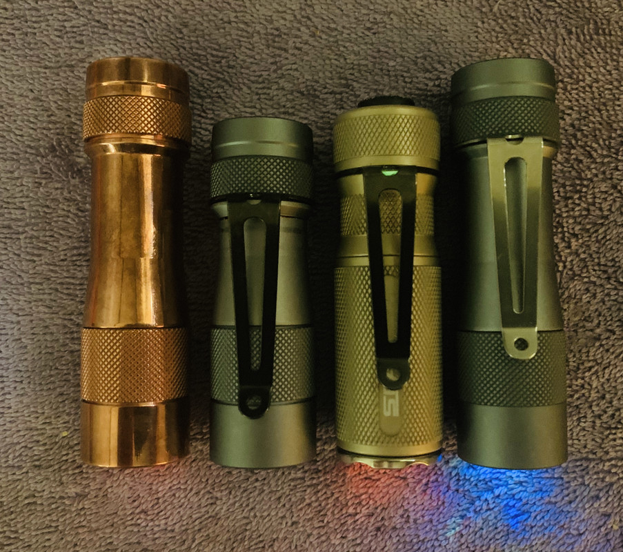

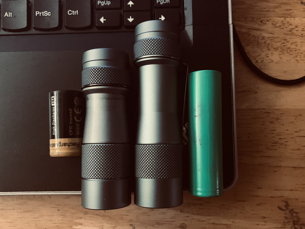

Honey… I shrunk my FW3A……
and I need to shrink it 1/4” more…

Yep a little bit… .003” interference shrink fit, the contact surfaces have to be perfectly round, so once the collar is heated up, it shrinks tight and leak free to the body diameter… no sleeve… no glue…
. I ordered (2) Ti/FW3’s so this is the proto-type…if Lumintop won’t make it… I will…

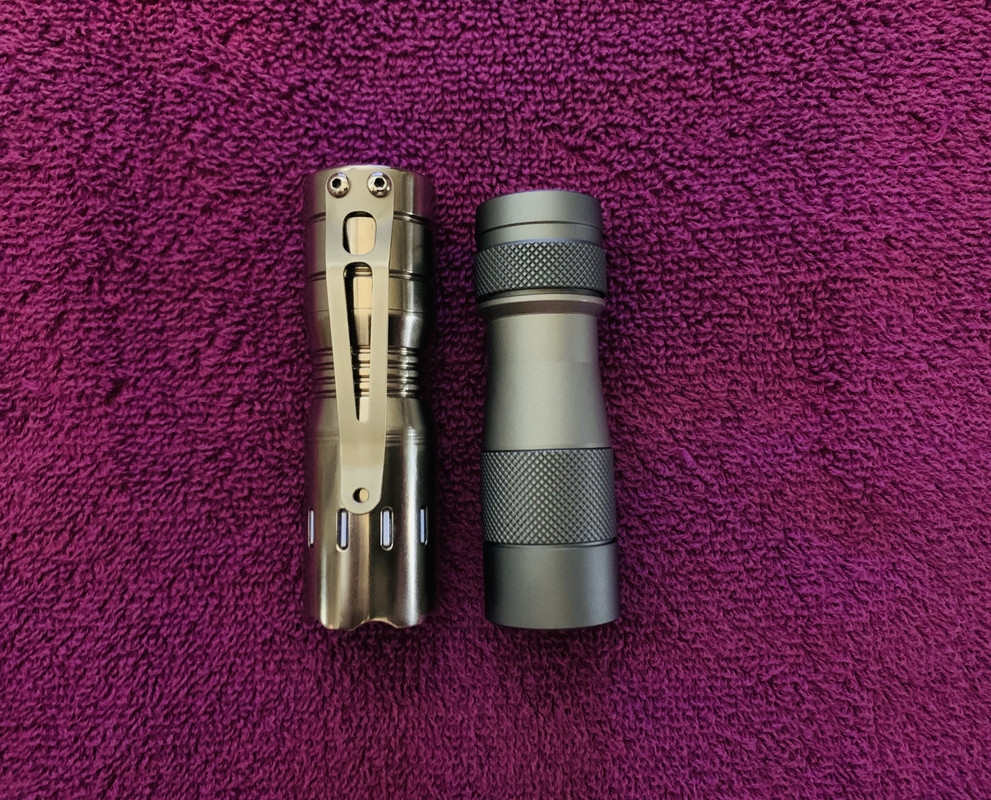

I thought the 18350 D4 looked odd, but the FW3A version looks much better!
![](https://budgetlightforum.com/user_avatar/budgetlightforum.com/kawiboy1428/48/1412_2.png)
[…]if Lumintop won’t make it… I will…
Will you sell them? :innocent:
(the shorty tubes!)
Thanks guy’s!
. It is actually shorter than the wife’s Sinner Ti now… it will be shorter yet…
. Here is a better shot of battery tube going into the tail cap collar…
. Looks Factory stock…hopefully the same way tomorrow?
