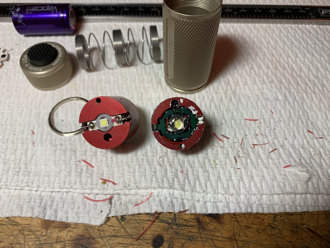

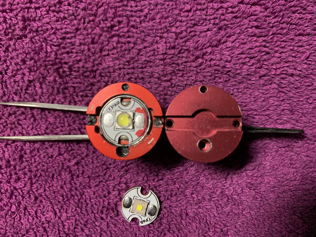

my latest mod cut the output in half, XP-L to 3000k 219b in a Thrunite T10t (in the middle).
pic is a link to teardown

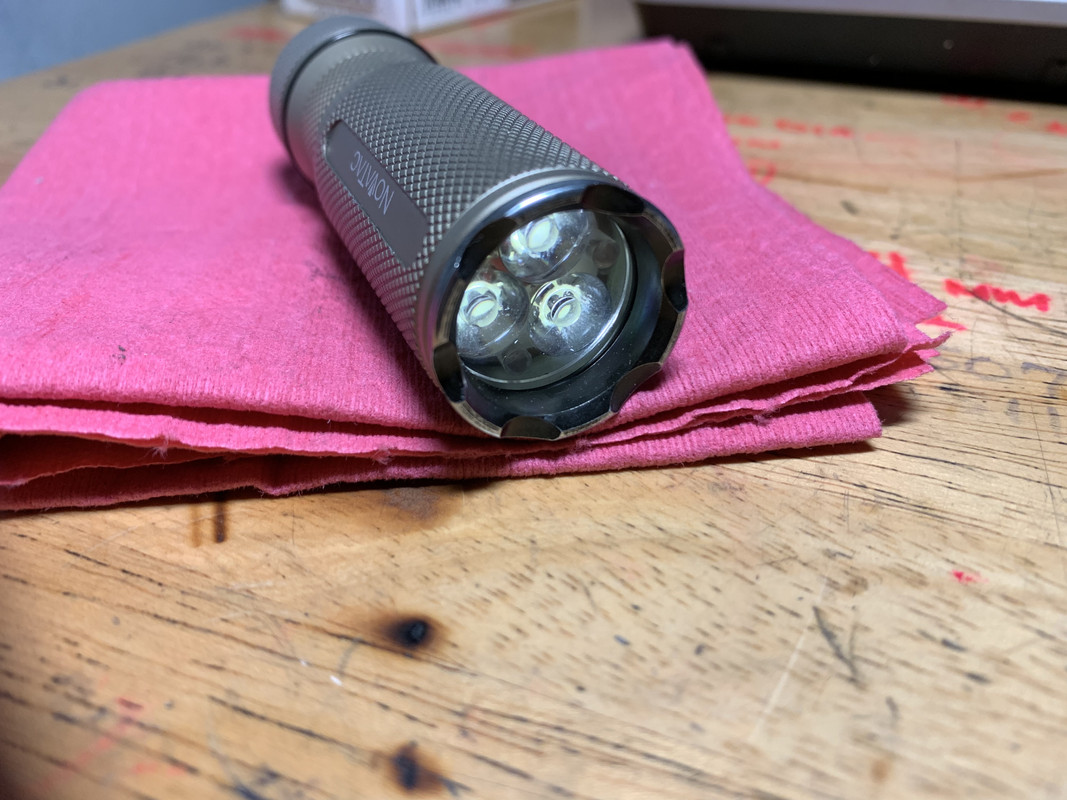

I have found they use 2 different drivers/pills….
This one/style will get you 500+ (580 tested) lumens
The other style just over 200lms using a 16340 or18350….I know the 250 click trick also…
. The stock LED is a real POS…

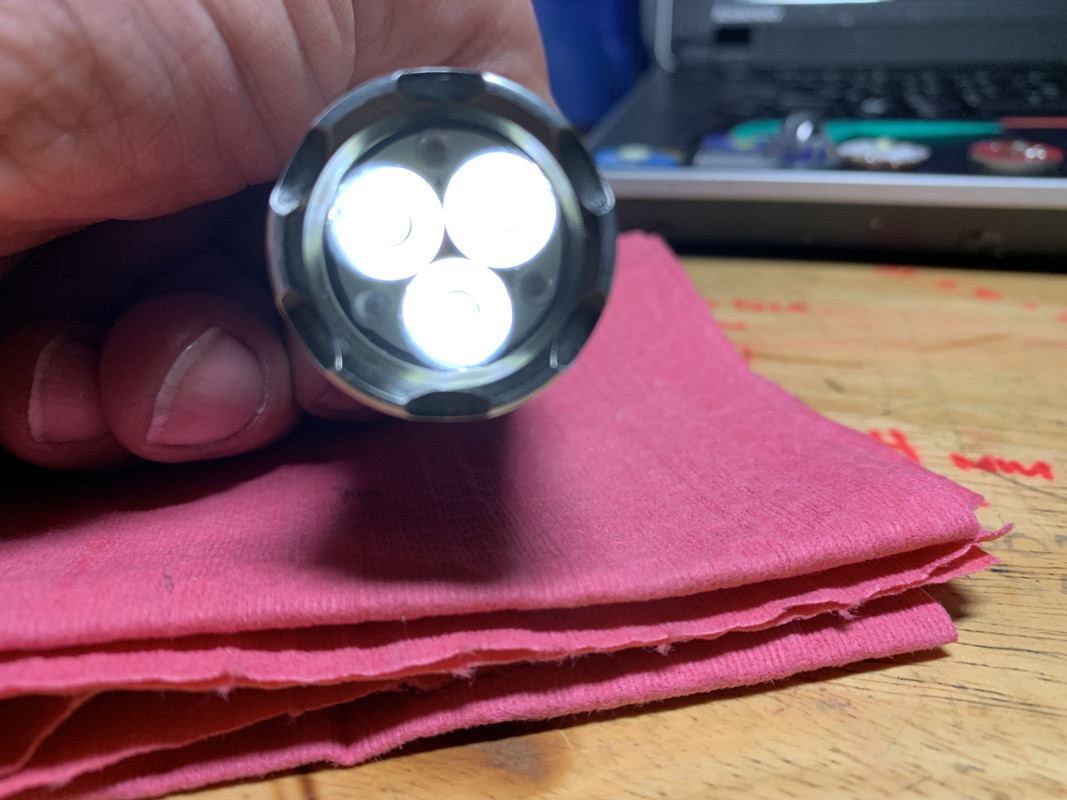

Yep these are Triple Candidates ….with a FW3 driver… :smiley:
