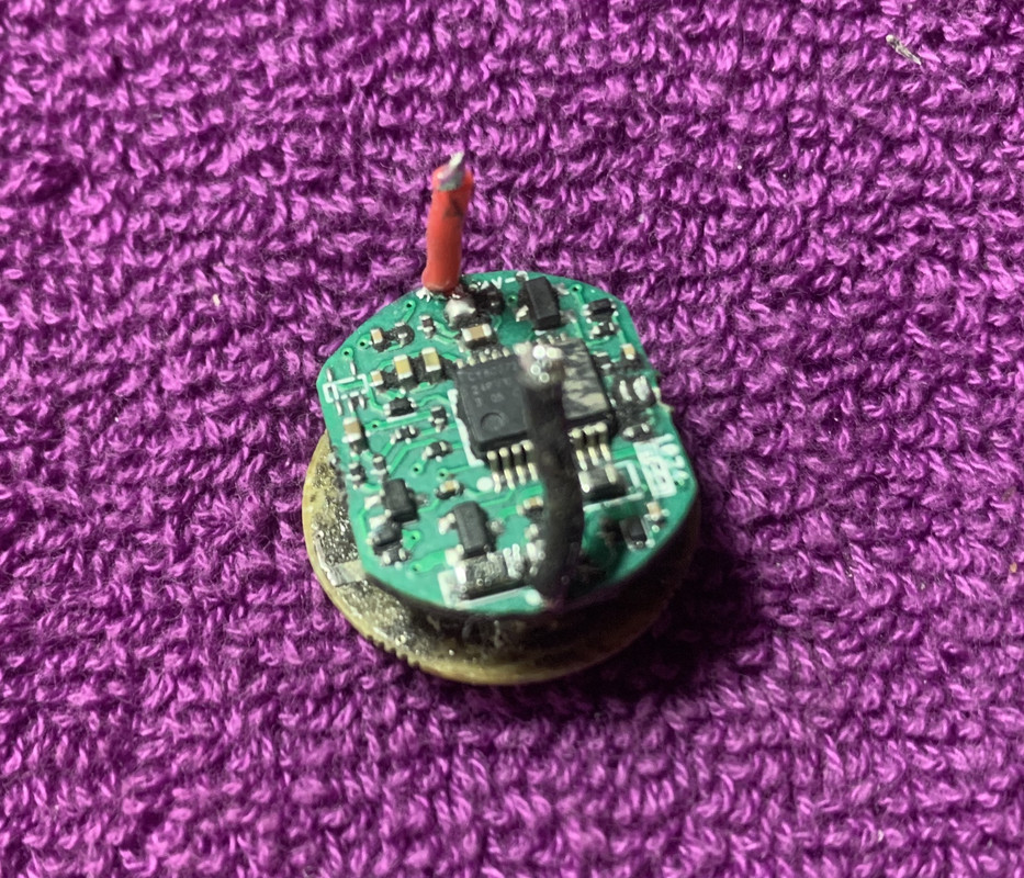

Been removing the good drivers and putting them into the round mcpcb pillsā¦
Resistor modded a few⦠of the others⦠just to play withā¦

Wow, how did you get the potting out?! These things are built like tanks
Itās a RTV silicone potting⦠I soak them in a very strong thinner. I take a small drill bit and by hand remove the silicone down to the driver contact board, the 2 holes opposite the lead holes are for filling/ venting the pill, remove the silicone from those 2 areas and soak in thinner. It takes time and patients but eventually the silicone breaks down enough to push the driver out. I used to hot air the spring contact board off, now I just soak them.

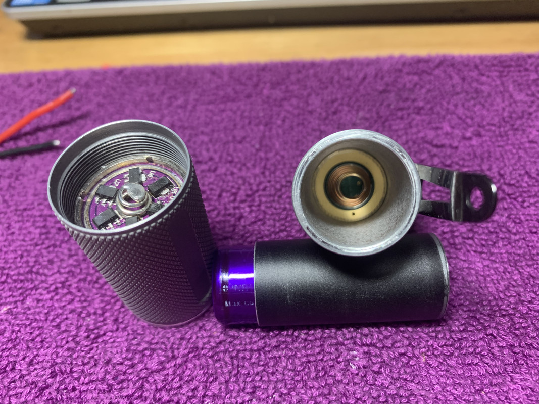

Iād really like to do a brass bar 18350 conversion next, just trying to plan out how to do it

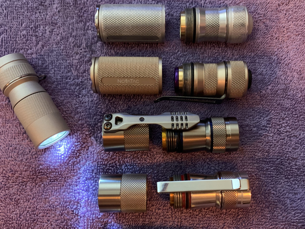

I made up some brass signal tubes for my FW3 shorty mods and machined the tubing smaller for the FW3/NovaTac mods. So I had 3-4 FW3 signal tubes left over. Now Iām out of brass tubing. But then I figured I would flap out the battery tube of the NovaTac which was about .005ā and then I cut down the FW3 tube to fit.
My Last FW3/NovaTac Triple using the FW3 driver and cut down signal tubeā¦and clipā¦
