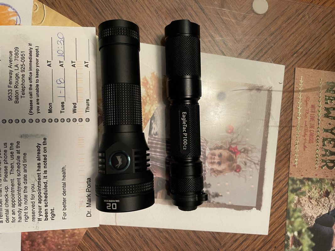

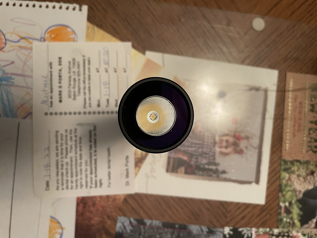

I did two pretty basic Mods today — I’ve been having this Eagtac P100C2 laying around — Go figure a S2+ pill and reflector worked perfectly — I used a 70 cri Nichia with a Crescendo driver — Nice little light — handles heat rather well — Finally found a light this driver works with
Playing around I tried to make something useful out of this D2 — I put a 4000k Nichia and used a OP S2 reflector — kind of off the wall , but at least it’s a usable light now
The original D2 reflector looked awful when I first got mine. I bet even with that smaller reflector it’s a much better beam profile.
Yep—- I tried the original reflector with the Nichia —it was better but no spill with a big light circumference — today while I was changing out the reflector on the other light — I tried it out — S2 reflector is a little deeper — not sure if the lens will take a drop like this — I would’ve been upset if I would of paid more than $15 for this light
