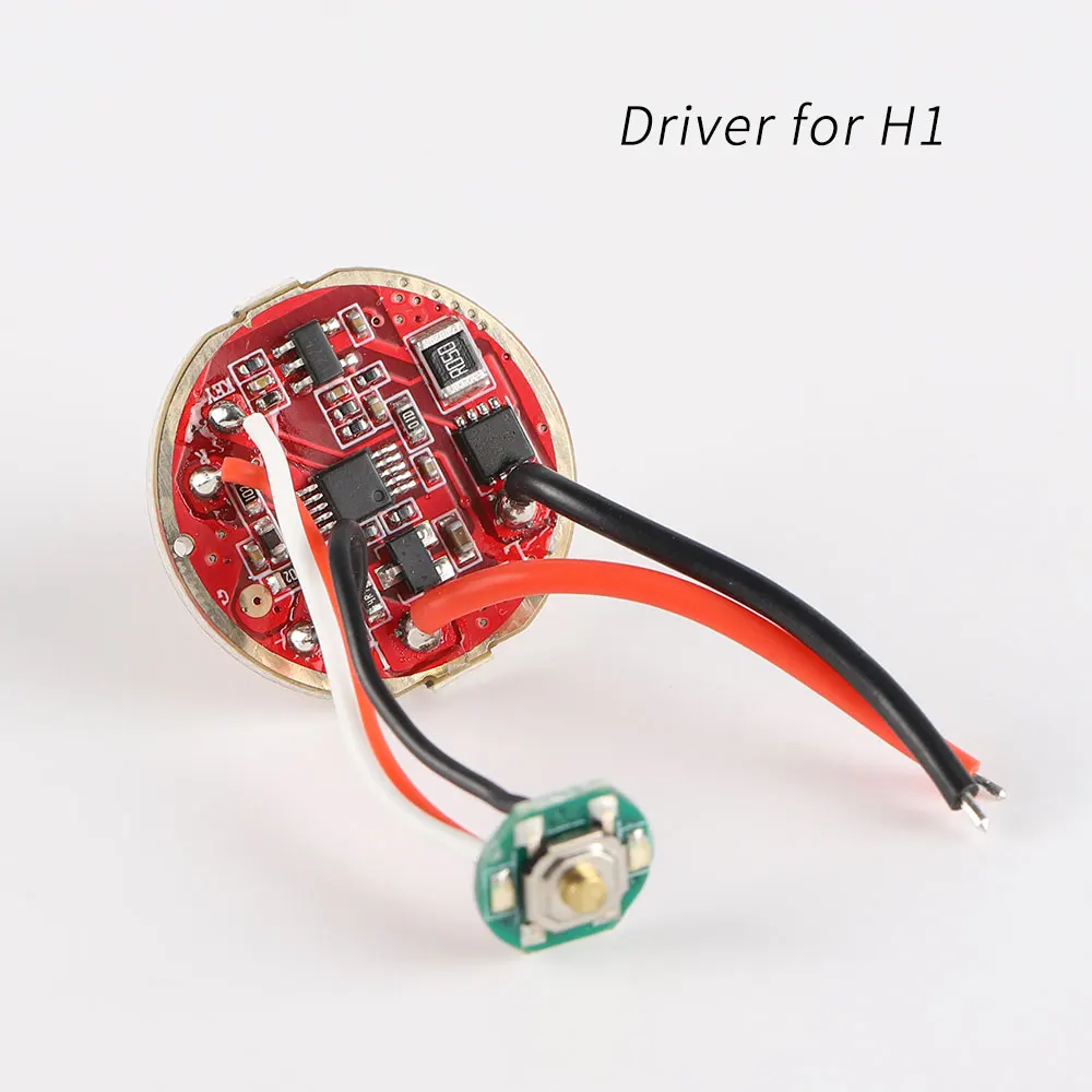

I believe all of the drivers you’ve listed are for tail switches only. Convoy have a couple of e-switch 17mm drivers but they seem limited to 3A of current:
The H1 driver:

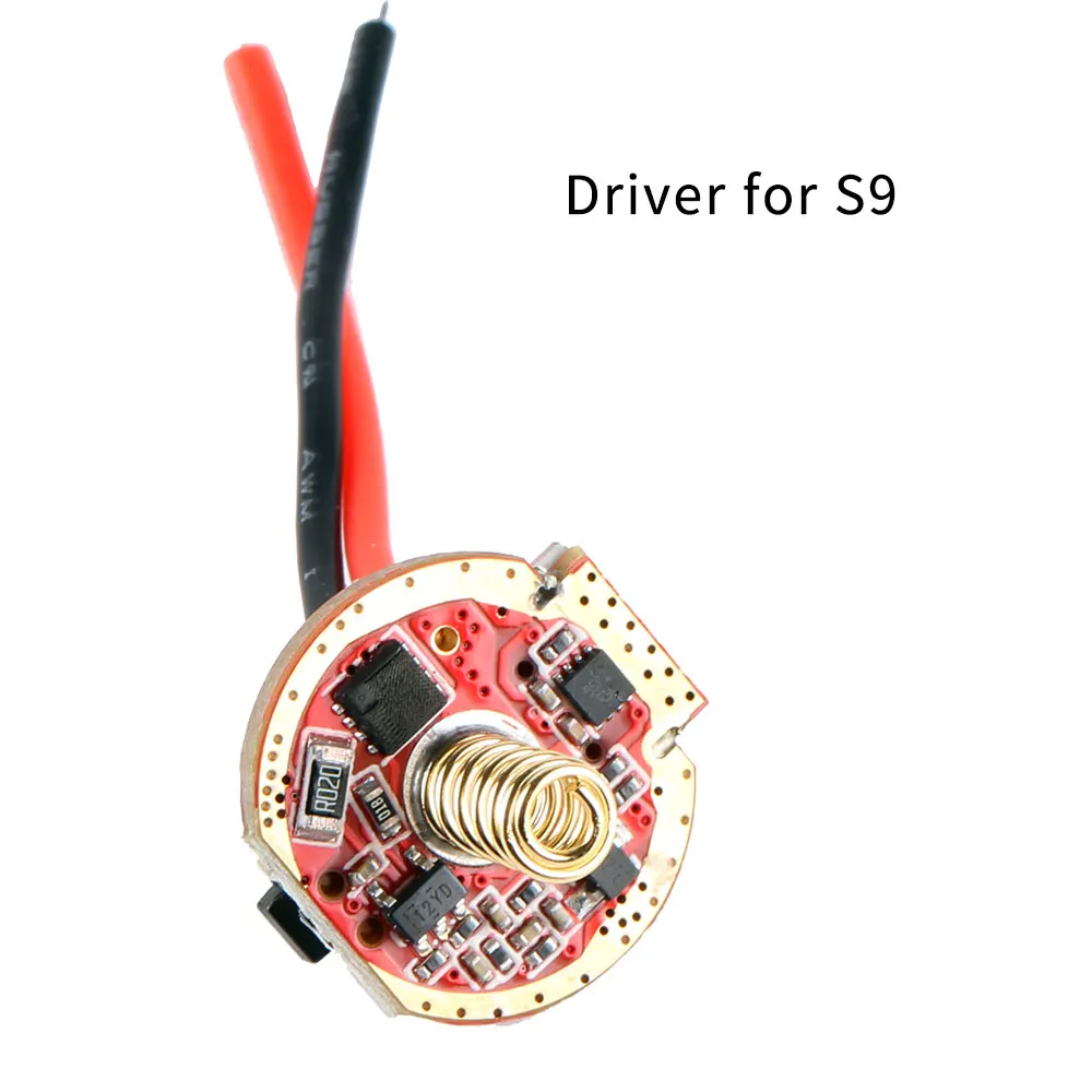

The S9 driver, which also has charging built in:
