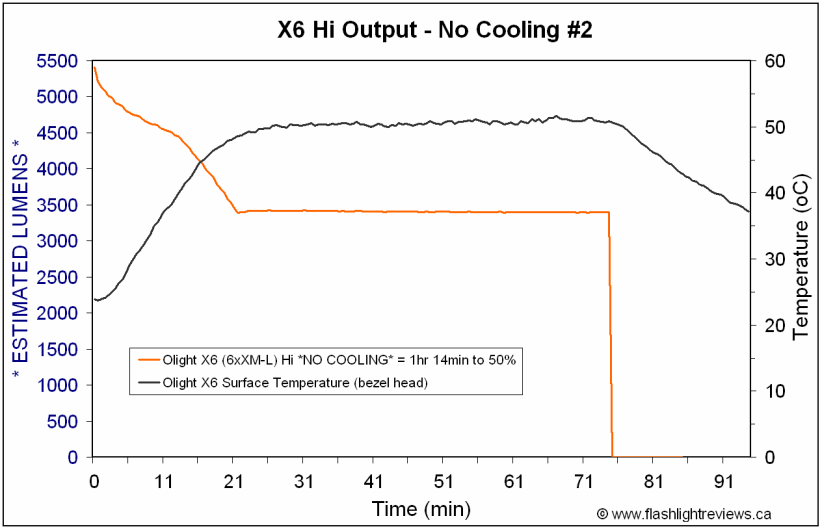

After getting a chance today, and spending some time on going over Selfbuilt’s great review Olight X6 Marauder (6x XM-L, Rechargeable) Review: RUNTIMES, BEAMSHOTS, VIDEO + more! | Candle Power Flashlight Forum!
of this Olight X6, I find this chart here >
I also find that it does have a “thermistor to monitor real-time temperature, and the circuit is supposed to gradually reduce the output when internal temperature increases above 85C/185F.”
When not being cooled by a fan, it looks like this X6 could benefit from some additional surface area for cooling. Like an aluminum housing battery container on the back. :slight_smile:
