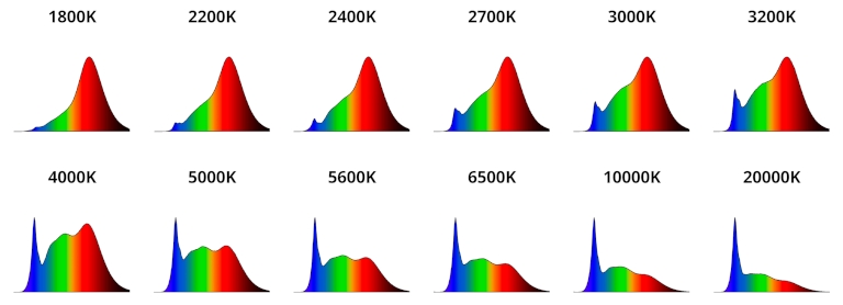

Don’t most/all LED blubs, even “high-CRI”, still have The Cyan Gap? (And The Blue Peak, too?)

Cyan gap? Yes. Blue peak? Well, it’s always higher than Cyan, but once you go below ~4000K, red is the dominant color, at least for high-CRI. And since low-CRI generally put s lumens/watt and raw output as their only real goals, they’re likely 6000K+ anyways.
That graph was exactly what I meant about The Blue Peak. Ie, unless the phosphor is essentially an opaque mask, some of the original blue shines right through. It’s that “thorn” sticking up from the spectrum “flower”, even from 3000K and up.
Kinda like a peaky resonance of a speaker at one particular frequency.
And The Cyan Gap because phosphors don’t easily reemit photons so close to what they absorb.

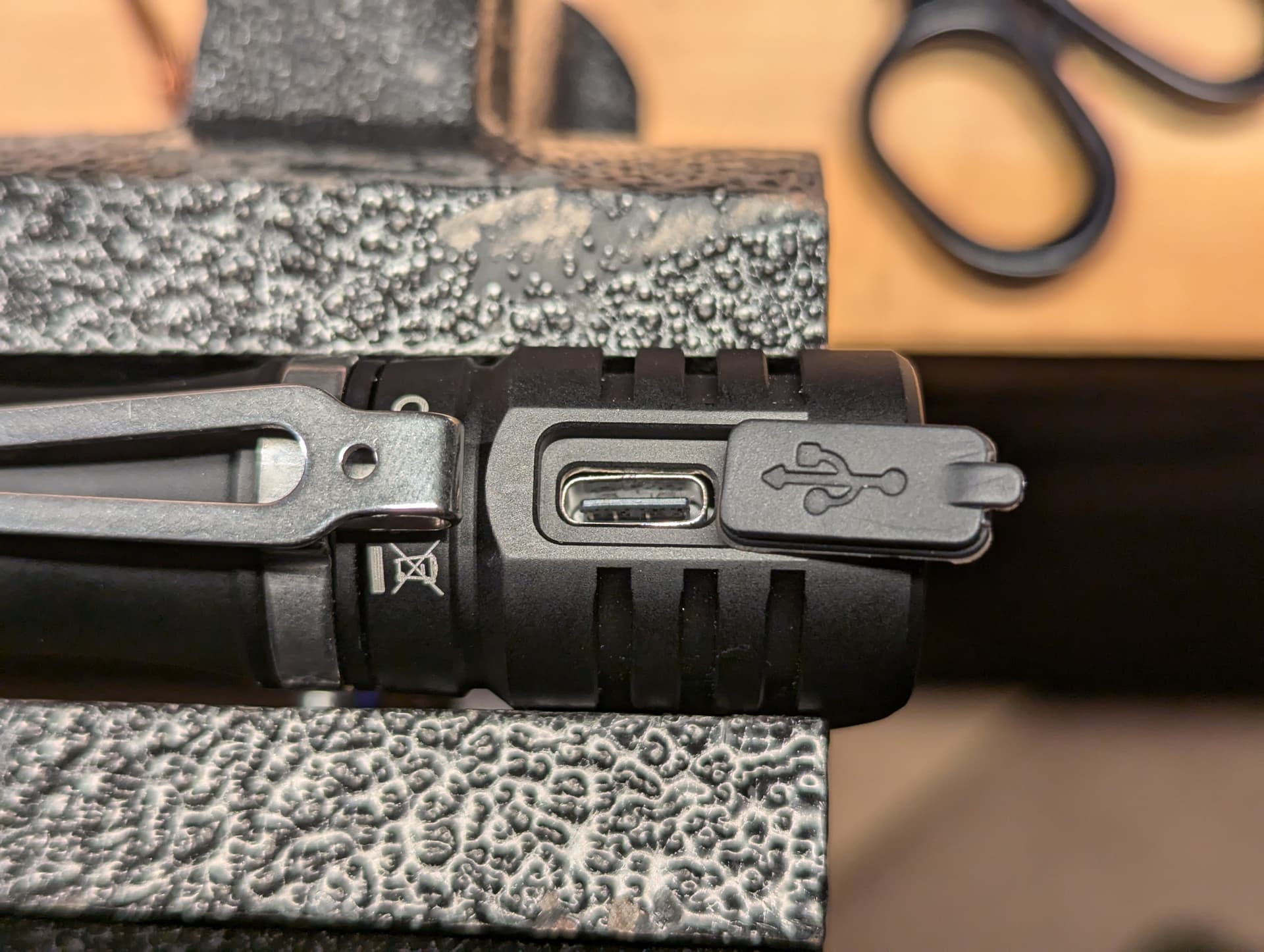

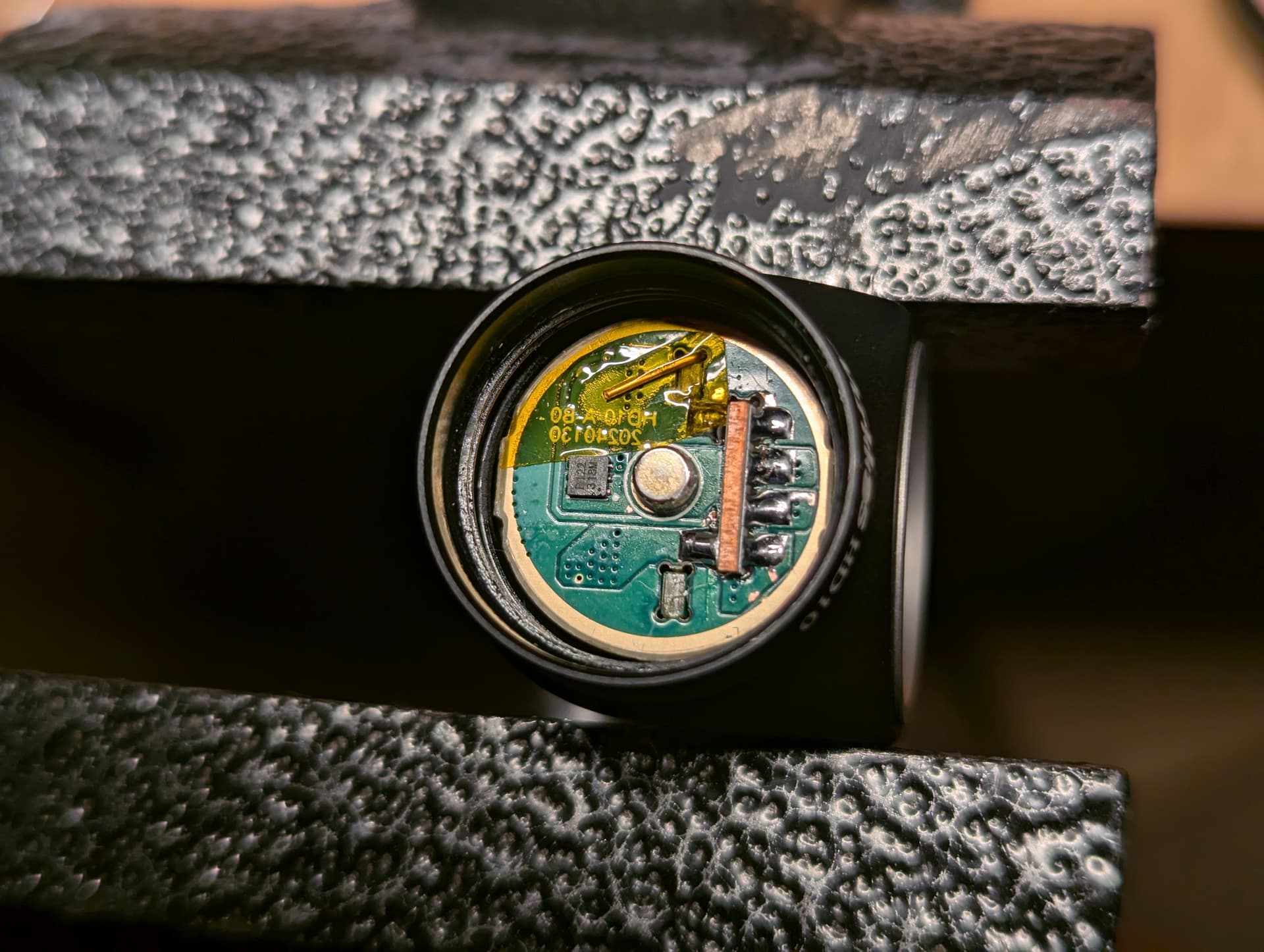

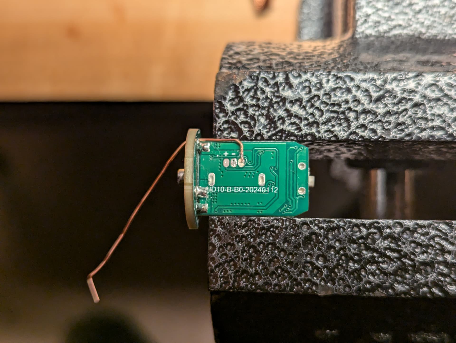

My HD10 just arrived with 7-25-2022 as well.
Updated to 4-20-2024 :grin:
6 Thanks

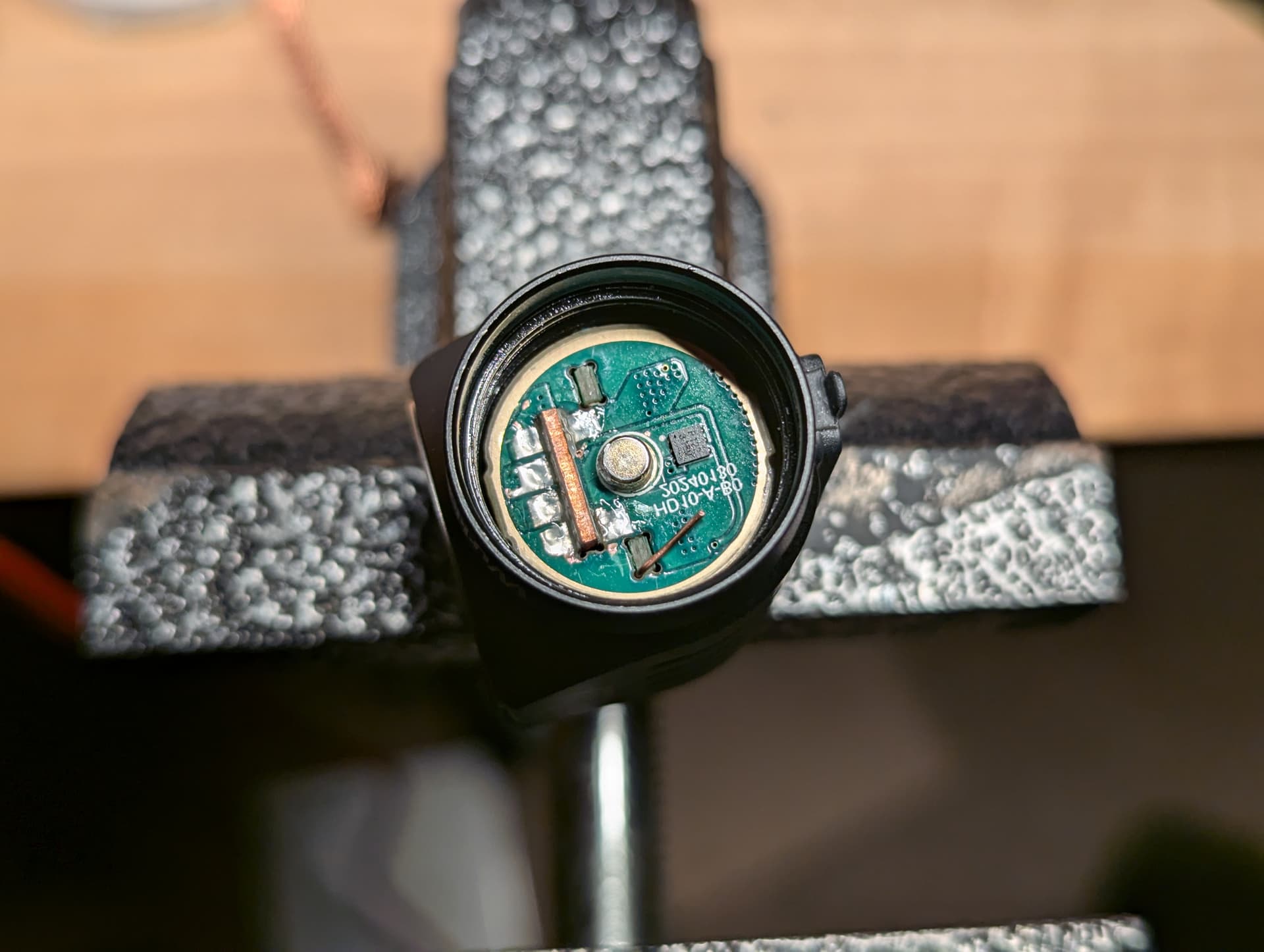

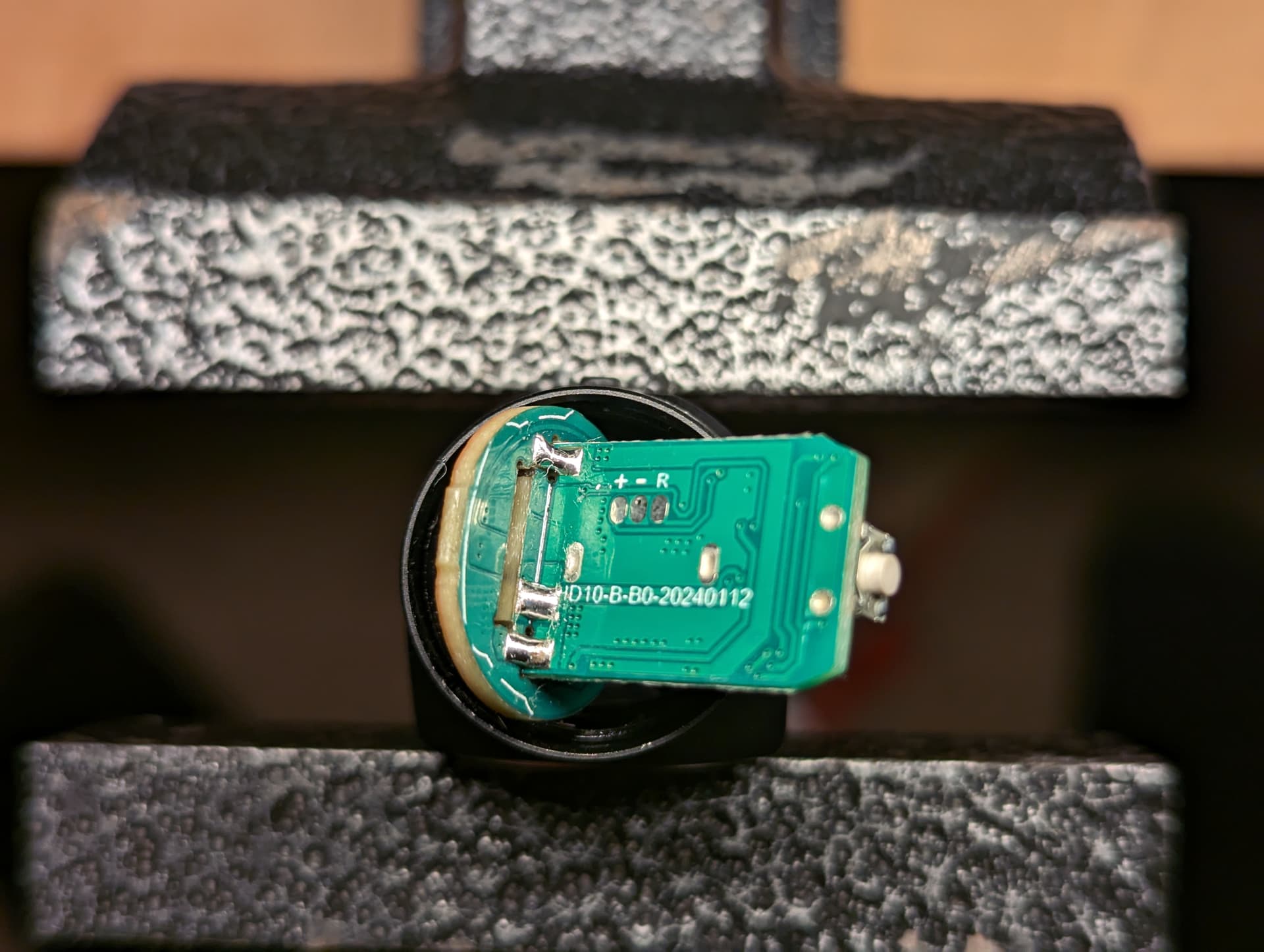

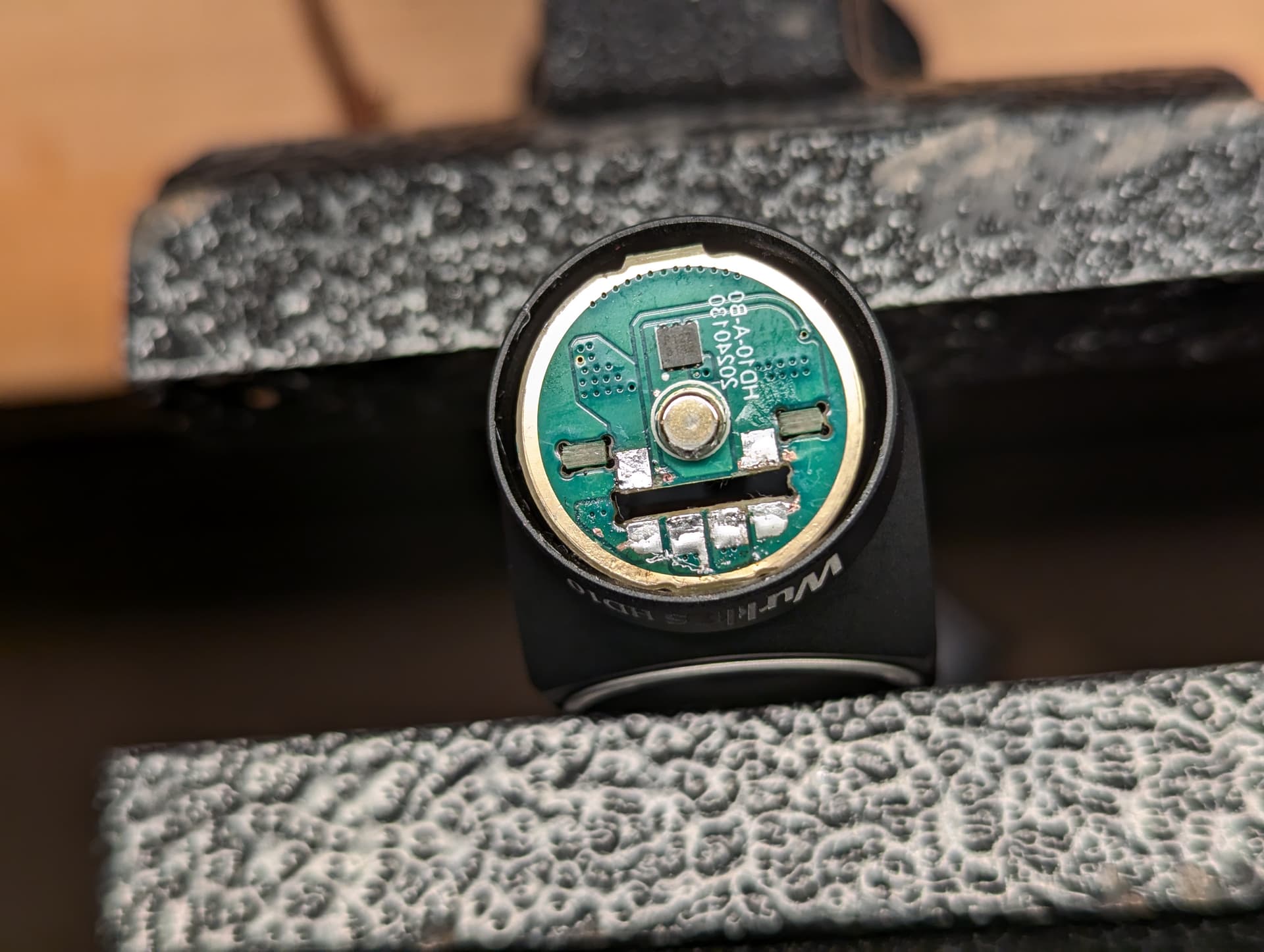

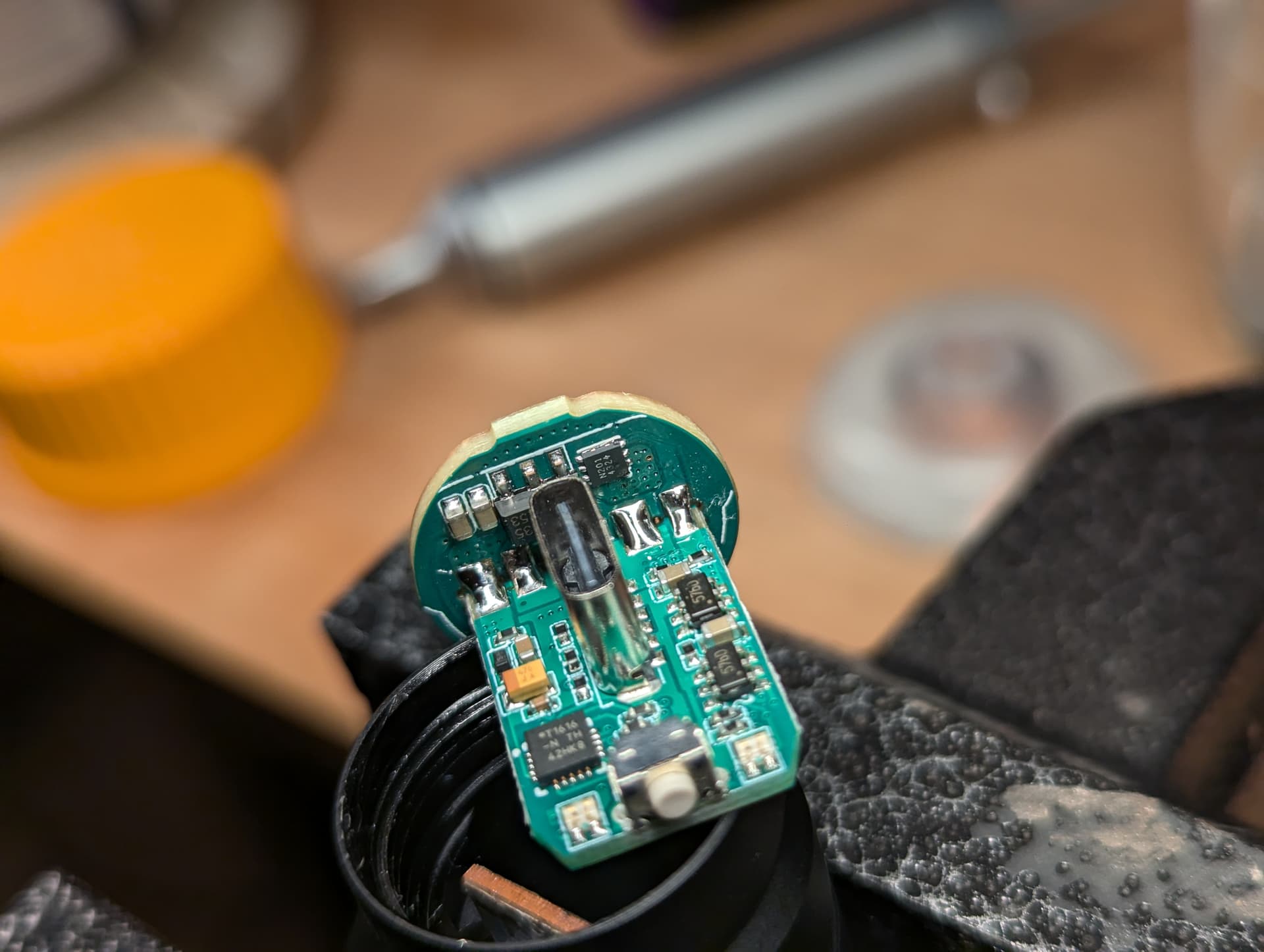

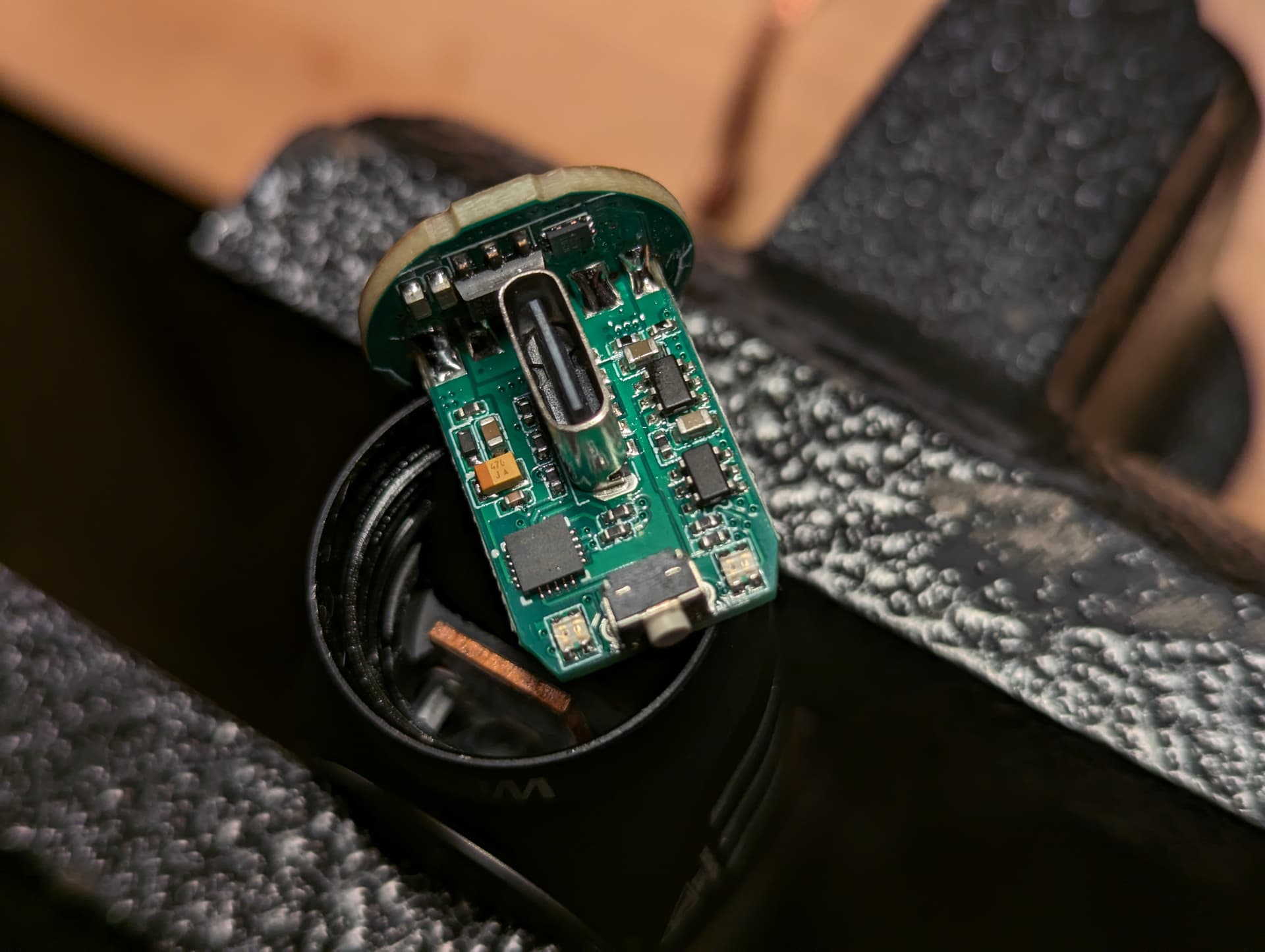

I have tiny adapter PCBs on the way to get a 3pin interface, but mine expect you to route the R cable next to the MCPCB, not next to one of those standoffs :confused:
The way you did it is actually smarter, but I did not think of that.
I actually thought I got the idea from you, but looking again apparently I didn’t lol, it fits perfectly in the mickey mouse corners even though I used 26awg which is so thick that hits the shelf and the driver sits a little crooked. Hasn’t caused any issues so far, other than the charge port being a little crooked :slightly_smiling_face:
