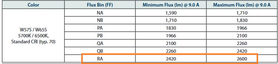

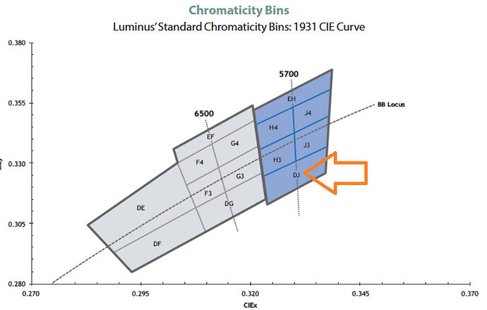

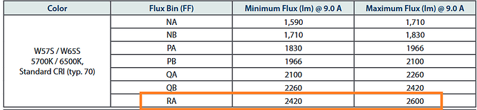

I don’t understand why we can’t see the highest Flux Bin LEDs within the best Chromaticity Bins.
Are they simply not available? Not orderable? Too expensive?
From SBT90.2 spec sheet:
For example, I searched extensively for a 5000K rosy SFT-25R G2 Flux Bin LED. While it technically exists according to the spec sheet, it seems unattainable in practice. Does this mean flashlight manufacturers genuinely prefer cooler, greenish-tinted CCTs? Or is there another factor at play that I’m unaware of?
One possible explanation is that when a new LED emitter enters the market, the initial batches available tend to have higher CCTs and a greenish tint. Since it’s impractical to order fewer than 500 or 1000 LEDs at a time, flashlight manufacturers are likely to use these early batches for an extended period before they can source higher-performance, better-balanced versions. If the emitter remains on the market long enough (before being replaced by a newer model) manufacturers may eventually release “v2” versions of their lights, incorporating more efficient LEDs from the highest Flux Bins and CCT options at the same time.
Just a possibility.
Binning is largely up to random chance. If you tried to make 100 identical LEDs, they will all have some variation in efficacy and tint. If you draw an LED out of 100 randomly, it’s improbable to get (A) a sample that is significantly higher-binned than average (i.e., attains maximum binning). It is also improbable to get (B) a sample with unusually good tint. These events are improbable because the distribution of efficacy/tint will not be uniform, but very light-tailed: the probability of getting higher than x efficacy (or better than x tint) drops superexponentially fast in x, if you assume a Gaussian distribution.
To get both (1) highest bin and (2) usually good tint is even more improbable than the product of the probabilities for getting (A) and (B), since the events are negatively correlated: efficacy tends to vary inversely with pinkness of tint. So if you get 5% chance of scoring a high bin and 20% chance of scoring good tint, there is less than 1% chance of scoring both. That’s why you don’t see emitters with top bin and good tint floating around often.
