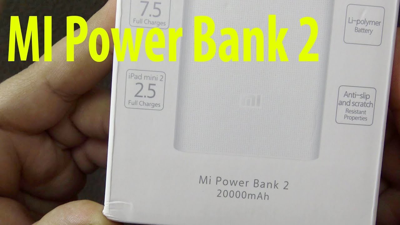

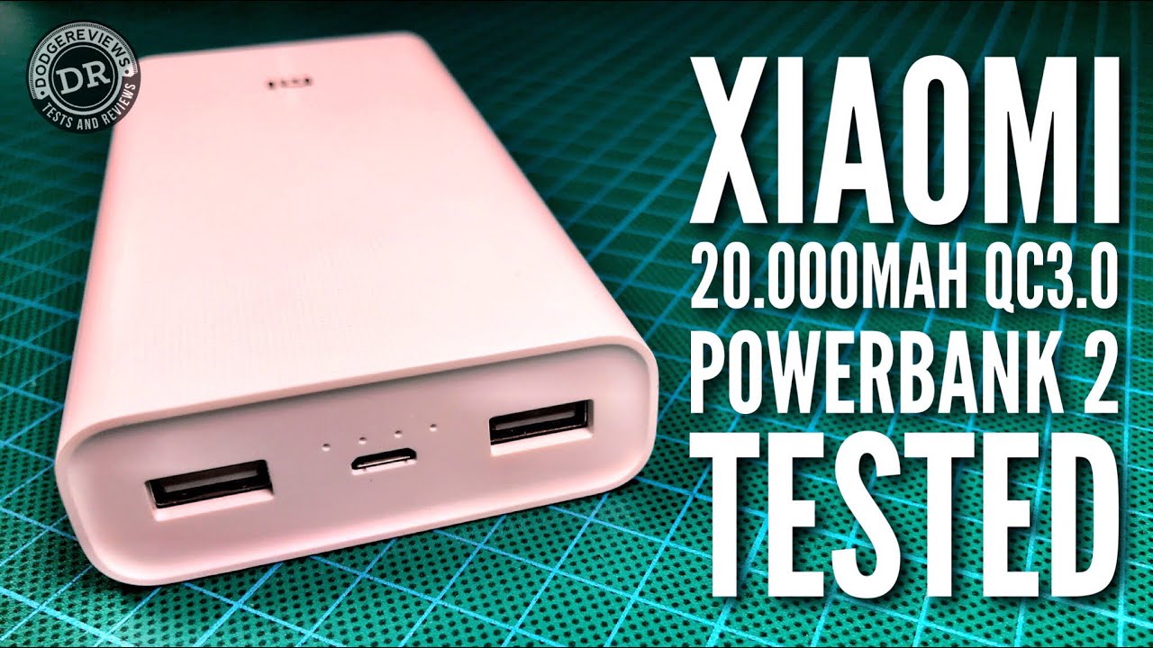

I watched some videos on Youtube and there it looks like QC is disabled for output but working for input?
Based on my quick testing, when passthrough charging is used, QC output is disabled, but QC input can still work (ie. the powerbank is being charged at 12v, whereas the device that’s connected to the powerbank can only be charged at 5v).
Ah, so that was you :D
Did you see me? :wink:
But good to know that pass-through charging and QC on the input work at the same time.

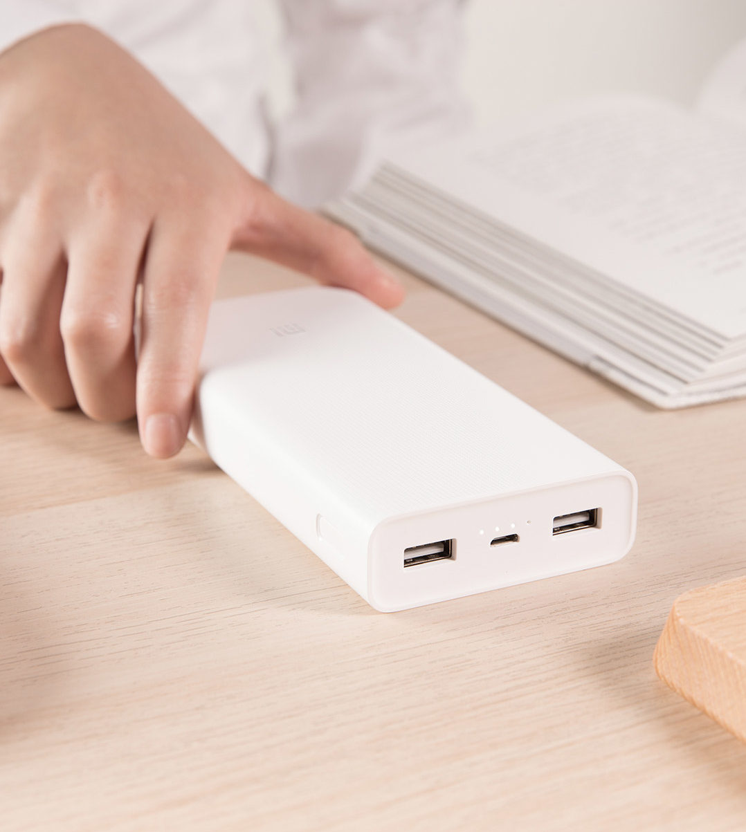

While browsing around, I notice another new model from Xiaomi — Mi Powerbank 20000mAh 2C PLM06ZM:
http://www.xiaomitoday.com/xiaomi-mi-powerbank-2c-20-000mah-review-almost-lower-price-tag/
It is supposed to be a lower-priced alternative to the 2nd-gen PLM05ZM (Mi 20000mAh 2). The PLM05ZM was released (in China) for RMB (CNY) 149, whereas the PLM06ZM is RMB (CNY) 129.
But from above review, the lower-cost also means it seems to be a slight step back:
- weight has increased (v1 = 338 grams ; v2= 330.5 grams ; v2C = 358 grams) - the heaviest of the lot (but still a good deal lighter than many 20000mAh powerbanks from other brands (usually 420-460 grams if using Li-Ion instead of Li-Po)
- the length is also slightly longer (probably why it weighs more)
- the same QC 3.0 output (only 1 port can be QC3.0 ; if both ports in use, then both ports can only manage 5v simultaneously)
- no mention of whether pass-through charging will support QC3 input+output (but likely not)
  • uses Fitipower FP6601Q chipset (the BlitzWolf BW-S9 uses a FitiPower FP6600Q chipset, so likely similar protocols supported)
- QC3 input is now only 9v/2A ; the v2 PLM05ZM can have 9v/2A or 12v/1.5A input (but probably just similar charging speed) [in my test I got 12v/1.6A charging rate sometimes for my PLM05ZM]
- I notice GearBest is selling this at $29, which is still higher than prices for PLM05ZM (as mentioned, the PLM06ZM is supposed to be cheaper than the PLM05ZM, maybe as it becomes more common)

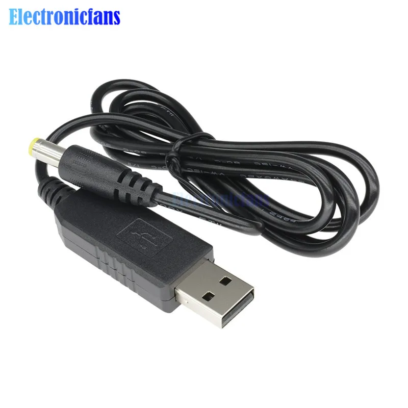

Depending on what you want to do, it’s probably safer to not have it always output 12v all the time (accidentally plugging a 5v device onto a 12v output USB port will likely fry it…
Anyway, this may be what you’re looking for:
5v to 12v step-up USB cable to DC 2.1x5.5mm (5v/2A => 12v/750ma max — possibly good for some low-power/basic wifi routers)

(the step-up module converts the 5v to 12v (this works on any 5v USB power adapter or powerbank, even non-QuickCharge ones) but lower output current only)

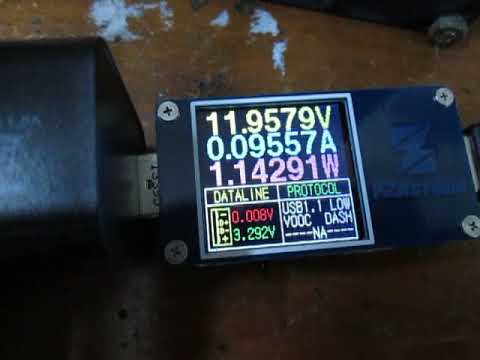

Some other meters like the YZXStudio ones also have a QC2/3 trigger.
for instance, this example of a ZY1276 USB meter triggering a QC2/3 wall charger to 12v and powering a small DC12v fan:
