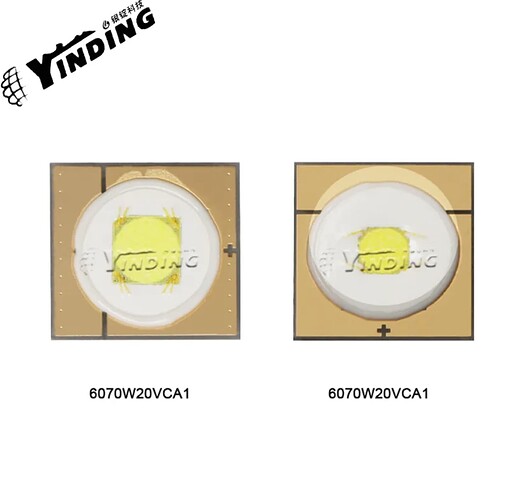

If you are interested on these things, the Yinding store have a 7060 version with a small L50 sized die and a big, close to L70 and L90 size die, which performed way better than the L70 in terms of intensity and better than the L90 in terms of color, and it has 8 bond wires instead of only four.
