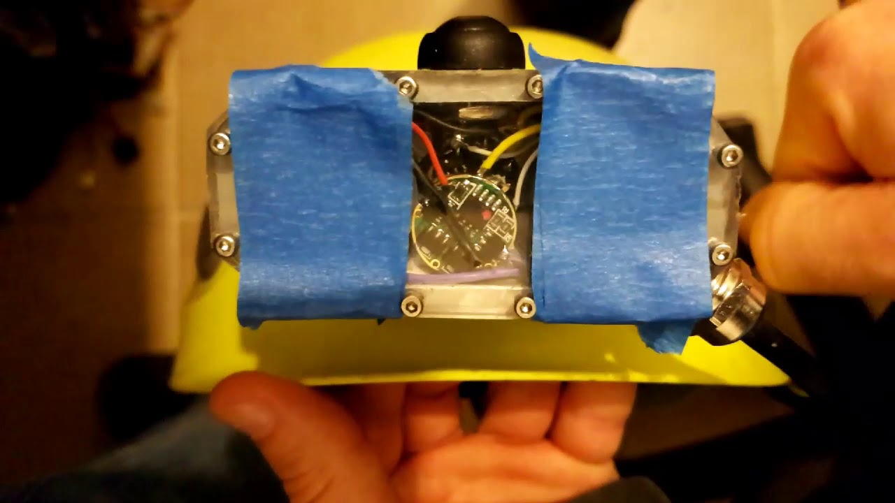

Just did the final adjustments, some fixes and mount it to the helmet
First I had to sew the elastic band that hold the battery box to the back of the helmet (never thought that sewing can be part of building a light)
Then follow the advice of MtnDon, pinkpanda3310, DB Custom AND G0OSE, I used 3M double sided tape to glue the GoPro mount to the helmet
And now I can finally say that this build is completed (one week ahead of due date)!

Oh, and how’d that 3m tape work out, is it still attached? i was thinking after it may be a bit heavy for that tape, and thought about using strong magnets………. or maybe a high quality mini cam mount with sucker/windscreen mount? (not an ebay $2 one)
