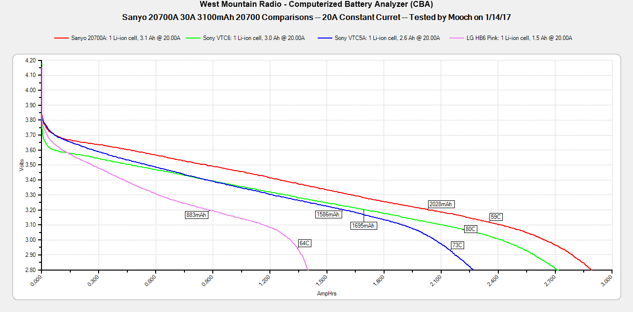

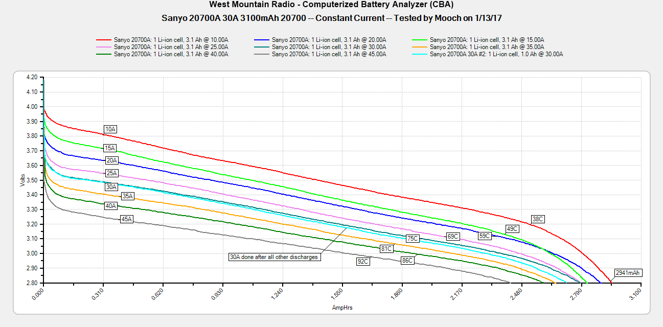

Cool, looks like the 20700A has the same IR as the lowest IR 18650s (like the VTC5A).

Looking at HKJ comparator the 20700 does not seems as good as there, for the initial 500mAh at 20A

You did the chart for the NCR20700B the high amp rated cell is the NCR20700A
You are right texas shooter
