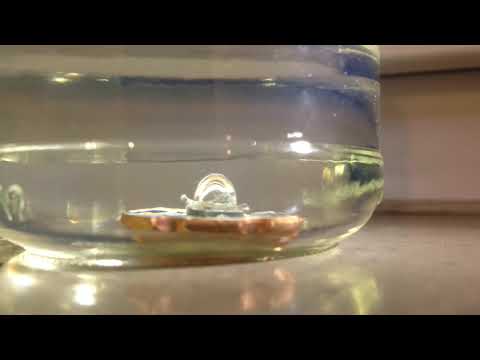

Just did my second successful dedome with gasoline and made a timelapse of it. You can really see the dome swelling.
Cool!
