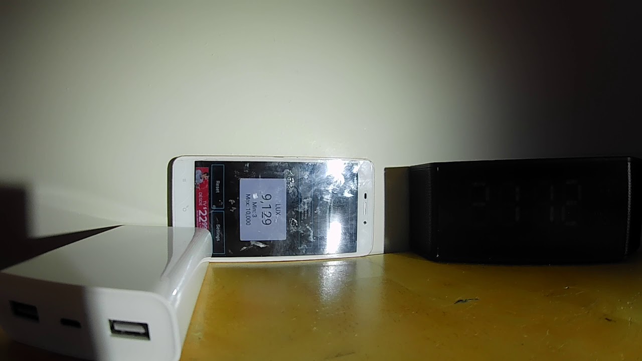

My ceiling bounce results were very close to ArmyTek. Considering the amount of error involved in a ceiling bounce I would say their
specifications are spot on.
ArmyTek Specs
—- Mode 1: 1050 lumens / 40 min : Mode 2: 340 lumens / 1 hr : Mode 3: 150 lumens / 2.5 hrs : Mode 4: 30 lumens / 15 hrs : Mode 5: 2.3 lumens / 168 hrs : Mode 6: 0.4 lumens / 1296 hrs
My Specs
—- Mode 1: 920 Lumens / 40 min : Mode 2: 320 lumens / 1hr 10 min : Mode 3: 175 lumens / untested : Mode 4: 37 lumens / untested : Mode 5: could not measure : Mode 6: could not measure

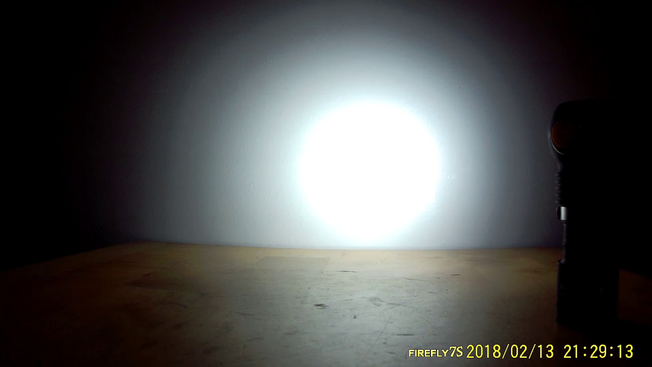

The interesting thing about this light is that it can maintain 90% of it’s output for nearly 30 minutes. The thermal protection kicks in around 8-9 minutes and reduces output by about 10-20% after the light recovers it does return back to 100% output. considering the size of this light it is outstanding that it can maintain 800-900 lumens for that long of a time period. I also found that the LED indicator for overheating and low battery worked accurately, and it was actually quite easy to distinguish between the two notifications. What I observed during the turbo runtime test was that the light maintained full output for 30 minutes. There was a slight variation of 10-20% as the thermal protection kicked in and out. At the 30 minute mark the light steps down to about 20% output. It continues on at this reduced rate for another 8-10 minutes and the light then switches to moonlight mode to protect it.

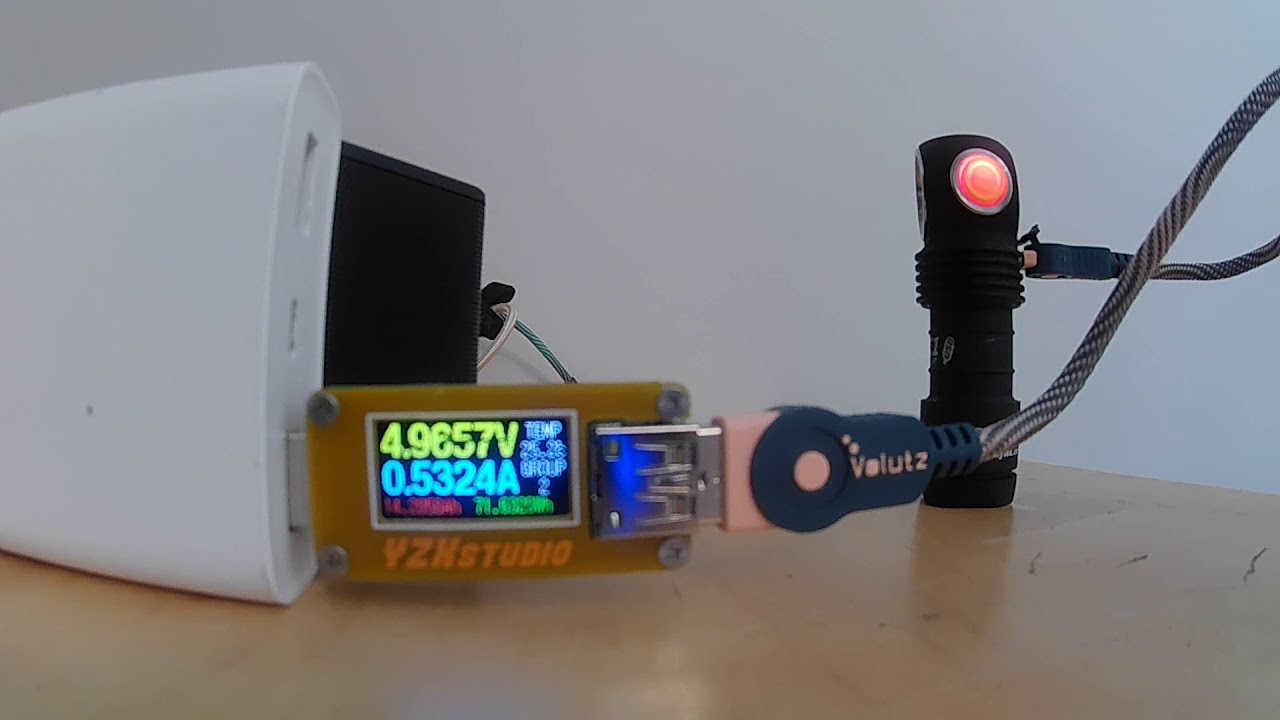

I included a time lapse of the battery charging from empty in my youtube video. I found that the light charges at .5 amps and as the battery fills the current drops until it is trickle charging (.05a). At .05A the indicator light turned from red to green. I pulled the battery and let it rest and it was at 4.18v. I have had no issues with over/under charging and the light transitions from .5A to .05 quite slowly so I don’t fear overcharging of the battery.
