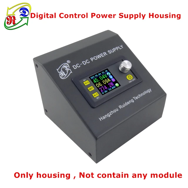

Looks like the case option that RD tech offers has changed.
OLD:
NEW:
I noticed that as well, I am torn, I like both designs and see uses for both of them. I wish they still offered the old one as well, it is great if you want to stack things on top of it and thus use up less workspace.
Exactly my thoughts too.
sorry, I did not saw this . thank you for your help you
yes, this is new housing , the old one , we don’t produce it now ,. maybe after 1 month, we can produce this old one
thank you for your advice , because the product problem, we don’t produce the old one , now we are dealing with this , we will begin to produce the old one after 1 month
