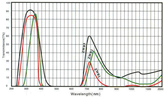

ZWB2 actually better for 365nm. ZWB3 is for shorter wavelengths and transmits much higher into the visible range: .
ZWB1 even better for blocking visible but worse for UVA transmission.

yes but still the ZWB2 filter is not really blocking everything above 380nm so always that purple glow visible,
sure it gets better but far from good 20nm wide 365nm bandwidth filters that reflect >99.99% of all above 375nm back into the light so it gets absorbed by a few passes on the reflector
