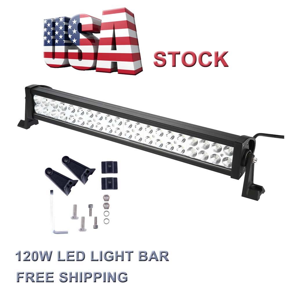

I'm talkin' about something like this gut'ed for a series of cree xhp50's. They are 24" long & $22.99 so to me it seems its just like modding a flashlight. i wonder if those SMO reflectors Simon is supposed to get for the Convoy L6 will work?

You could, however, throw in a bunch of lower power LEDs, say some XPL’s at the most, some 20 - 30mm Carclo Optics, either elliptical flood or spots or a combo. I have never seen anyone actually attempt anything like that though. The case is not water proof, they really aren’t, you go buy one and take it apart and you will see how badly made they are. And I don’t even know if it could handle XPL’s even, the thermal path is REALLY bad.
Go for it, then give us a little feed back. I’ve helped install a few on friends jeeps and trucks. Only Baja Designs and Rigid Industries looked as if the designers knew what they were doing. The cheap Chinese imports are flimsy, poorly fitted and far from water resistant. But for $22.99 you could do worse. Personally I stick to replacing the LED’s with XP-G2’s mounted on the largest copper pads that will fit. Internal shelf will probably be thin and extruded as the housing. Improved efficiency could make it worth the effort. You’ll have no room for larger reflectors, you’ll have very little room to run more wattage.
That said remember that the original poster of this thread has demonstrated a do it right from the beginning philosophy. I personally believe you get what you pay for and $22.99 might not even be worth that if you intend to actually mount it on a vehicle.
Heat is definitely not your friend in an application like this. I would venture to say one would have to be moving to keep it cool. I'm sure a solid copper board would help dissipate heat as well.

I’ve actually seen in the specifications on at least a couple of the cheaper bars that they clarify they’re not to be mounted in a static location, or indoors. Apparently plenty of moving air was assumed in the design specifications.
Half the fun of modding a flashlight is to see what it can & cannot do. We all have seen good/bad products from China so its fun to fix the flaws & make something better. This is true in thermal dynamics, ip rating or whatever. I would agree that the mounts that come with the China light bars are junk. Making a set of brackets is not a option, its a necessity.
