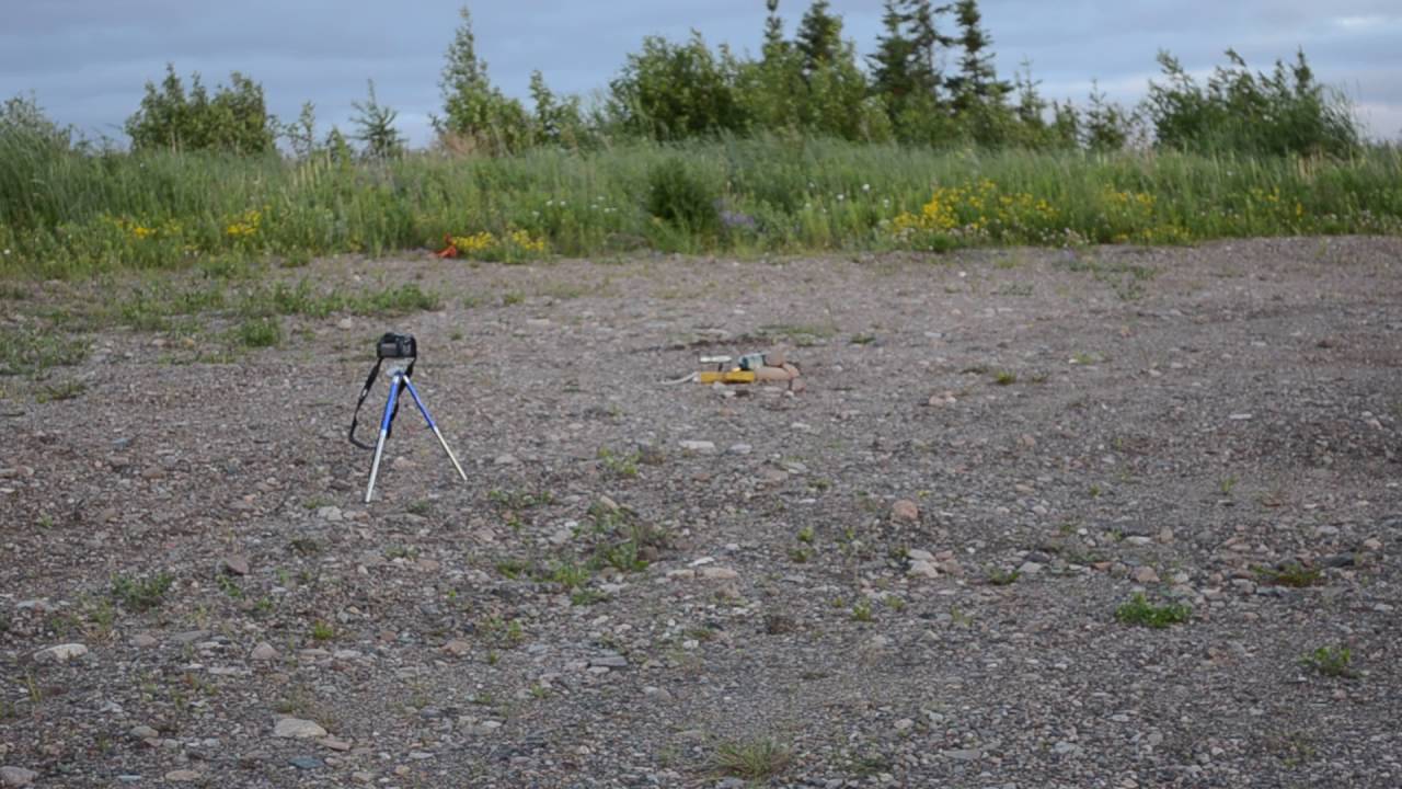

I did a cell venting in a flashlight test. I could not get laptop cells to vent with power surges as high as 120 volts AC from a 3000 watt generator or a direct 12 volts DC from a 700CCA car battery.
The only way i could get them to vent in the light was heat the cell (flashlight body) with a remote propane torch.
here is the video: >> https://www.youtube.com/watch?v=6acpwEqp5zg&t=18s
