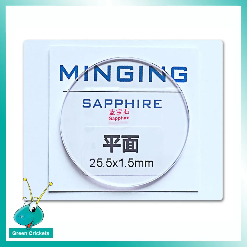

Anyone know any methods for removing the AR coating on the lens? It appears to make the beam a fair bit greener so I’d like to get rid of it. I’ve tried using a polishing abrasive but it only made a few scratches. This method has worked on my A6’s coating before but I guess coatings can vary in hardness.
I have the same with my FW3A with FA3 SST20 leds. The tint is good already but the hotspot is only a tiny bit above the BBL and I hope with an uncoated lens to land right on top. I decided to order a pair of sapphire lenses, they are uncoated and makes the FW3A a bit tougher too I hope.
This is where I got them:
I have bought from them before, and although I can not tell for 100% that it is real sapphire, by the looks and the water droplet test it could be legit.
They are still in the mail, to be delivered today or tomorrow. I can post before/after results on tint.
