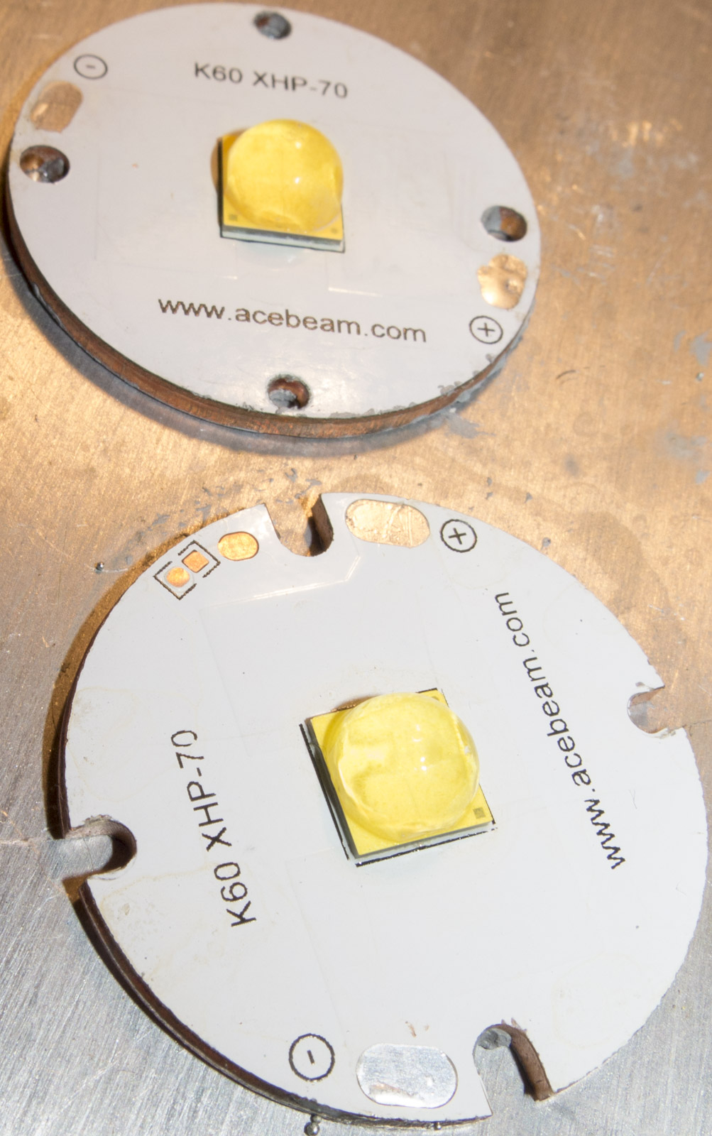

I was thinking changing my original emitter being a 1st gen xhp 70 to reflowing a newer xhp 70.2 and shaving the dome and wanted to know if anyone else has sucessfully done it yet?All input is appreciated
I have modded for 3 German TLF members the K60
One 4000K 2 5700K
Emitter swap is easy he bezel is not glued

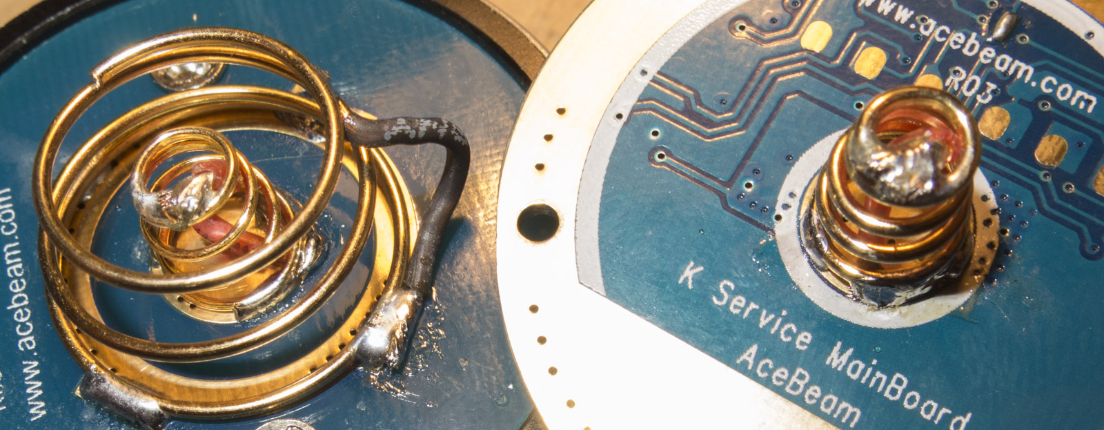

Bridged all springs

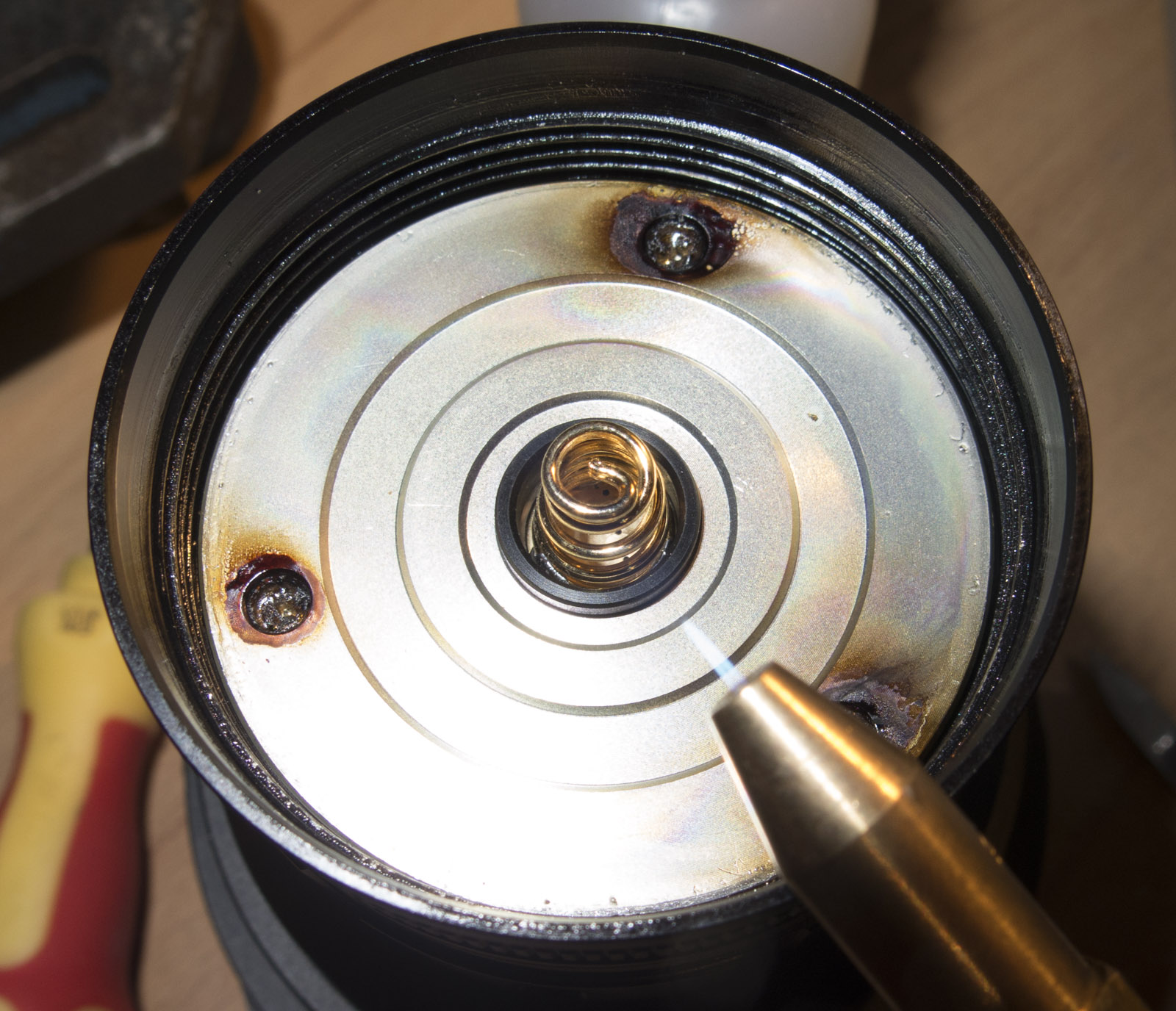

To get to the driver to add a 0.1Ohm one is a pain as the screw heads are glued
I used my Dremel with a 0.75mm tip to get most of the gleu out of the head, then used 3000dCelsius oxygen-gas burner to burn out remaining glue and heat up locally
Then it was easy to unscrew the driver mounting screws

Omg blowtorch to screws??
Use acetone, softens glue.

2 component epoxy laughs about Acetone
there was almost 2mm thick glue on top of the screw and also below it
Heat is way better than acetone on epoxy
Its not a regular blowtorch its 3400°C Oxygen fueled gas burner, you can basically get a lot of heat in a small area without heating up the whole thing
Acetone worked perfect with my K40M glued screws. No damage done during disassembly.
Mike
I may try on next mod
Heat also does no damage, just clean up the burned residue
