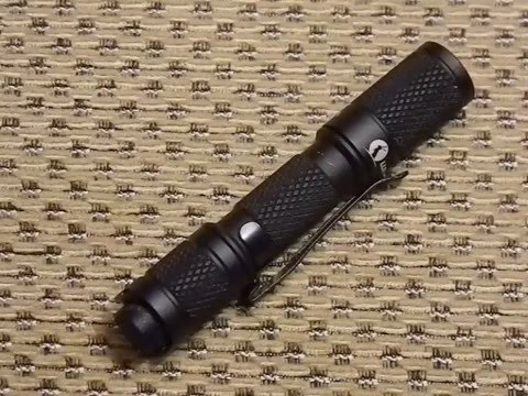

As you can see from these 2 graphs the Tool AAA has pretty good mode spacing. The lux is measured using a ceiling bounce that I calibrated as close to rated lumens as I could.
Runtimes were decent. My only disappointment with the light is the NIMH runtime. Although I got 8 minutes more than Lumintop advertises in their specs, I would like to see this be a bit more competitive with the Ti5. Although I didn’t make a graph, this light has awesome performance with energizer lithium batteries.
Runtimes:
NIMH - 38 minutes @ .91V
Alkaline - 40 minutes (only bright for about 20)
Construction:
The light is well built. Good threads, good contact points with the batteries, with no rattle. The reflector is OP and a glass lens. the pocket clip is probably the best of any of my AAA lights. It fits pretty comfortably in a thick pair of work jeans. I can’t say the same for most AAA lights. The o rights were all in good shape and the light did have some light lube on the threads.
size comparison:
Beam Shots:
Med mode:
High Mode:
Lumintop Tool Vs Thrunite Ti5
Final Thoughts:
What a nice little light at a nice price. I really like what Lumintop is doing with their amazon store. They offer the light in several different options, and also make it easy to get replacement pocket clips. The only negative I have to report is that runtime with NIMH is a little on the short side for my liking. The construction seems great, and the performance is nice. I took this guy backpacking and the pocket clip is plenty strong and the light is definitely water proof!
Amazon has a version with both clicky and magnetic tail caps for those who want to try both. I ended up using the magnetic tail cap (so now its a standard twisty) cause it shorter and personally works better for me for the way I hold the keys and light. The clicky tail cap works good when the light is detached from my keychain.
