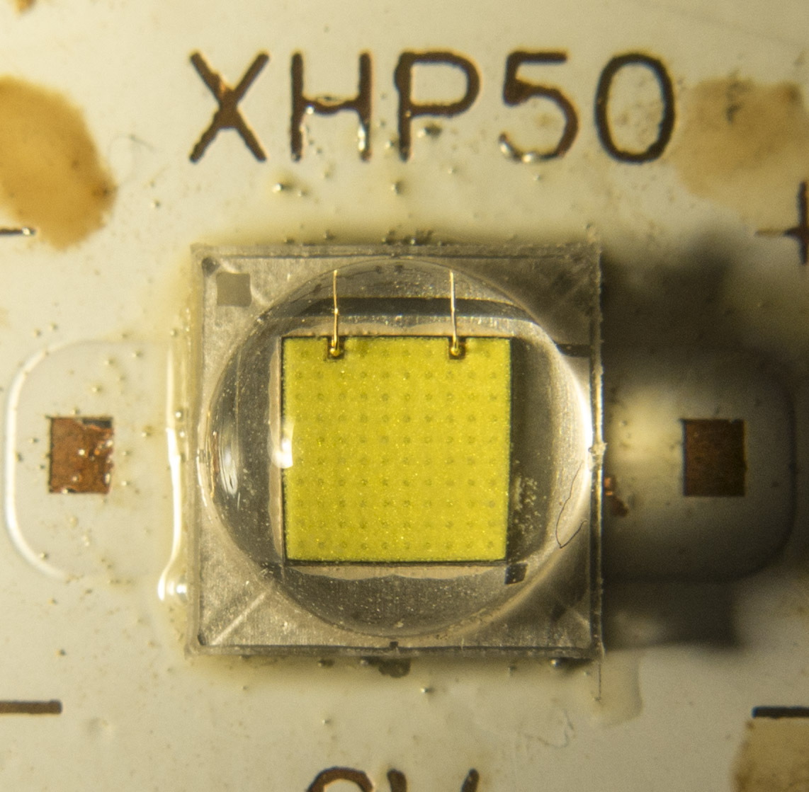

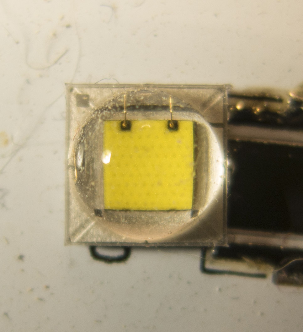

they do not look like real SST-40s
bond wire pads are different
also the dots are not in square pattern
Die seems to be a tiny bit smaller
Phosphor edge is different, also phosphor itself looks different
That looks at least interesting, if it is not a real SST-40 then at least the forger did its best to make it look like one, if it is a real one then Luminus made a new die for it.

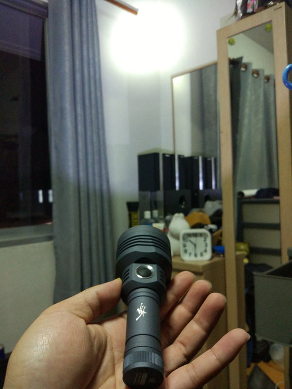

So I tried a N5 BC (Voltage: VH) in my M21A. My LD-A4 driver in the light was ordered with 8-12 Amp range so I set it to the bare minimum. Tail current was measured at 7.94A and voltage across the LED at 3.446V. It’s obviously bright AF, quite close to the sliced dome 3V XHP50.2 that it replaced.
The XHP50.2 measured 3.226V across the LED and the MOSFET probably took a hammering and caused the driver to overheat the whole time.
I will have to replace the LD-A4 with a LD-B4 driver and the corresponding PCB to combat the hot MOSFET. But I need some advice…….
Will it be OK to run the SST-40 at 8A? Or should I dial it down to 7A? The light is being used as a tactical light with high to low modes, no mode memory. So it always starts in turbo.
