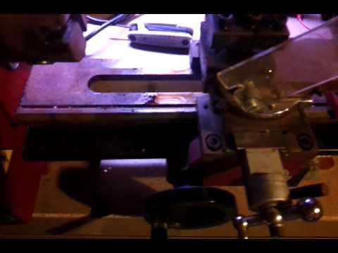

Here is a video of the lathe running. I think I have to align the belt a little bit because it sounds like it is touching the housing. I have been cleaning alot and it's looking better. Some very fine surface rust on a lot of surfaces that I want to get off. I guess I would just sand it off with some very fine sandpaper. Lots of work to do yet.
Scotchbrite and WD40 for cleaning rust.
Mineral Spirits and paper towels for removing dried on Chinese shipping grease.
I would assume that every possible adjustment and alignment is wrong.
That means go though EVERYTHING and make sure it is correct.
Consider it a lathe shaped kit, some adjustments required.
The noise could be bearings, they get noisy if they are set too tight.
You can remove one of the gears, that drives the spindle.
To try and isolate the source of the noise.
If you are real lucky, the spindle runs on
tapered roller bearings and they are set too tight.
Back them off a little, then retighten.
there should be zero play, axial or thrust, in the spindle, and it should run quiet.
The motor will be noisy, and the Gilmer belt will make some noise.
But it is definitely not correct the way it is.

may be speed controller dead.
brushes looks ok.
if me, Ill test it with direct drive without speed controller. Anyway I can help you from my little knowledge .
sometimes direction switch (forward / reverse) may be faulty.
for missing Jaws, can mill new jaws from exiting jaw.

Langcjl, congrats on the great score! If you download and read the manual, it should have the part numbers for the chuck jaws. I had to order a couple pieces for my HF lathe last year, it took 6 weeks for the parts to come from the factory in china. Please dont use sandpaper on your lathes ways, use oil and a nylon brush to remove the surface rust. When you get the new chuck jaws they have to be installed in a certian order and should have numbers stamped on them somewhere. I use a light coat of way oil on the sliding parts of the jaws and a little synthetic grease where the jaws contact the scroll inside the chuck.
