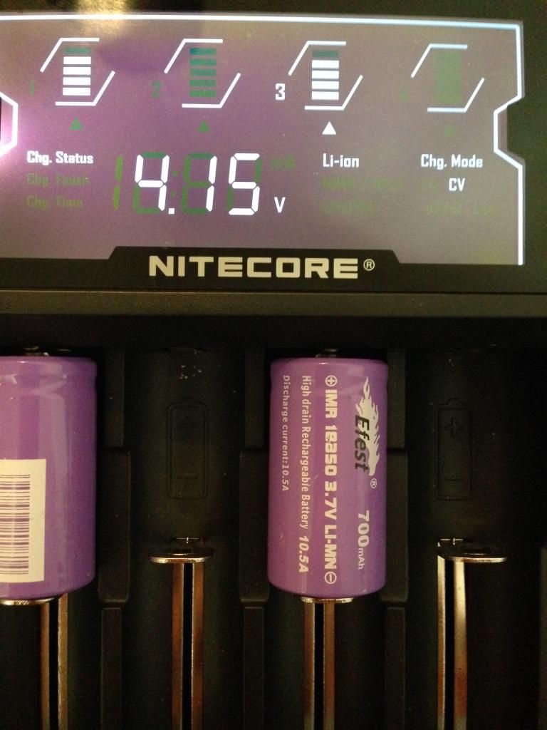

Hi I use Efest IMR 18350s
I ordered them thru RMM:Efest Purple IMR 18350 - 700mAh - Button Top
I’m using these for this vinh MT-G2 dropin:CLOSED WTS: Brightest Regulated M2500 P60 LED (Beam Shots) | Candle Power Flashlight Forum
I will give the 18350’s a try and see how they work in my mini… Funny size battery. Does anyone know what their primary use is?
I like your charger. I just got the Nitecore D2 and it works well with the 18650’s I pulled from an old laptop battery pack.
