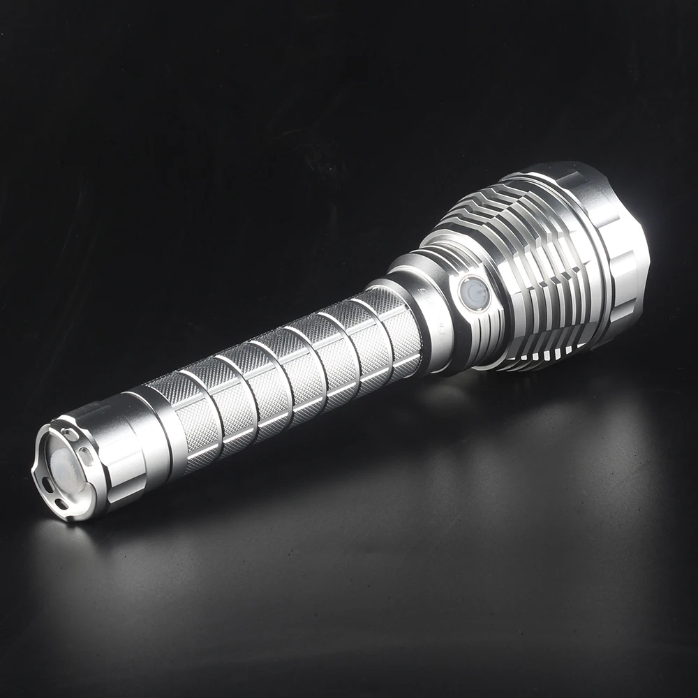

I’d also like to know if a lighted tail is possible with an e-switch driver?
I don’t think it can be done with the fw3a but maybe something like a d4 with an inner tube to carry 2 currents - one for lighted tail, one for main LEDs.
Doable?
D4 does not have double tubes or any way for light to get through the tail.
Does such a light even exist that is e-switch in the tail and also translucent for light? I’ve not seen such a light.
The whole question is a bit confusing to me.
Maybe a light like the L6 that has two switches and have the tail light up?
That’s probably possible. I think you can add a led and resistor and just wire it up direct in the tail. It will stay on all the time. It will be a constant small drain. You twist the tail to turn it off.
Sorry I wasn’t clear enough. I would machine up inner/outer tubes since that’s likely the only option.
I’m not really familiar with the L6 (never had one). From your explanation it sounds like no clicky in the tail just the circuit for tail lights? If that’s the case it would restrict power to the main LEDs. Hence either a lighted clicky or inner/outer tubes is needed.
I don’t see a need for an inner tube. Tail switch is clicky. No power restriction.
You need to give an example of a light for anyone to say yes or no it can be done. Is this a theoretical question? If so, then yes it can be done.
Ok I’ll have a think how to better explain myself. Thanks for taking the time though :beer:
