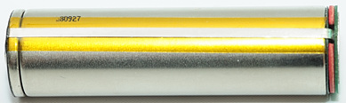

i just ordered 8 pieces of true 2400 trustfire flames from DX.
i had a hard time with two fitting in the charger. they appeared to be taller. i took one of the short and one of the longers apart.
they are clearly from a different factory / vendor.
i must say the longer style is dangerous. the strip running from the positive pole down to the pcb on the bottom is only protected from a direct short by a tiny 5 mm wide kafton tape strip , below that is bare negative body metal.
the shorter batteries that i got are alot better , its wrapped in a white plastic ( the whole body) , then kafton strip , then the metal positive strip.
the batteries all arrived in the same package however 2 of the 8 are different. the shell and protection circuit also differ.\
the taller ones also have the button top welded on instead of being built directly into the battery style. this is whats causing them to be about 1.5 mm taller.
i am going to dispose of the taller more risky ones, just not worth the risk.
i am pretty sure most the explosions we have seen are from the positive strip rubbing off on the body of the flashlight and causing a direct short. the wrapper is REALLY thin.
i recommend to give it a wrap in a layer of clear packing tape. it cant hurt.

my BIG problem with these trustfires is with the lack of insulation and really thin wrapper. the funny part is the added protection is what makes them so dangerous.
I recently got the "taller" variant for their 14500's, too. Other users report cheaper manufacturing inside w/ 1 mosfet instead of 2 originally. Same price, lower quality. Sigh...
That's a monster sized pic! Very dodgy looking. Thanks for the warning. I gave up purchasing batteries from dx (and lights) after a bad experience last year. They sent me some dodgy 18650's tf flames and soshine and would only credit me 65% of the purchase price back.
