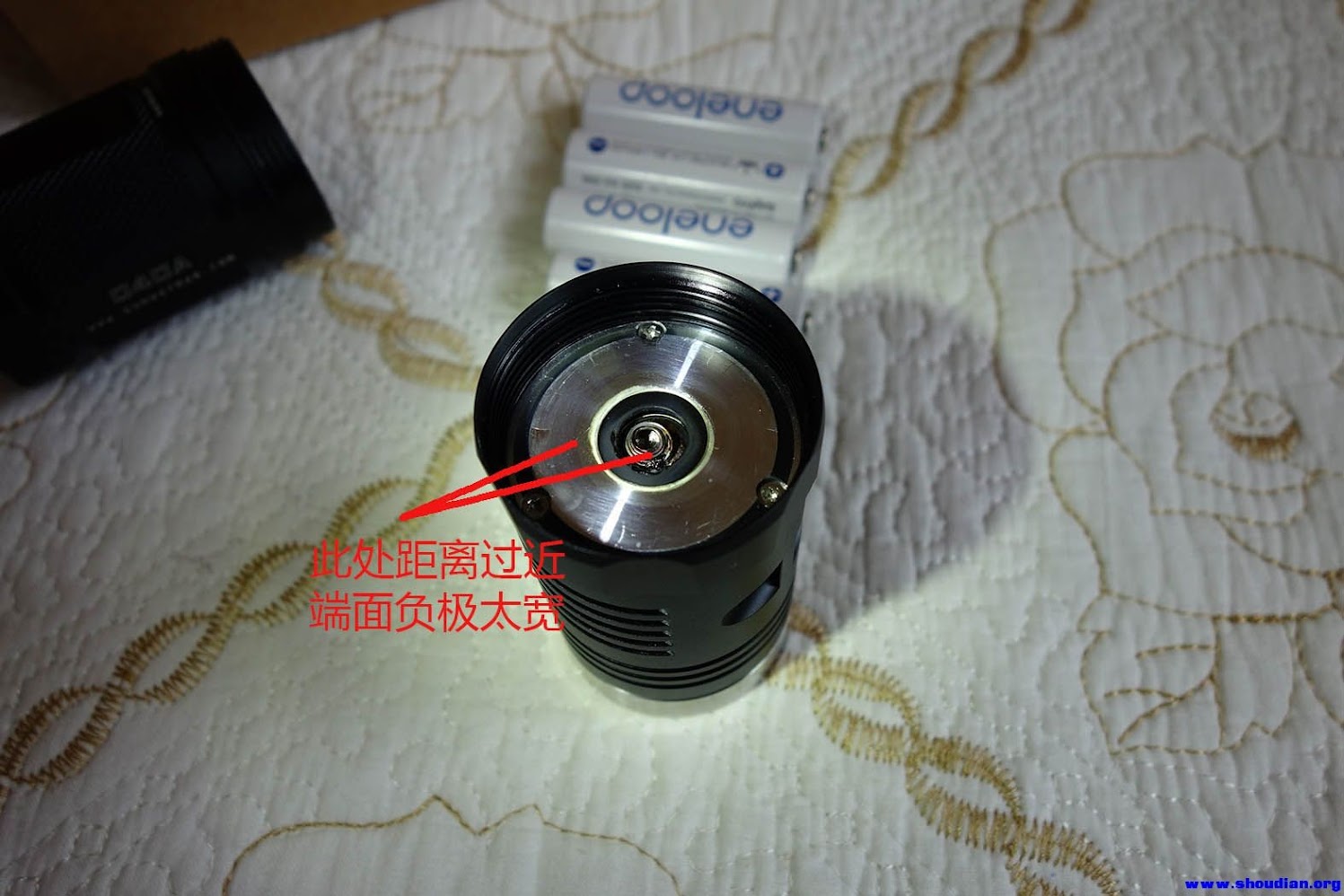

Someone just reported his D40A battery shorted. Check your D40A for any potential issue especially the insulator of the positive spring. As picture below shows, the spring and insulator were kind of melted due to very high heat.

Oh no!! The burn marks, and that was with eneloops too! :~

Has it shorted or was it a bad contact causing the damage?

DENGOH
DENGOH's picture
Offline
Last seen: 1 year 3 months ago
Joined: 10/06/2012 - 05:26
Posts: 2157
No one knows the reason yet, this torch is sent back to seller according to the original owner.
Owner mentioned he switched on the light and it was fine, then he played with it for a moment, and then it could not be switched on anymore. He thought batteries were emptied, and he put it aside his bed and went to sleep. When he woke up, he found it to be very very hot.
I am wondering can it be over tightened and crack the insulator. Just speculating at this moment.

I had been following the post in Shoudian forum. According to Sunwayman’s offifcial, the reason of the shorting seems to be the black isolator around the head’s positive contact came loose. and they checked their inventory and couldn’t find a second unit to have the same problem. The post had been deleted which I assumed was requested by Sunwayman’s official. So I have no way to know what is the outcome. But Sunwayman do respond in time and admitted that they will look into the design to avoid anything like that ever happen again. Kudus to Sunwayman!
