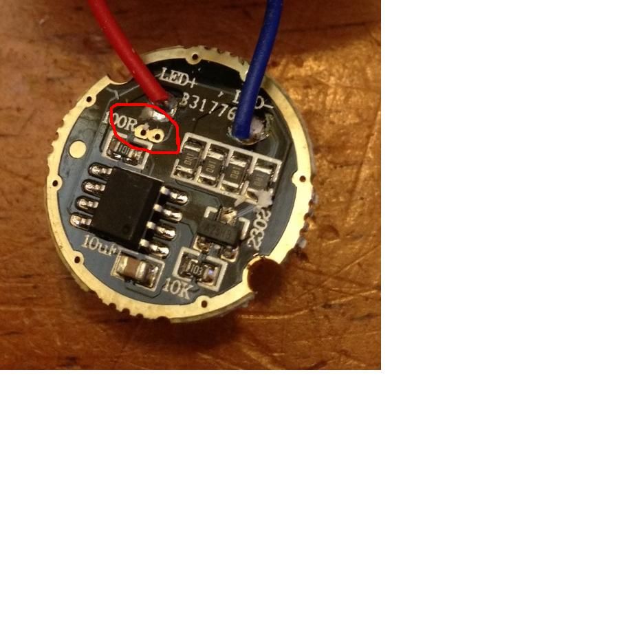

Pictures attached. Please suggest an emitter and driver upgrade for this host. As was stated, they are 20mm and I will be staying with 3D cells.

Does look very nice. Pill looks very good. I assume there is solid surface under the emitter star? (i.e. it's not hollow.). How about just an XM-L emitter swap if you're sticking to alkalines? If the driver has next-mode memory, the capacitor is easy enough to identify and put an appropriate resistor across.
I don't think a driver upgrade will do you much good for Alkaline use. It's probably already direct-drive on high which is what you want for max output on alkalines. Wait - can't be direct drive since Flo measured output above on a 26700 and still had about same current. Perhaps someone could speak up on how to jump resistors for direct drive output on high.

BTW this light may have a driver similiar to the DST. Remember that one! It too was limited on high but there was a simple move of the wire. First thing I would do is check for continuity from the spring to here. (from trace30 pic)
I agree with Dchomak. Definitely not direct drive stock. Even a sick Moli IMR26700 would have delivered much more current than 1.45A.

There is a solid surface under the emitter pad. Correct, it is a 2-mode High/Low driver. Can I go with an XM-L2 U2 on this? This is my first mod so sorry for the simple questions.
Also, there is continuity between the spring and the pad that was circled. What would moving the wire to this pad do?
If there is continuity and you moved the wire now going to L+ you should get direct drive. Because I have not yet picked one up, and this is your first mod, you should wait until I or someone else can confirm that this is a good thing to do.
Also, from what you have described it seems that it would be possible to merely change the LED to an XM-L2 U2 with no problems other than the driver may not be able to survive passing current to such a powerful LED.
If it is possible to convert to Direct Drive, the current driver would not be used, as is is being bypassed after the conversion. I doubt 3 D cells could drive enough current to cause any overheating of the LED and pill.
OK, I’ll stand by for some feedback on the direct drive option. If I do go direct drive, does that eliminate the high/low mode?
That was my concern, whether you'd lose the low mode by moving the emitter wire. Personally I'd prefer keeping low mode and raising high to direct drive (or at least higher than it is stock).

I agree, it would be better to try and keep the low if at all possible. The advantage of converting to direct drive is that it is simple, cheap (free) and reversible.

EDIT: Installing a XML2 should not put any stress on the driver. The XML2 will have a similar Vf. The driver is limiting the current to the LED, not the other way around.
