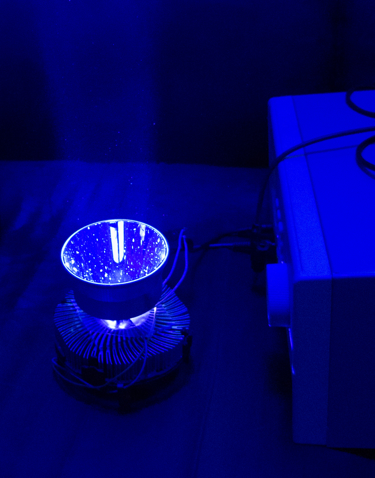

Blue converted Nichia 219C
The "easiest" LED I've ever dedomed. Just pry the lens and almost the whole phosphor removed. No heat, no gasoline, no wait time, no gold wires, etc.... Happened accidentally when the optics damaged the lens. I almost throw it but then decided to clean it and the result was unexpected. The blue lights looks like a 390nm UV and glows almost all UV reactive material though with plenty of visible purple.

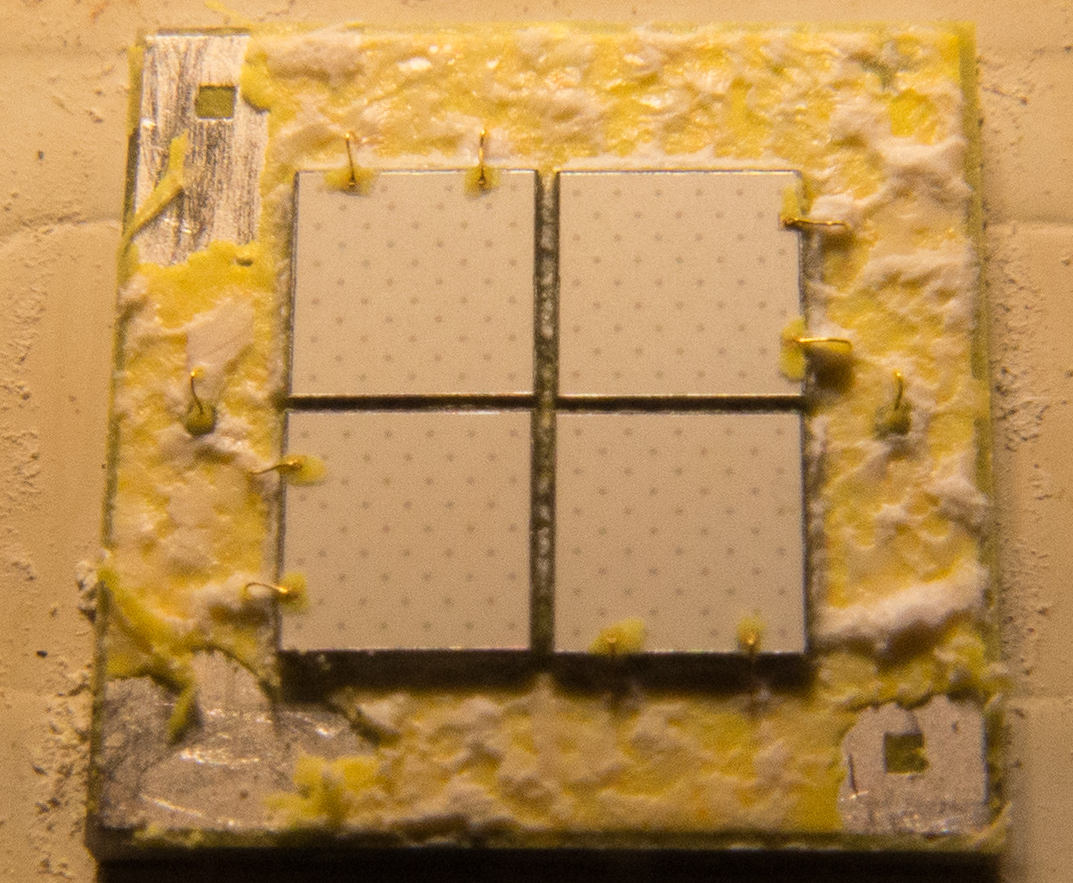

Note the beautiful Aluminum Nitride substrate

Wicked cool. Is this considered UV light that will do damage to the naked eye?
I don’t know scientifically. But one thing for sure, this blue/purple light definitely strain my eyes. Though not as severe as the cheap fly trap lights. Very useful to find small LED dropped on my workshop floor. Just turn off the light and light it up, your LED will glow.

FYI, to De-everything this Nichia is as easy as tooth brushing with gasoline. No need to worry about wires, etc…

Ther bond wires are not helpful when trying to get the phosphor off

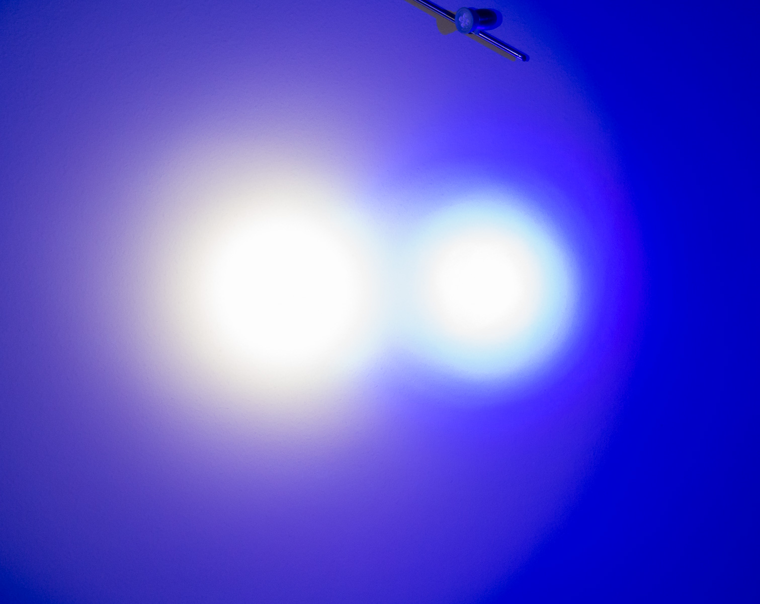

compared to 1100 Lumen NW flashlight
