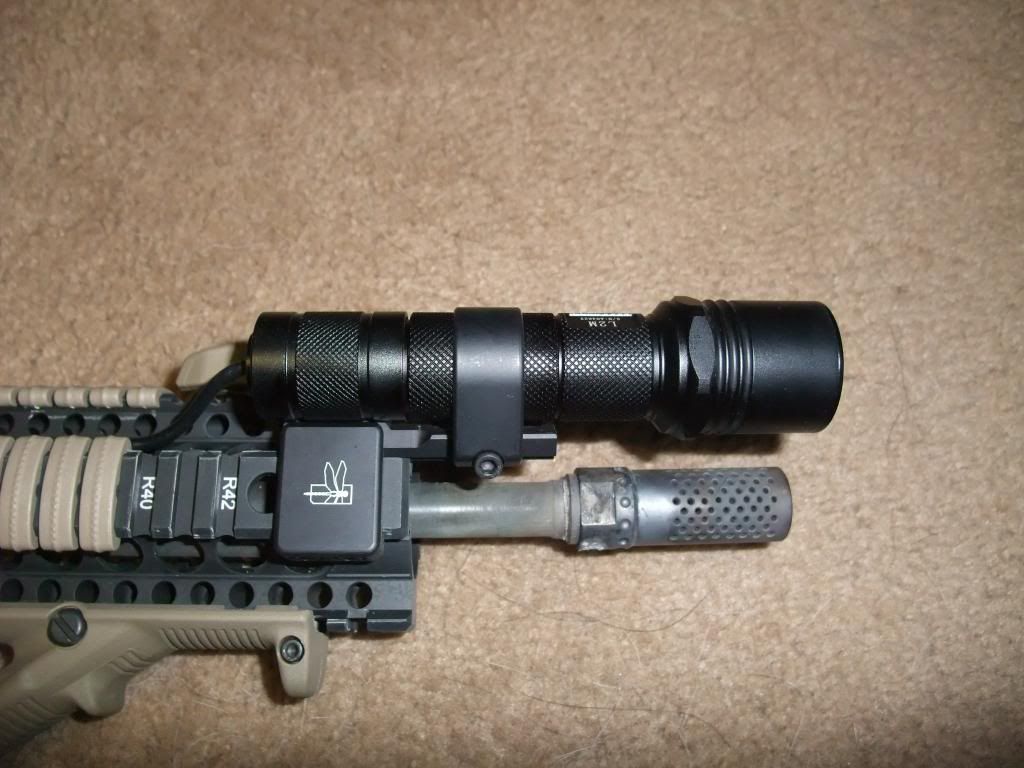

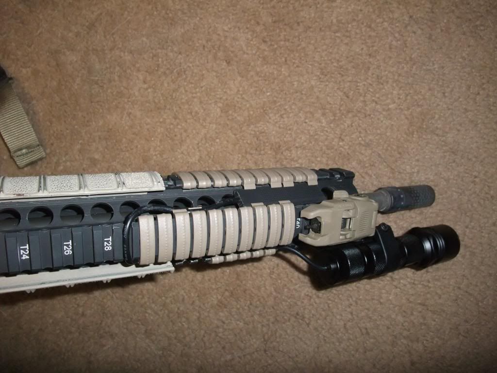

Here is a little update. I got the two mounts in. Here they are together. I think I will go with the one that keeps the light tighter to the gun. Less likely to snag on stuff.
The downside is that it’s a hair too close to the rail to clear the front sight, unless I have it on a slight angle which I’d rather not, because it will throw the beam off target at longer distances. Consequently there is a cut out in the beam pattern. Annoying now but perhaps it wouldn’t matter in the heat of the moment?
Here it is on its own.
That is a nice mount. I love mine, and it sure looks more professional than a scope ring :stuck_out_tongue:

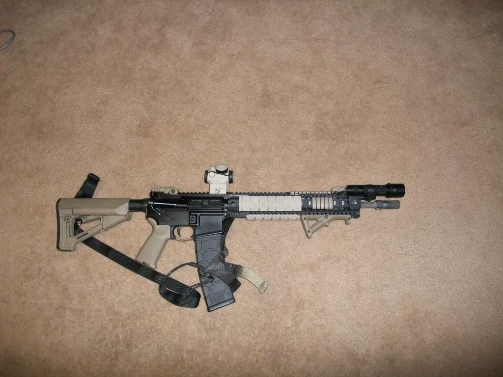

Here is how my 2.2A XP-G2 L2m is mounted. Tape switch is used for a high thumb grip.
