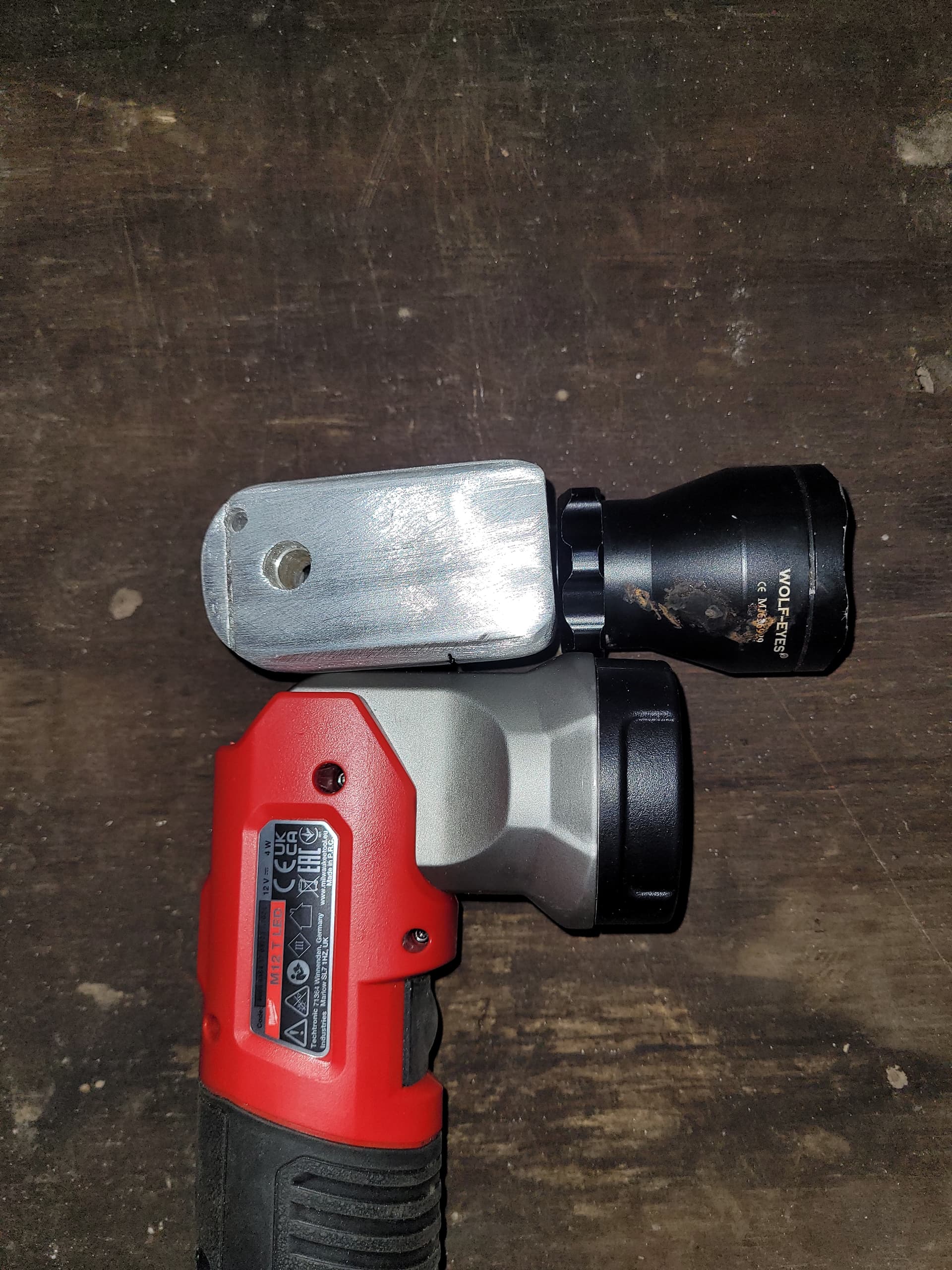

Here we go. That should make it make sense
Obviously ill be ditching the m12 lamp assembly…and might make it an inch shorter yet
Looks like ill need a 25mm led board and 15mm driver, although i guess the driver doesnt have to be fitted into the pill anymore
Nice work.
KaiDomain has a bunch of 3 cell / 12V input drivers. 1 mode, 3 mode, 5 mode, etc. The driver you choose should suit the LED you choose, or vice versa. Do you want high CRI or maximum output or maximum throw?
Or you could use that driver and fit a voltage regulator to reduce the 12V down to the Wolf Eye Seal battery voltage.

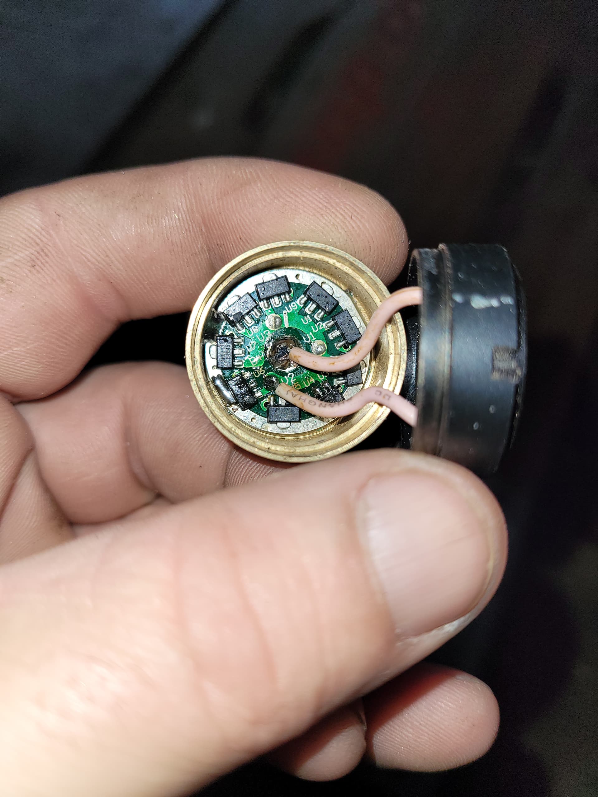

What is fitted in it stock?
You could put a SFT40 5000k in it. Drive it at 6 Amps (or 8 Amps for maximum output.) Drivers will be easy to find as they’re a 3V LED and a common LED. You’ll need to make sure the LED / head has good heatsinking.
Do you know what diameter the current driver is? Kaidomain or AliExpress (Convoy store) would be two places to look for parts.
