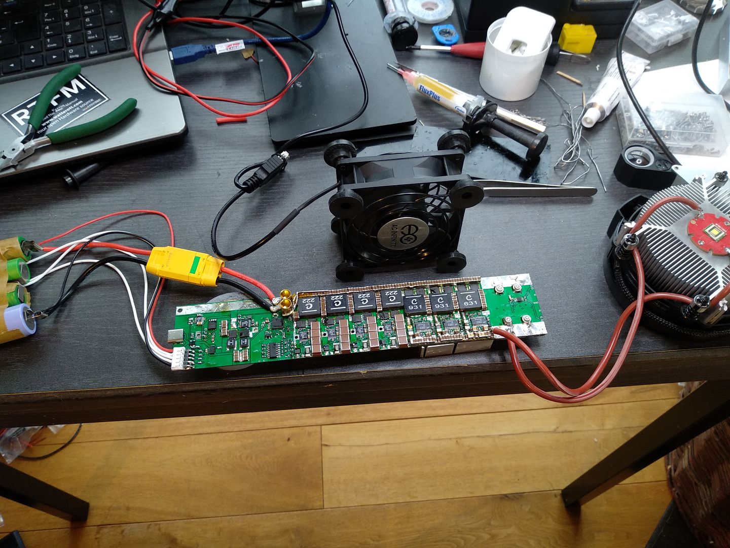

- 3x buck regulator to drive SBT90.2 at 38A and 4x 33A
- 4x boost regulator to drive each 4x XHP50/70 at up to 12A

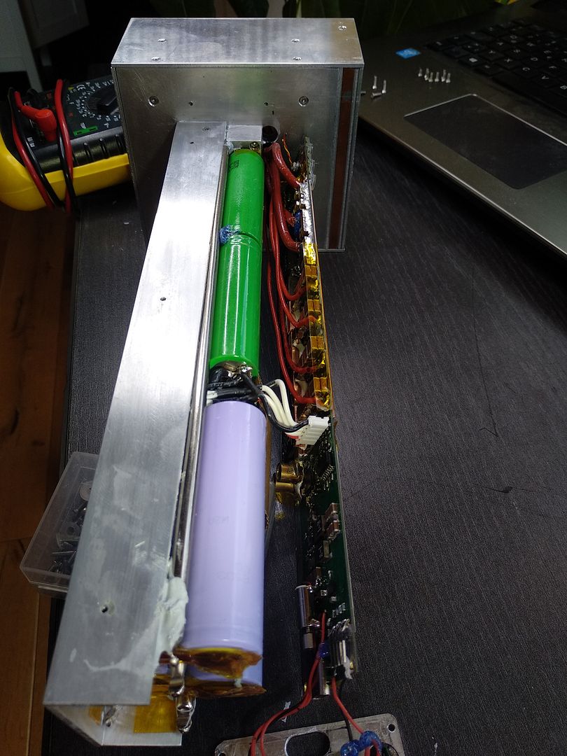

- 150Wh battery
- 8x 21700 INR21700-40T
- 4x 18650 US18650VTC5A

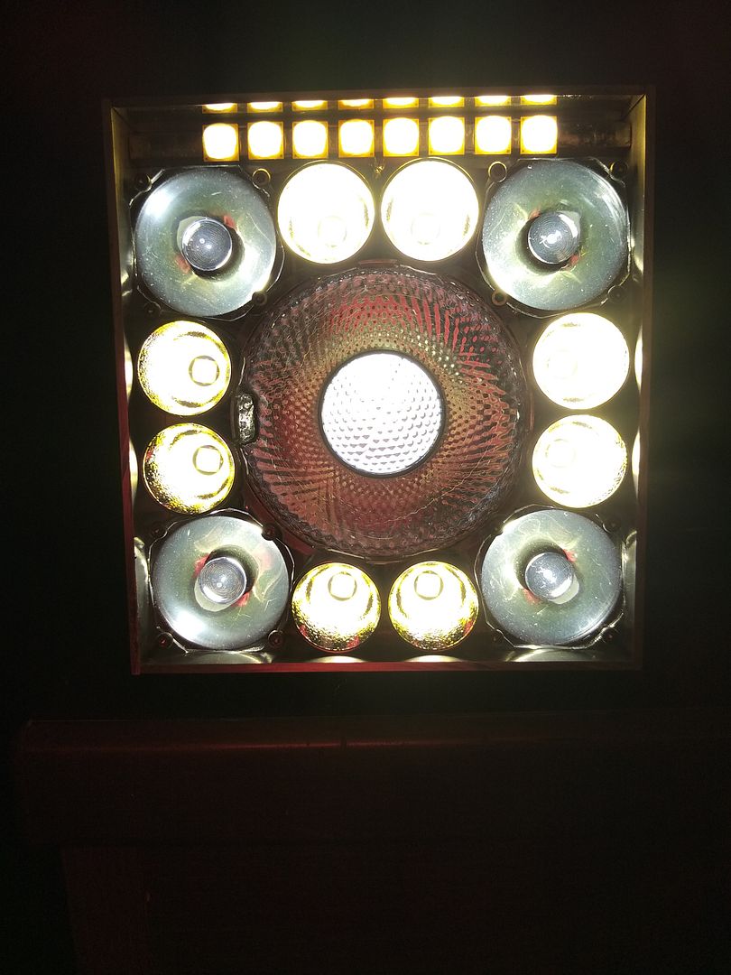

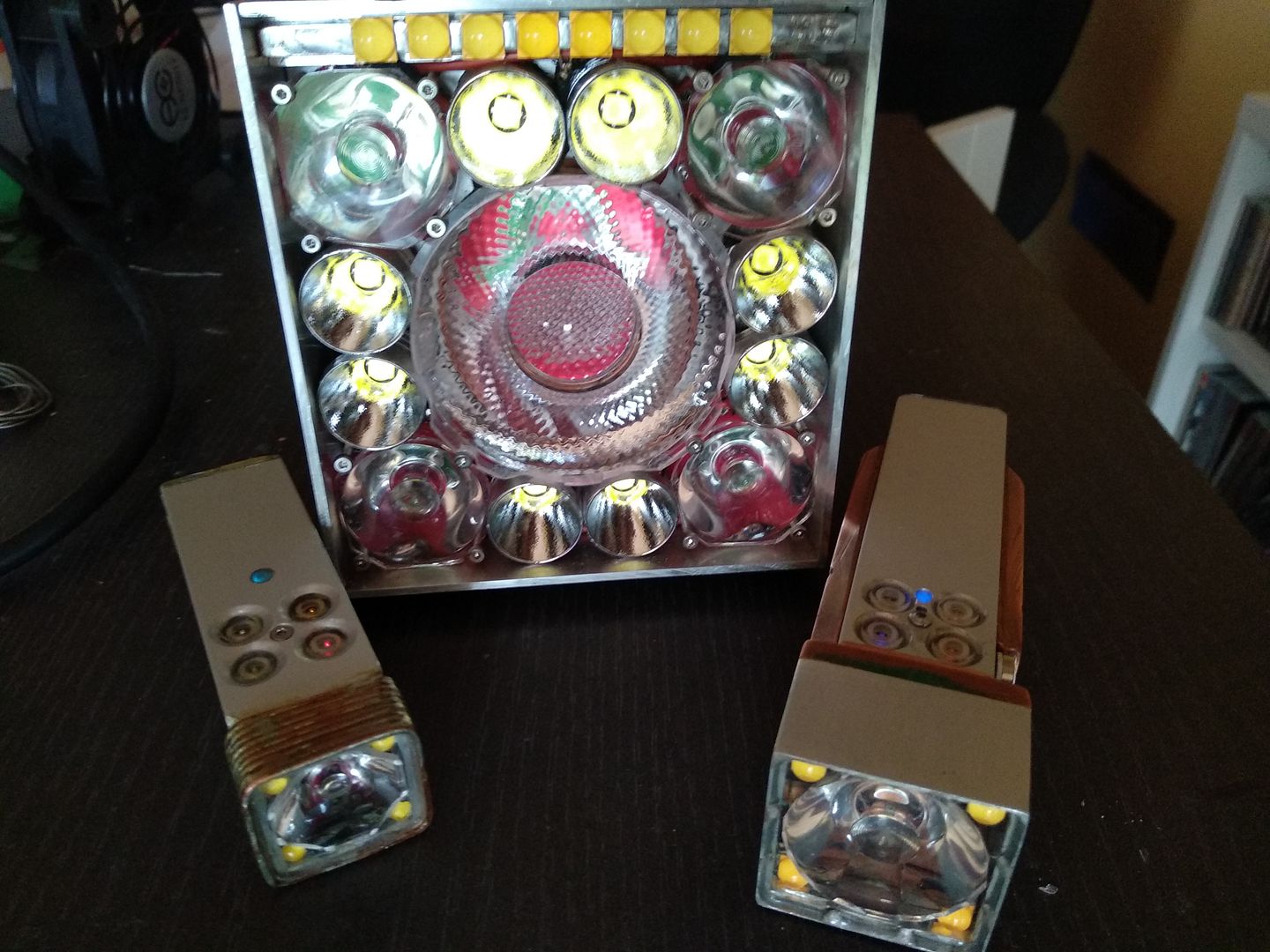

View on the front, protective window still missing (will be delivered mid April)
Here the ALL_ON button was pressed, adjusting all channels to ~75% power
Bringup stage of development process:

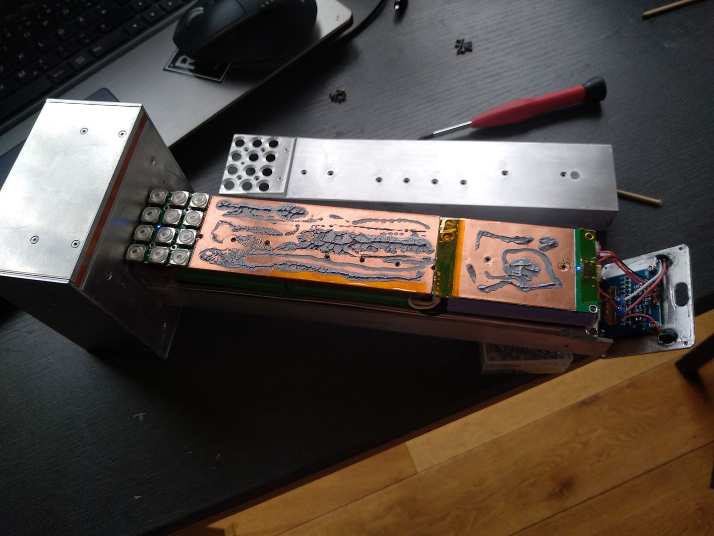

Heat of DC/DC converters is conducted through PCB to backside of PCB
many, many threaded holes had to be made....combiantion of alu and copper to keep weight manageble

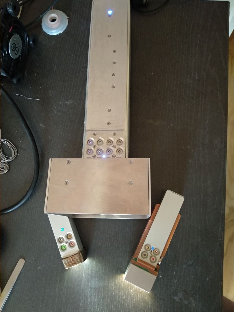

Size comparison to the light I built before (the samller has 18650 cell, 4x XPL2 for flood and XHP35+20mm TIR spot, 6000Lumen peak, 35kCd; the larger 21700 cell, 4x XHP50.2 flood, XHP35+30mm TIR spot, 12000Lumen peak, 76kCd):
