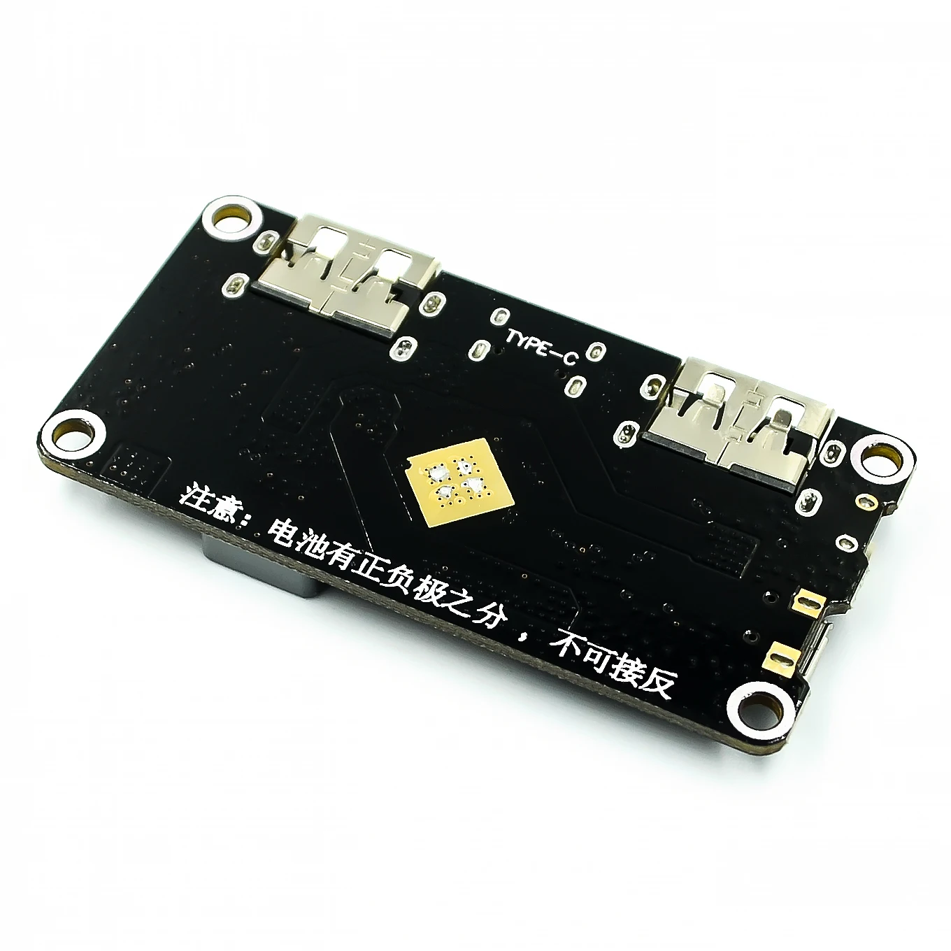

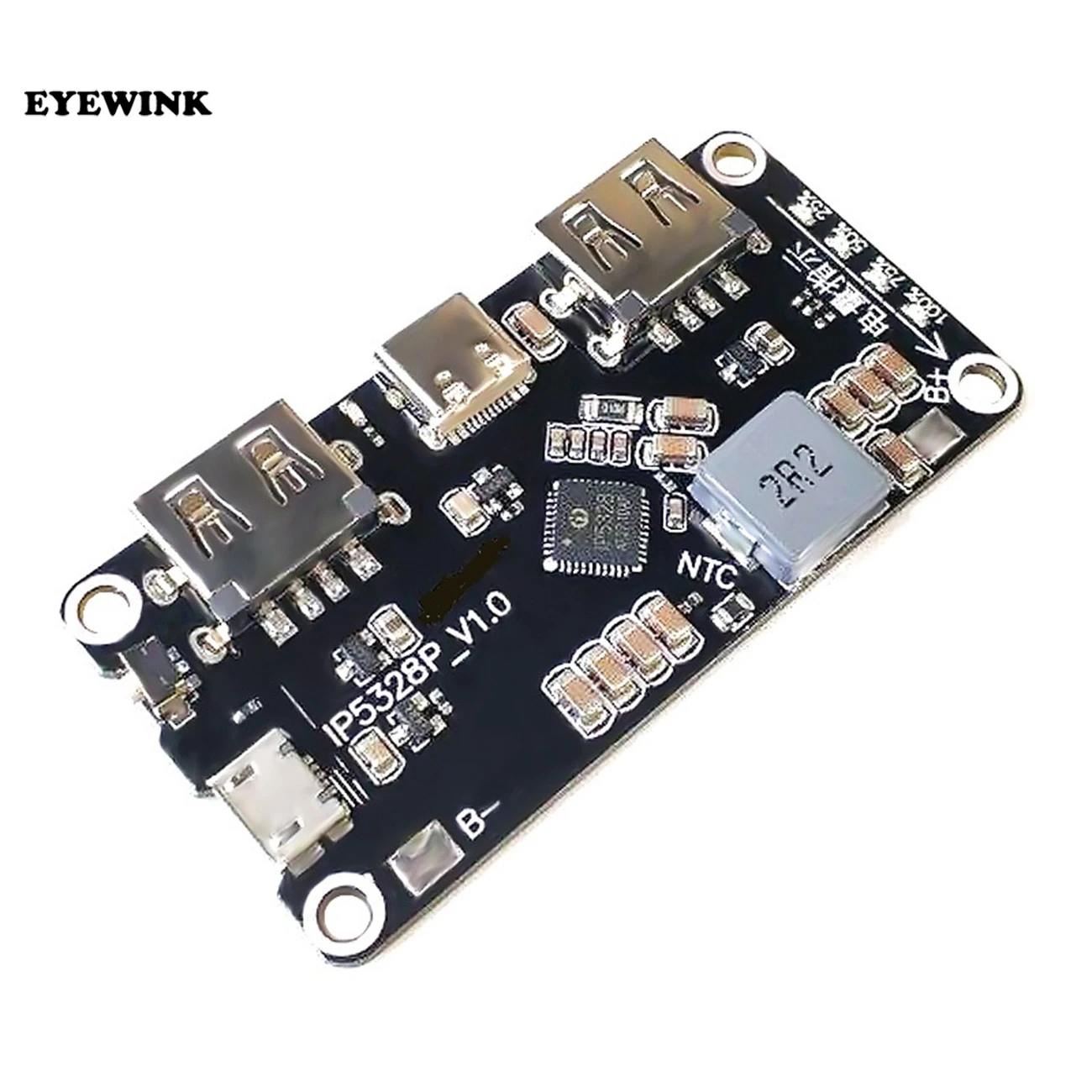

Here's a good looking DIY board solution, Injoinic IP5328P based:
With two boards you will be able to deliver 5A. According to datasheet a single one goes up to 3.1A. Two boards also allow battery charging and discharging at the same time.
If the above doesn't sounds enticing, the solution is BMS plus boost converter to discharge, and some specific buck converter (or power bank board LoL) to charge.
As BMS boards I would choose a couple of the above running in parallel (one would suffice, but I like extra reliability, less heat and a tiny little bit extra efficiency). For sale, for example, here and there.

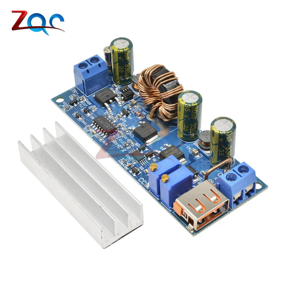

Check the boost converter board at ZQC Module and ModuleLive stores.

Of course not! The boost converter is meant to provide the output, nothing else. That is presuming you are going 1S6P, that's why I chose such boost converter which can work with a rather low voltage (down to 2V), so its efficiency at close to 3V and up should be nice.
