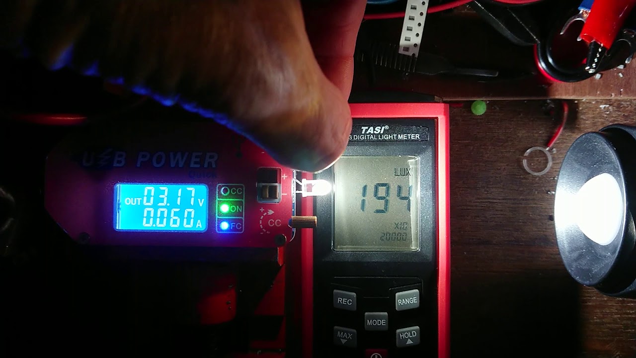

The light output. I made no graph (not enough time) but a video. You see the led shining at a luxmeter that I placed at a precise distance so that the luxmeter reading is quite exact 10 times the output in lumen. So a reading of 93 corresponds to 9.3 lumen total output. The voltage and current can be read from the USB power supply. I checked, they are not greatly off from reality.
So, like the 3400K led, it maxes out at about 120mA (25 lumen), but above 80mA (22 lumen) there is not very much gain. This is a very nice performance, at a bit but not much better than the Yuji 5600K led.
Conclusion: great led again! Well done.
