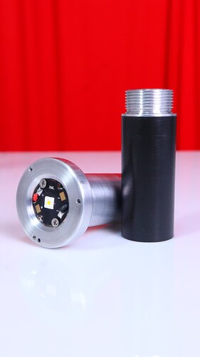

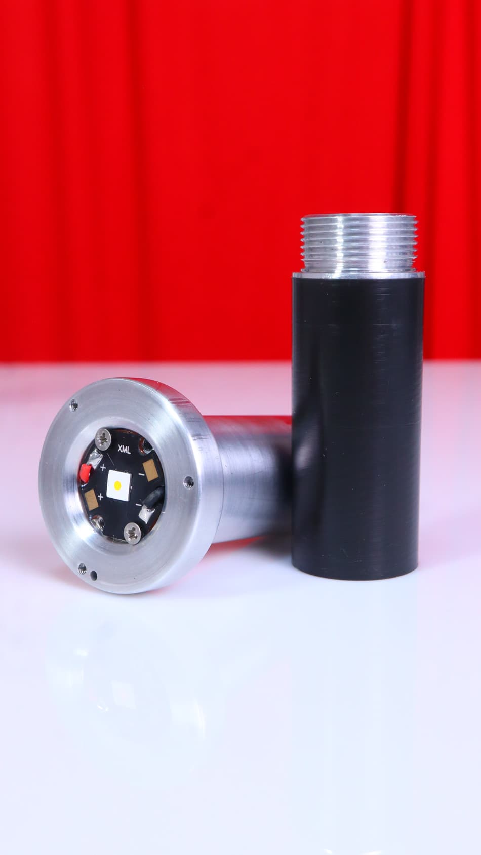

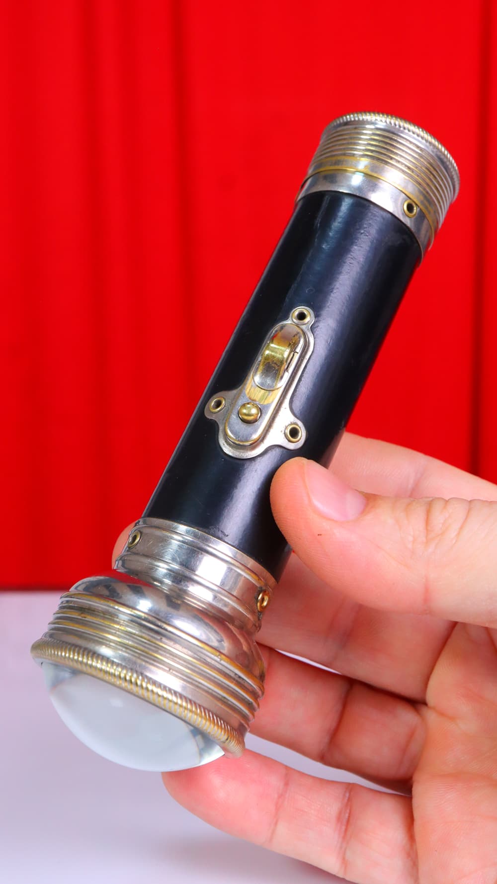

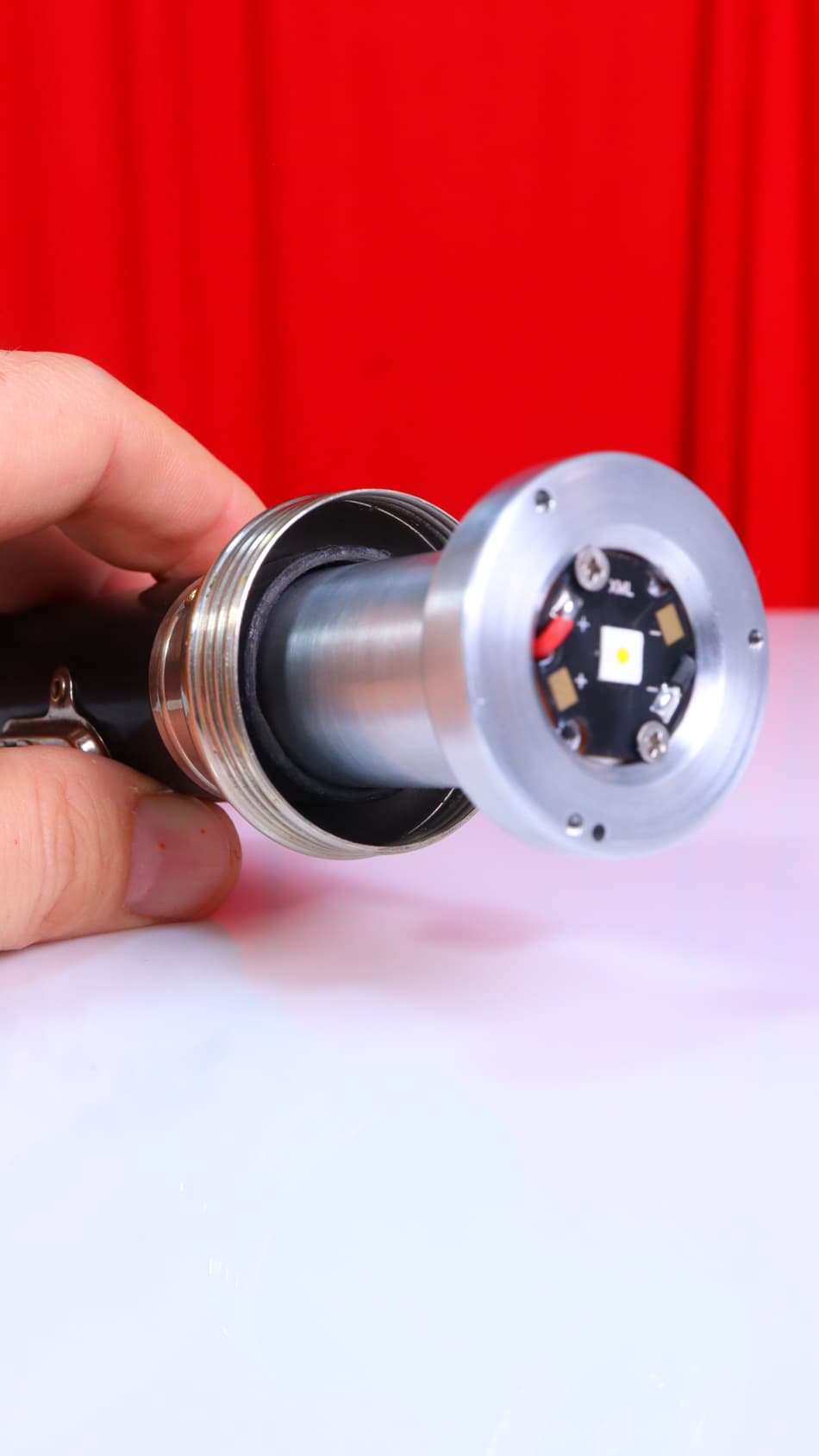

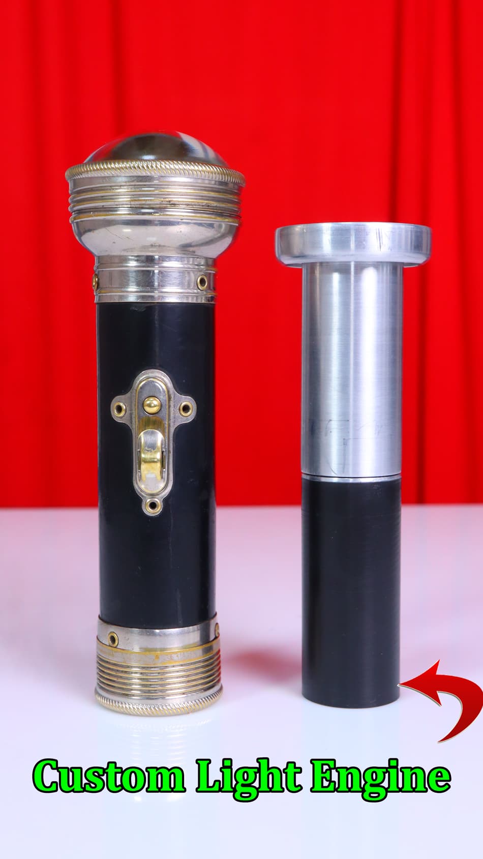

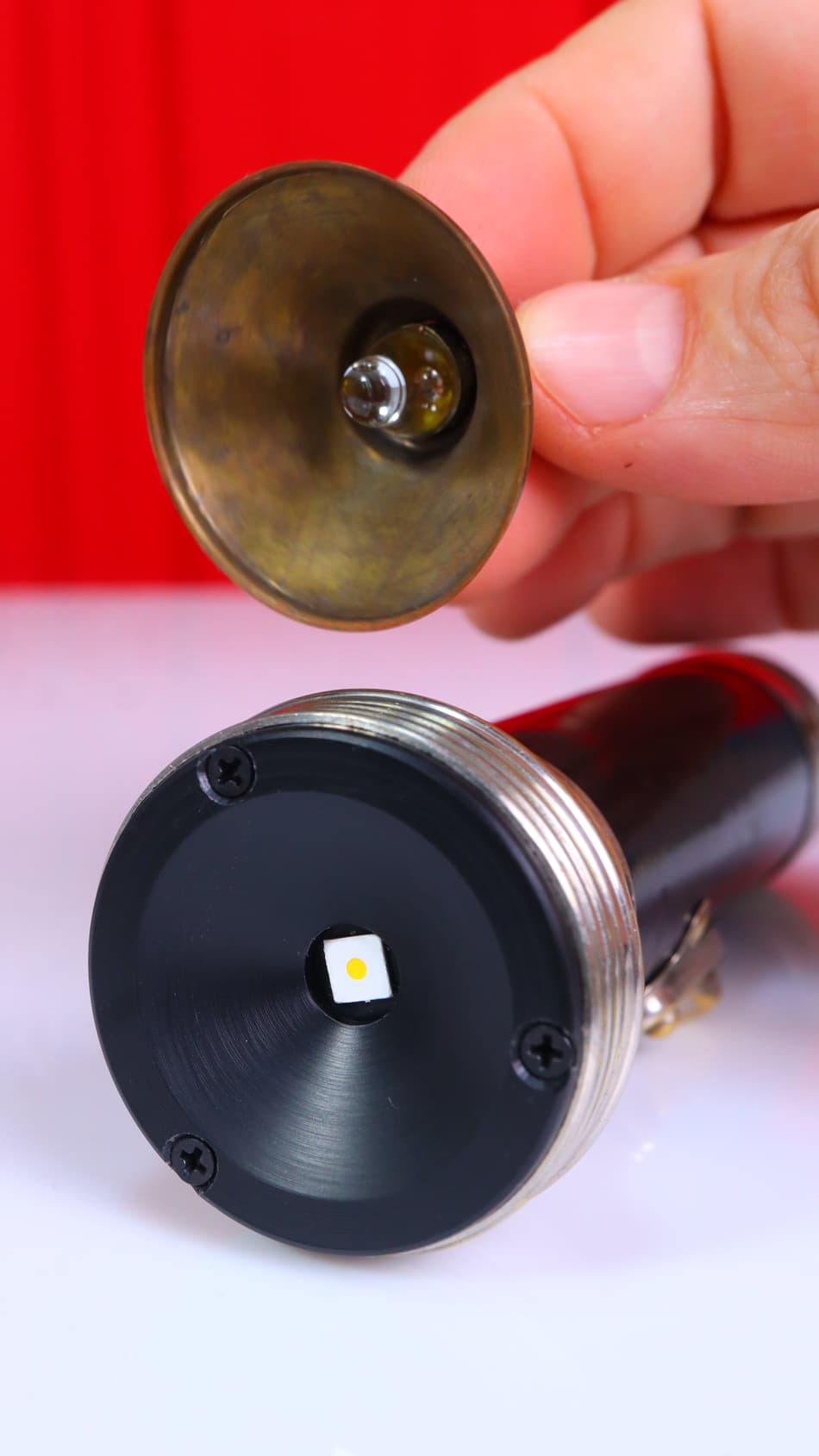

I’ve had this beautiful light for many years. It’s one of my all time favorites, and wanted to make it a useful tool, and antique sleeper. I made a light engine for it in such a way that noting on the original host had to be altered. So the integrity of this beautiful antique is still preserved.
This video is part of a 3 month long series (Old School Cool) that is now premiering on my Youtube channel. Hope you all enjoy it!

Incredible work and expertise. You even managed to add the fantastic zoom mechanism. For me, that you preserve this much of the host’s form and function is the key to this absolutely amazing mod.
Would love to hear your thought process on the choice of LED. LMP 5050SQ3 vs a high CRI LED like 519a for example. Because 5050SQ3 has better throw?

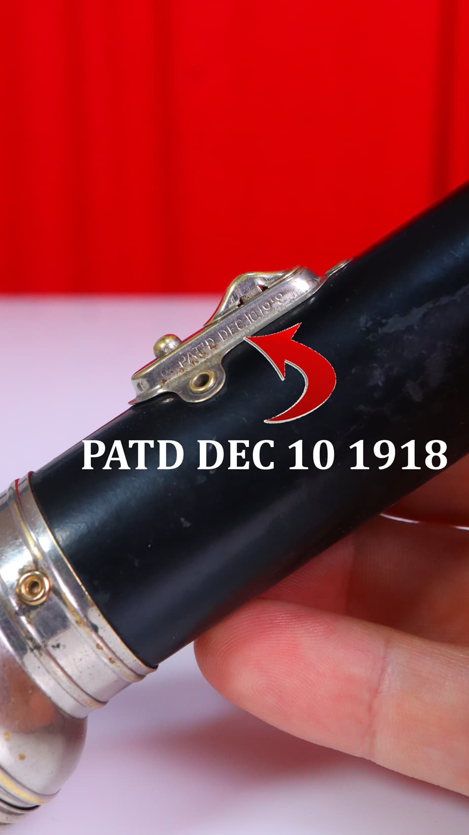

Video at 14:00: “What if someone makes a flashlight that’s exactly like this…”
My answer is yes, as long as you keep the “1918” inscription. :slightly_smiling_face: :+1:

The reasons I went with the LMP is mostly because its a round die LED vs square. I really like the way a round die looks at full focus. I used to love the square because of the novelty of it. Seeing peoples reactions, but I feel like a lot of flashaholics are kinda “over that”. Being domeless was also a factor as you said to increase throw.

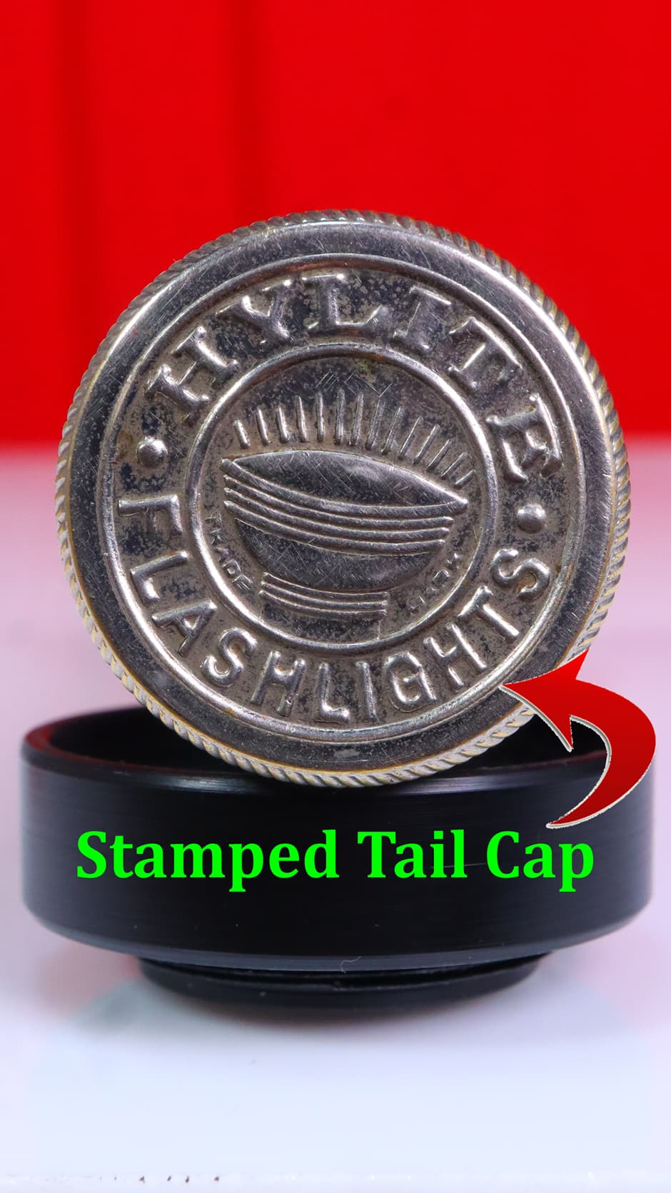

What I plan to do if there is interest is hammer out the details of what people want it to look and feel like here at BLF. Figure out how to make a copy of that switch without use of stamped metals, and what the black outside of the light should be (originally bakalite I think) et. Then I would run a Kickstarter to see if pricing and demand is in line with expectations.
