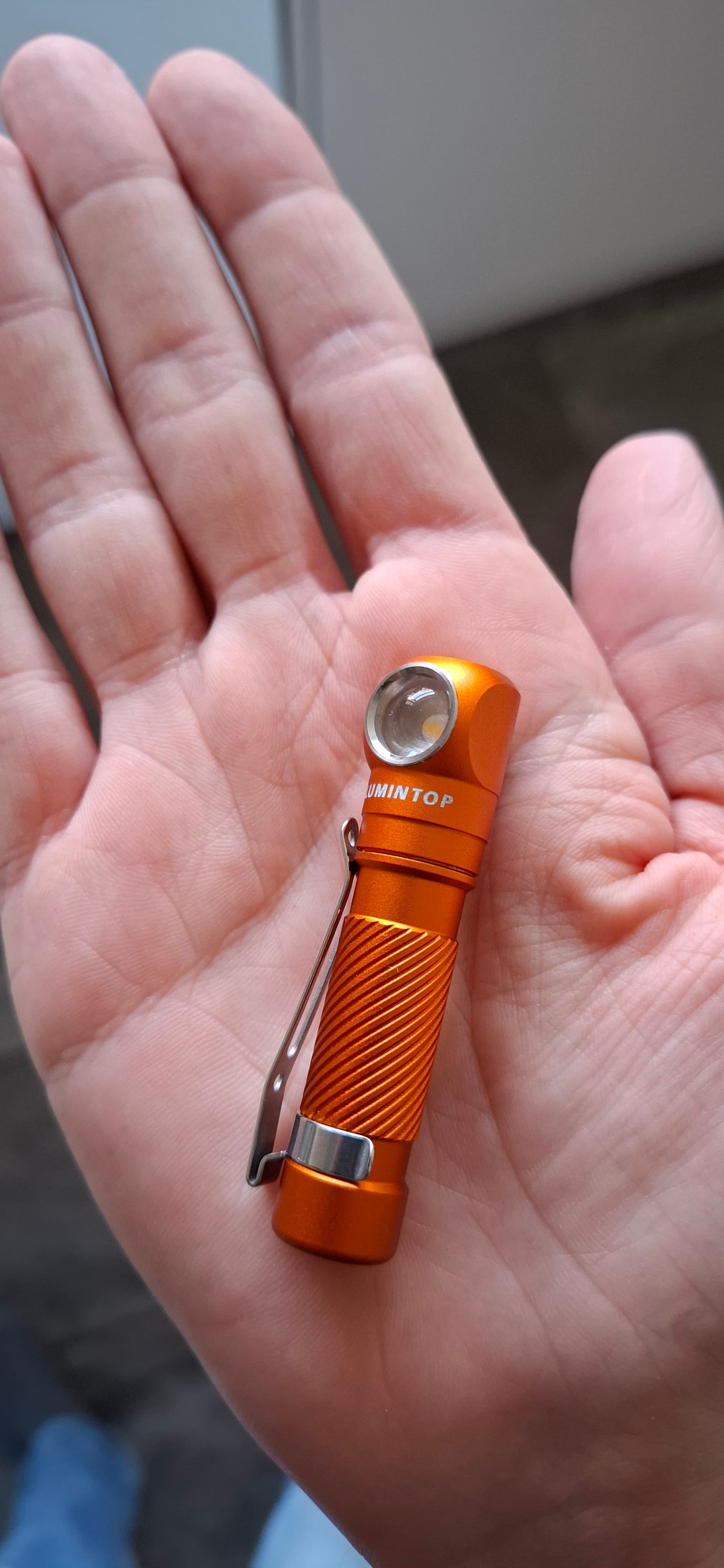

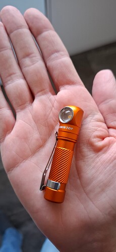

It’s tiny! I ordered some AAA pocket clip at the same time from the lumintop website, fits like a dream and doesn’t interfere with the twist. With the pocket clip in place, I can change modes one-handed.

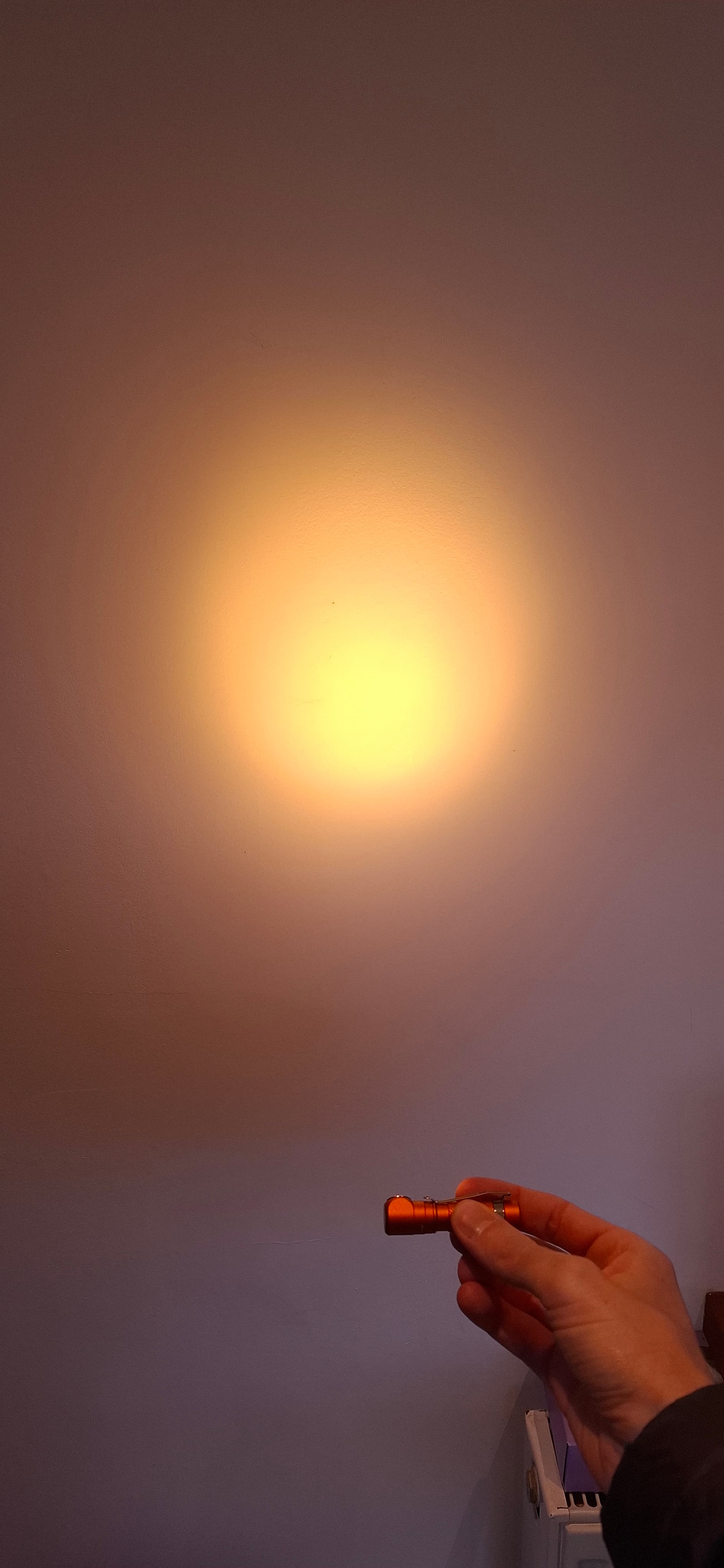

Beam is ugly, there’s significant tint shift that I couldn’t capture in the photo, the Corona is yellow but the center is pinkish.
WB locked 5000k

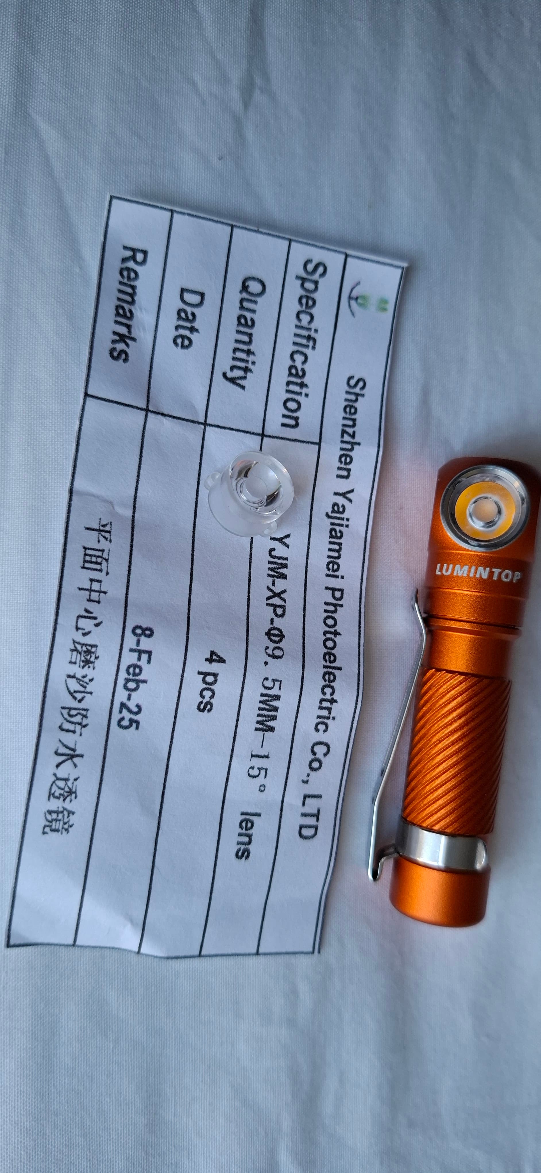

Not 5 minutes out of the box and I’ve modded it.
I think ebastler mentioned these TIR lenses (or at least the company). I trimmed the “legs” with sharp electronics snips, pulled out the silicone glow thing, installed the TIR and put the stainless retaining ring back on.
It must be noted that there’s no o ring under the bezel so I’m not sure how waterproof these things are.

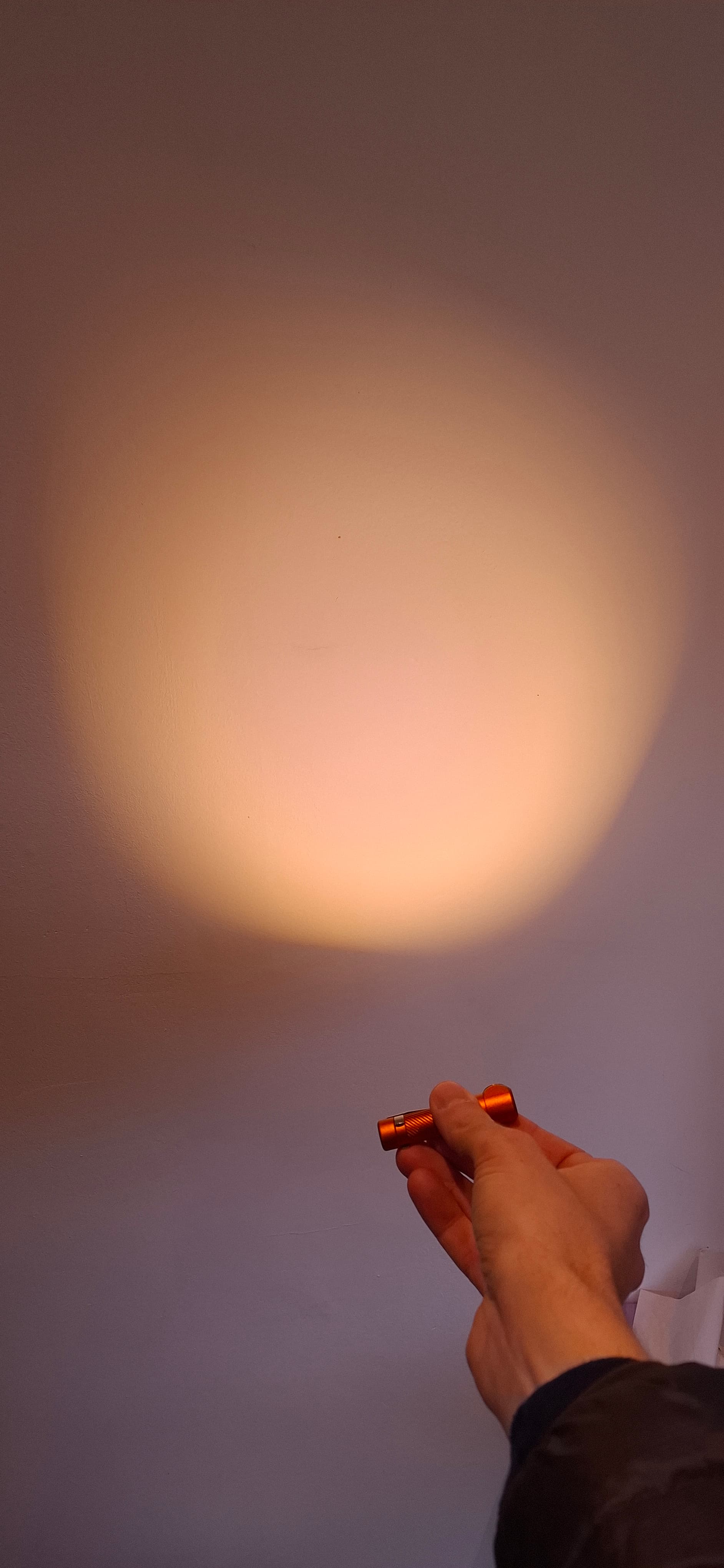

Beam is 3000K but significantly nicer than the photo suggests. Visually, I see very little ringyness

The stock optic looks like almost a throwback to the OG Zebralight with Cree XR-E.
