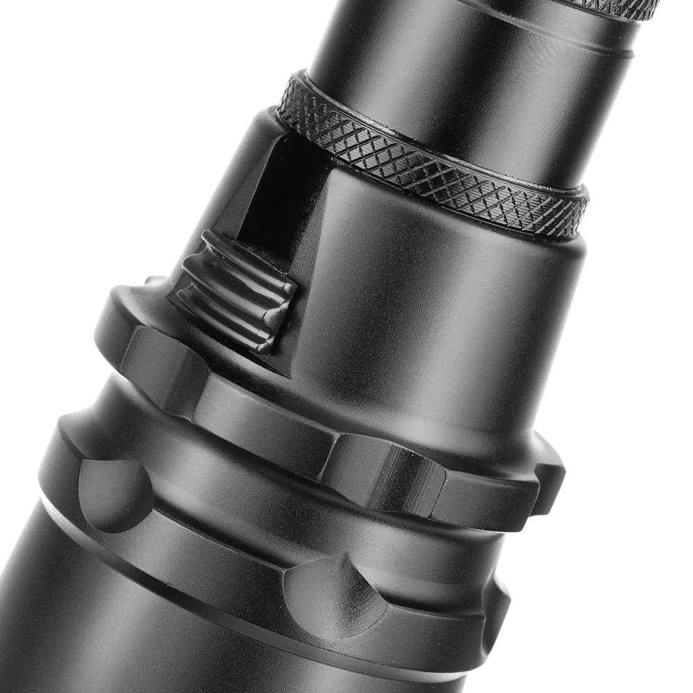

Sofirn is already familiar with magnetic slide switch
(above: Sofirn MS11)
Magswitches usually have about 10mA parasitic current, though. And probably need a fairly higher voltage (closer to 5V than 3V, let alone 2.whatever when under load).
You can probably put 2 pb switches under 1 boot to make it look/feel like a rocker switch, but a (nonmagnetic) waterproof slider might be hard to come by (read: I haven’t ever seen any).
