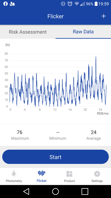

I can see the flicker on one of my Jetbeam Rotaries, when I stare at the LED reflected in the reflector, when set to 0.1 lumens, here is the Opple data
I can also see the flicker at 0.01 lumens, (no Opple data)
