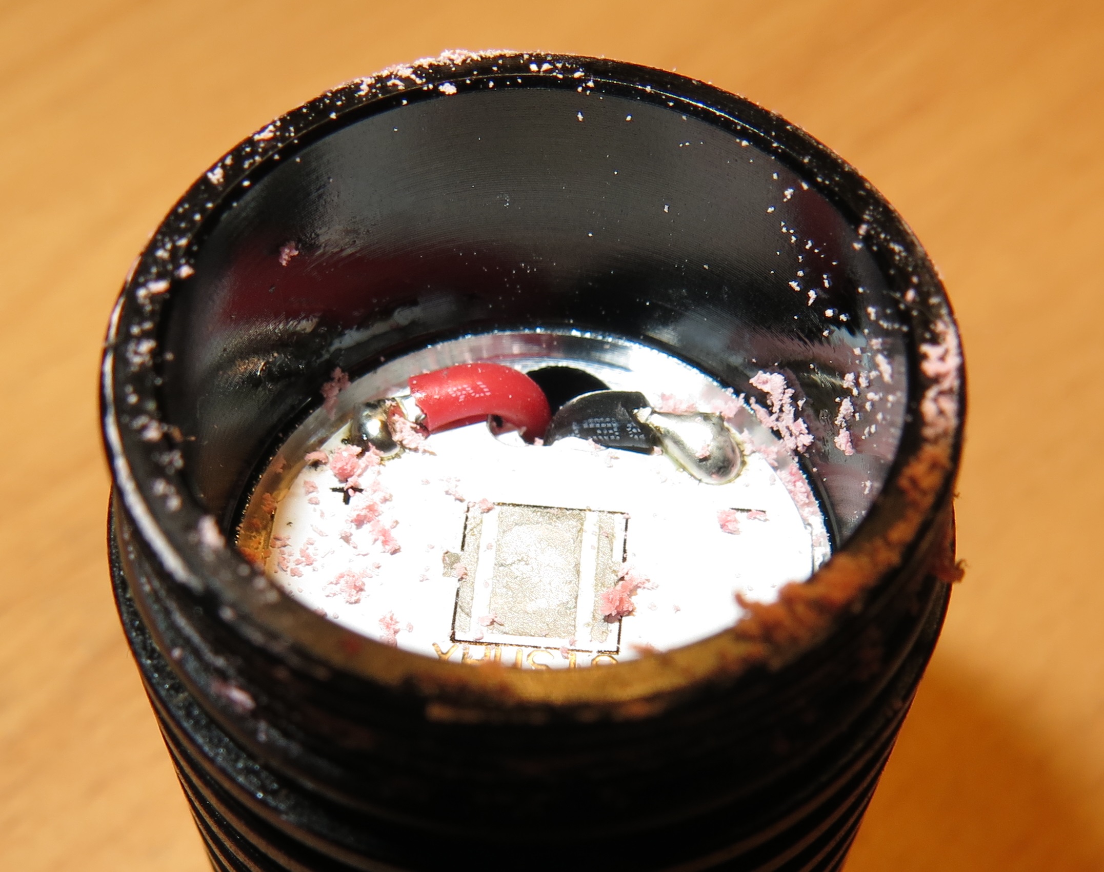

I managed to open my Nitecore P12
I used a burner to heat the Bezel to about 200-250°C it started a bit to smoke after 25 seconds
The force was a lot lower than I failed on Temperatures around 100°C
As I had nothing to wrap it at 250°C I used my pliers without any rubber and scratched some more of the anodisation off
Pictures of the inside following and I will order me a new XML2 when the light did not took damage by heating it so much
First thing I noticed I unsoldered the LED by heating it or it ripped of the Contacts from the board as the head came of with the LED ans centering ring

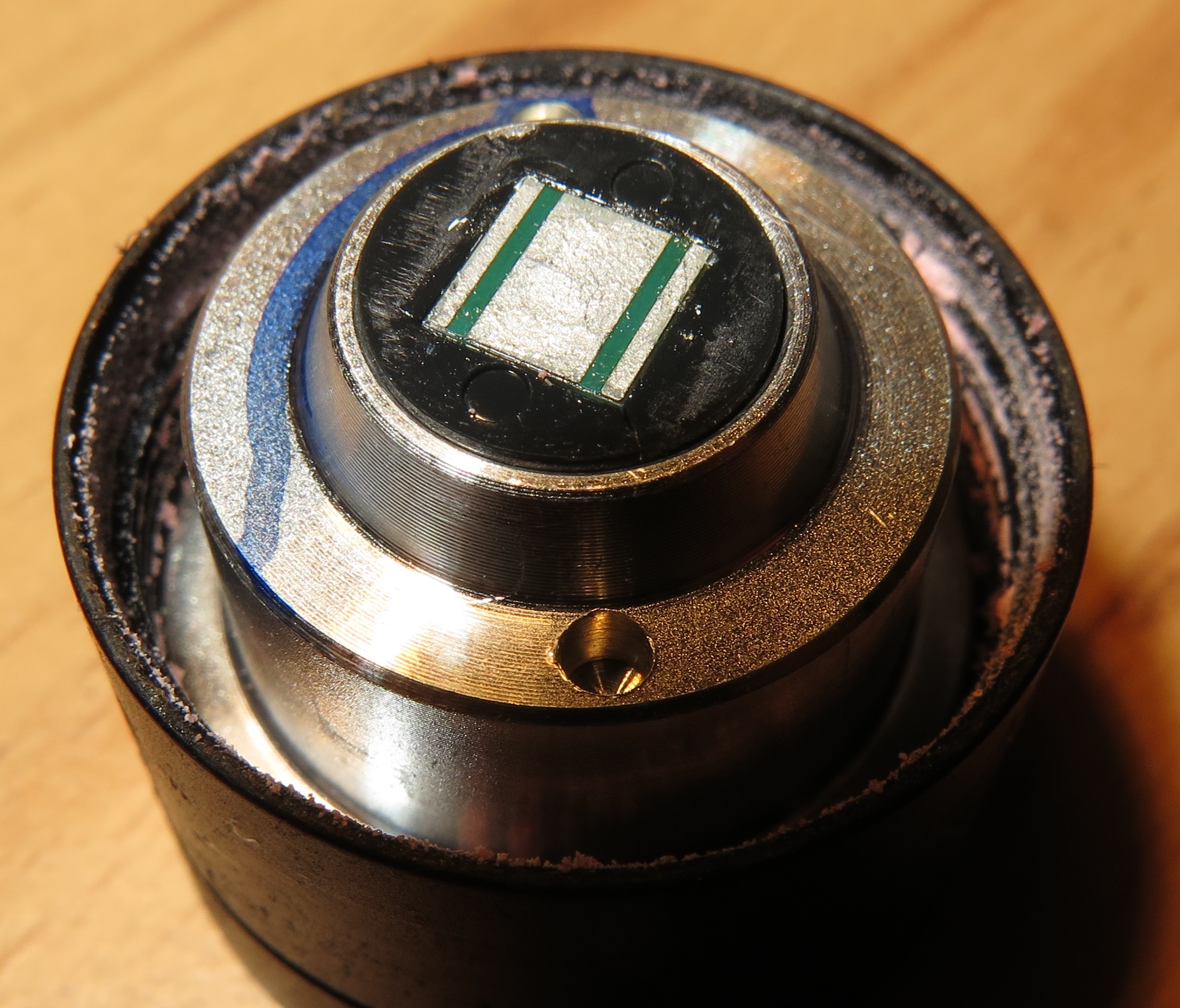

The reflector is screwed inside the head

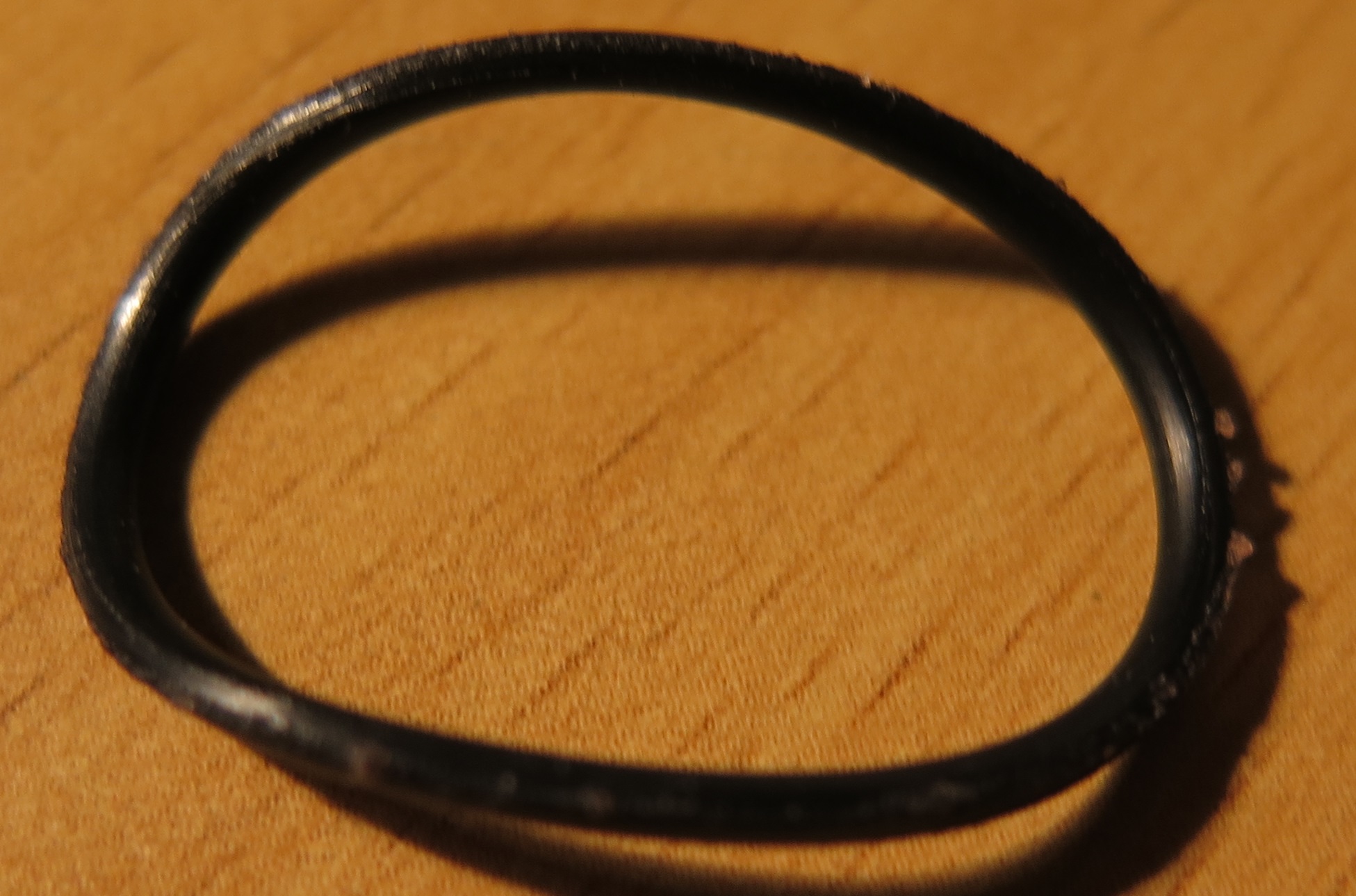

The o-ring ist toast
Aluminium board
That’s a LOT of Red Loctite! Nice job getting it apart!
Why do they have to lock it so tight?

They offer a good warranty, they can do this by keeping us out. If we bugger it up trying to get in, warranty voided. So it’s a win win for them, either keeping us out or tossing the warranty altogether.

the thin aluminium board is a bit disappointing as there is also directly behind the center of the host a 4mm hole drilled
I ordered a XM-L2 U3-3D LED on nogtigon MCPCB, but too bad I cant get a current boost,
but thankfully I get probably about 15% more lumens and a nice 5000K NW beam
