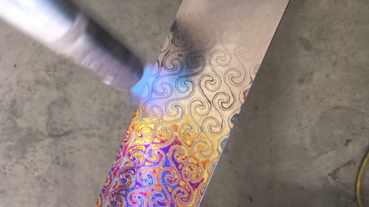

Haw do you get that coloured pattern on the body?
The body is mokuti :star:
I googled it and came up with many pretty examples but i am curious how you get a pattern on the light.
Think of it as titanium damascus- different grades of titanium forged together to make a billet.
After machining it can be coloured via 2 different methods. I use the flame method
